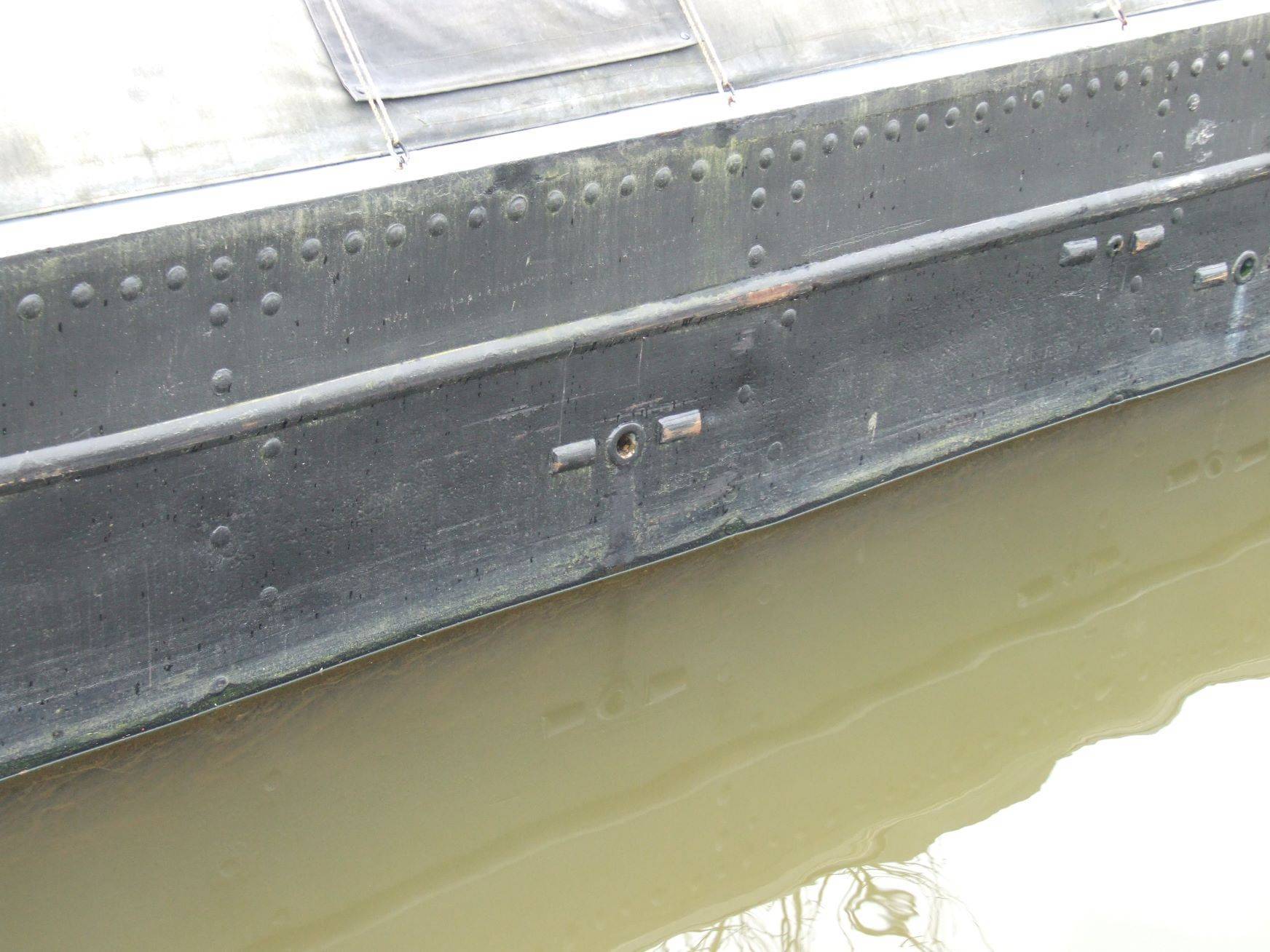

ditchcrawler Posted March 24, 2024 Report Posted March 24, 2024 2 hours ago, blackrose said: If the fitting is sheared off in a lock or on a wall as Ditchcrawler describes, then a hole may be left in the side of the hull only a few inches above the waterline which the owner may be unaware of. In my case I went found it with sealant when I found it but it was the good coating of Sprayfoam om the inside that held it and kept things watertight

ditchcrawler Posted April 4, 2024 Report Posted April 4, 2024 On 23/03/2024 at 22:38, ditchcrawler said: I have had two shear off when they have caught protruding steel work, Saw this today and like the idea. 4
