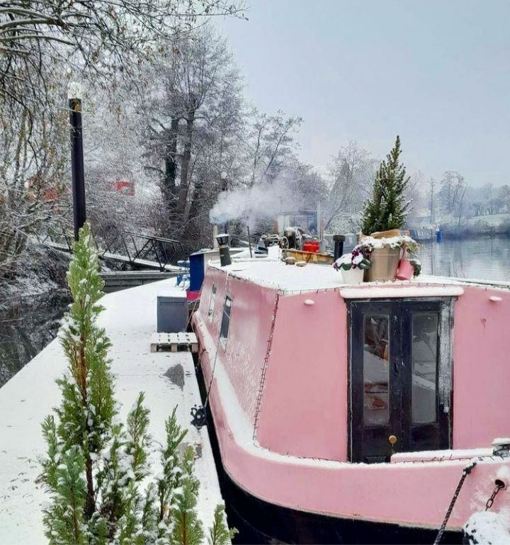

2 minutes ago, Jen-in-Wellies said:
It also has a white roof and gunwales that day, so will be particularly cool inside. Which is why the stove is lit.
I always find with a thick layer of snow on the roof the boat is noticeably warmer than without. I am thinking of trying it in the summer months to see if it has the opposite effect.
Me too. A quick on-line trawl suggests fresh snow has a lot of air trapped between the flakes, so works very well as insulation. Also, reflects a lot of light from the surface too.
