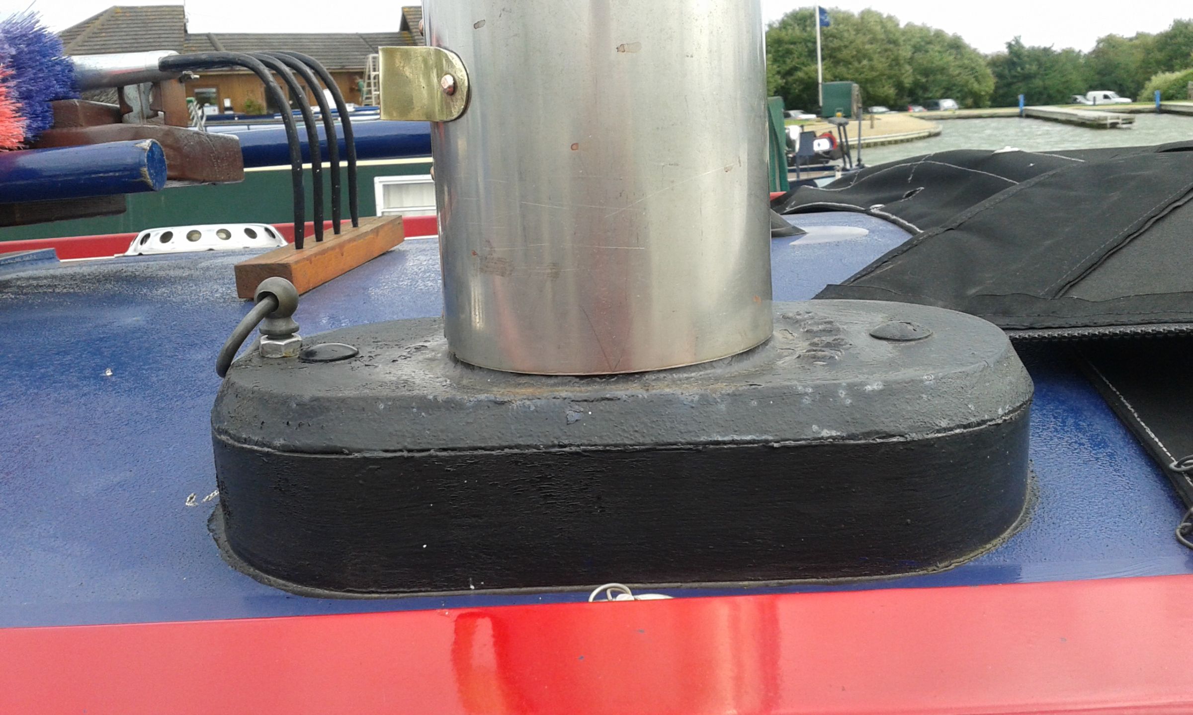

rusty69 Posted November 24, 2022 Report Posted November 24, 2022 Are you referring to the roof collar? I'm pretty sure out one has a hardwood tapered wedge beneath the cast iron collar. 1

Slim Posted November 24, 2022 Report Posted November 24, 2022 I made my own wedge from Mahogany òver 20 years ago. The chimney sat vertically as it does to this day. The seal between the wredge and the roof failed a couple of years ago (no surprise). There's a topic running elsewhere on the subject. When I went to reseal it I found significant rust but absolutely no rot of the wedge. I made it out two pieces ģlued together using a combination of bandsaw, sawbench, router and Elastoplasts⚕️

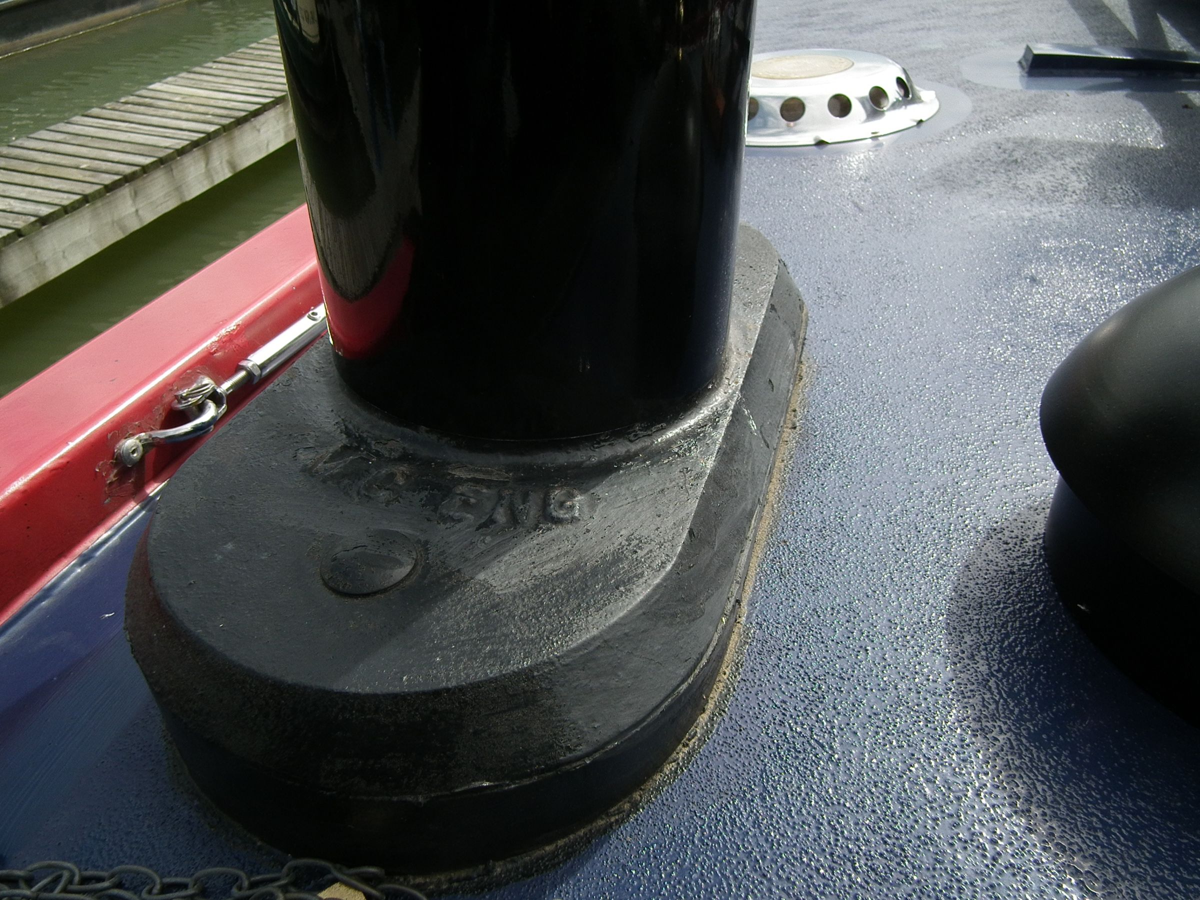

dmr Posted November 24, 2022 Report Posted November 24, 2022 There is, or was, a tiny little company called Warstock in Southam. They made the common rudder bearing and also various chimney collars, but I think they mostly provided engineering support to Colecraft so are likely a word of mouth rather than website type company. A few years ago they made a chimney collar "wedge" for me in aluminium. They did not have one in stock so cast one the next day and delivered it to the boat, I think it was still warm 😀. They also charged a ludicrously small amount for this service so have probably gone bankrupt. The wedge is still doing a fine job. They did an initial visit to the boat as we were fairly close to them, he made no measurement, he just looked at the chimney collar and roof and said "I know what you need".

MtB Posted November 24, 2022 Report Posted November 24, 2022 1 hour ago, dmr said: There is, or was, a tiny little company called Warstock in Southam. They made the common rudder bearing and also various chimney collars, but I think they mostly provided engineering support to Colecraft so are likely a word of mouth rather than website type company. A few years ago they made a chimney collar "wedge" for me in aluminium. They did not have one in stock so cast one the next day and delivered it to the boat, I think it was still warm 😀. They also charged a ludicrously small amount for this service so have probably gone bankrupt. The wedge is still doing a fine job. They did an initial visit to the boat as we were fairly close to them, he made no measurement, he just looked at the chimney collar and roof and said "I know what you need". Warstock seconded by me. Very knowledgable and clever bod who rarely if ever answers the phone. You HAVE to visit and say hello and explain in person what you need doing. He is absolutely bound to still be in business somewhere somehow, but like DMR I thought him too cheap so I worry that Warstock the company might have evaporated by now. He is down a track the roughly opposite side of the road to the entrance to Colecraft.
