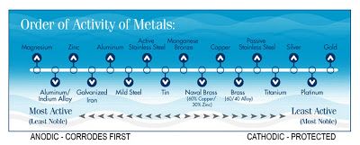

It may be interesting to potential Alumininium boat owners that Aluminium is actually used as an anode for 'brackish' waters (typically in estuaries or tidal rivers where fresh and salt water mix).
Aluminium alloy is even further down the Galvanic scale than pure Aluminium, so if there is a problem with Galvanic corrosion the hull will be 'eaten' away before your steel shaft or bronze / brass prop are affected.
As has been said, maximum protection is of the absolute importance to an Aluminium / Aluminium alloy boat.
If you have an outboard or outdrive with an Aluminium prop, make sure you never moor up and share an electrical supply with a steel boat, or a boat with a bronze prop.
