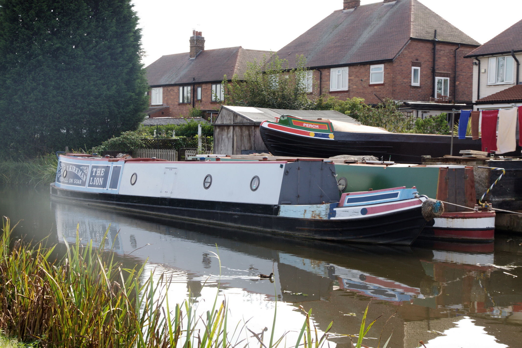

ditchcrawler Posted January 17, 2021 Report Posted January 17, 2021 Schools have used Narrowboats as classrooms. Lifting over the house is possible if you can afford it This is a school in Rugeley

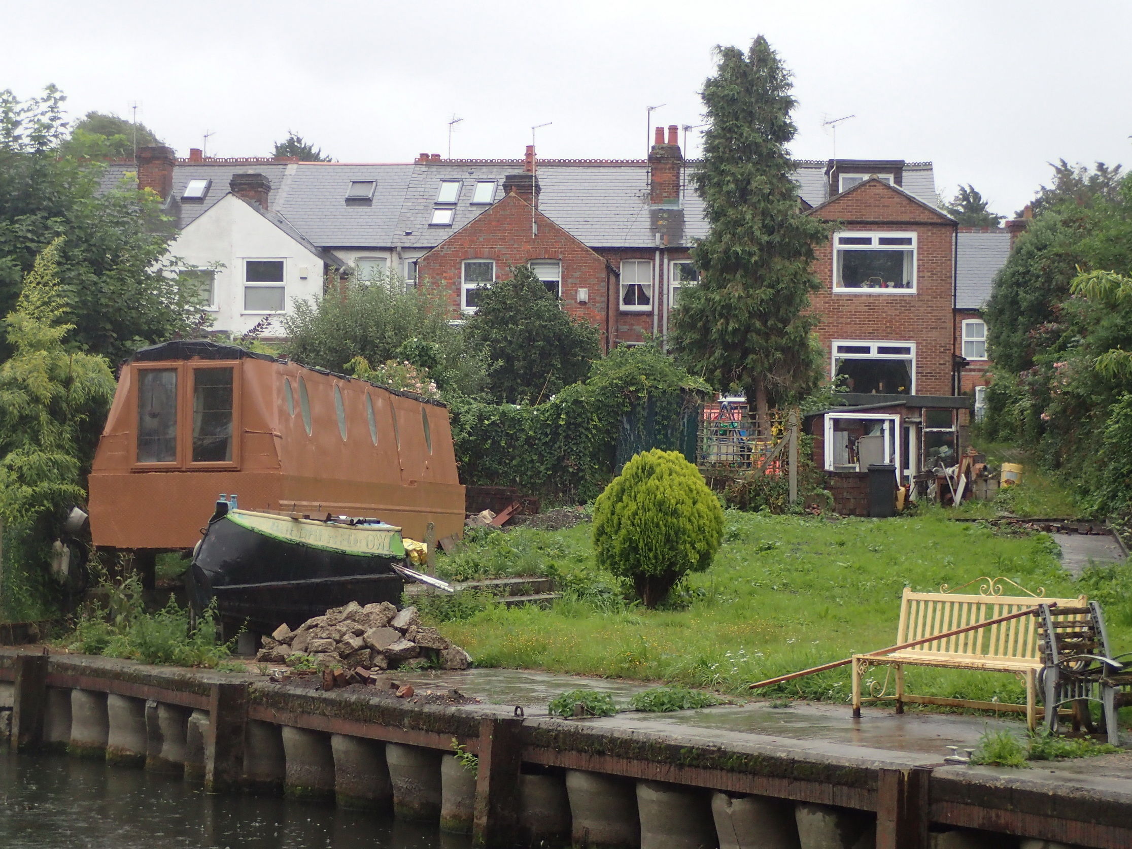

Tim Lewis Posted January 18, 2021 Report Posted January 18, 2021 13 hours ago, Mike8811 said: Hello everyone, possibly a bit of a strange one but I’m guessing people here would be able to answer some questions on wether my idea is silly or is possible. I was planning on building an office in the garden for my partner, as she works from home, when I’ve had the idea of finding a damaged narrow boat and converting that into her home office, we have a very long and narrow garden and I thought it would be a bit different and nice than a fancy shed. So my questions are where would be best to look for a boat to buy? I essentially just want the structure, it doesn’t matter what the state of it is inside and obviously it doesn’t need to be in a condition where it can become worthy of going on water again. my next question is if I can find a boat like this, how easy and how expensive would it be to have it transported by road? And possibly the craziest question would be getting it into the garden... I have a large alleyway at the side of my house but how would I move a boat like that on dry land? Or (don’t laugh if I’m talking nonsense) would it be possible to have it craned over my house? i know the whole thing may be a crazy idea but I figured people here could advise me on wether it possible or bury the whole idea! thank you in advance, mike. By the River Kennet at Reading ?
MartinW Posted January 18, 2021 Report Posted January 18, 2021 Remember that most of the boats you see will be a steel shell which has similar issues to a shipping container when you are looking to live in it. I reckon that a good yard could actually build something from scratch which looked like a NB but was actually more practical to fit out as habitable office space. think of it as a metal house extension, like the hospitality units used on building sites as they have solar and drains and so-on. It does sound like a very fun-filled project, it certainly got me thinking.
Tim Lewis Posted January 18, 2021 Report Posted January 18, 2021 15 minutes ago, Tim Lewis said: By the River Kennet at Reading ? Or if you are into historic boats ?
