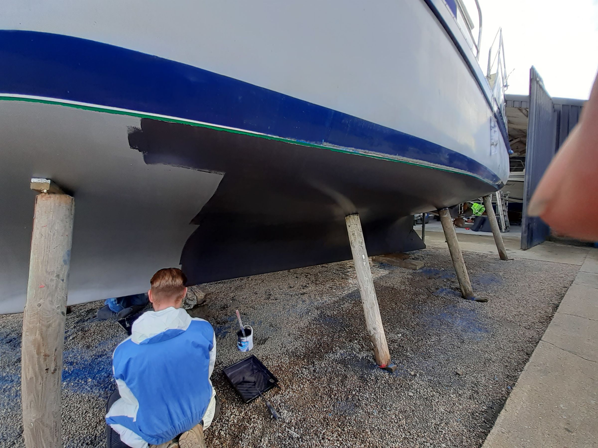

That picture is posed! Look at the bloke, not a mark on him, last time I painted the boat I had to bath in white spirit and burn all my clothes.
