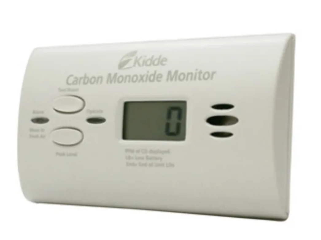

I dont want to be alarmist but....I've just had a bit of a shock.
The glass on our stove has been getting a bit (lot) black so decided today to try and clean it. Usually this is easy when cold but the stove has been on for weeks so needed to do it hot. The fire was at the low end of its heat (first thing in the morning) and I opened the door wide. No smoke, looked like it was burning clean. Spent about 10 mins scraping the window, emptied the ash but didnt immediately put the ash can out the front (like I normally do - because of CO)  and banked the fire up and shut the door.
I happened to glance at the CO monitor and it was showing 174ppm! Eeeek. The other monitor half way down the boat was showing 134ppm. Opened all the windows and within 5 mins the CO level was down to zero. Ok, everyone safe (although the duck is looking a bit yellow) but why didnt the alarm on the two units go off? They were Kidde 7dco units (2 years old). I checked the tinternet and that was reporting the US regs for CO is to remove peeps from confined environments if levels get over 100ppm. The danger is a time thing so 50ppm for 8 hours exposure is dangerous so 170ppm for 10 mins shouldnt be a problem. I've put a table of effects of CO below. CO is cummulative in the body. The molecules latch onto the red blood cells and do not come off.
Maybe these alarms have to exceed a certain ppm for a certain time before they go off but I have just been assuming they would alarm when the ppm got high so have never seen a problem when sorting the stove. I always put the ash outside straight away because of the potential for CO coming off the ash and dont leave the door open more than is needed but that excursion up to 170ppm is not good.
I've emailed Kidde to ask them about the alarm settings. Maybe these alarms do sound after 5 mins of that exposure but I dont like the idea of 174ppm without an alarm. It is quite interesting to see how far down the boat the CO travels.....but that is not surprising as I do have a decent ecofan!?
Has anyone looked at their monitors when doing their fire?

I think you make the point that a fairly high reading for a short while isn’t a problem. You don't really want the CO alarm sounding every time you open the stove door. You only want it sounding when there is risk to human health, which is the cumulative product of CO concentration and time.
Our monitor does sometimes go up a bit when I do the fire, but it is not close to the stove - stove is at the front and CO alarm is near the exit from the kitchen towards the bedroom (open plan as far back as corridor to bedroom).
Of course a display is optional on a CO detector, plenty don’t have one.

Ah, that sounds more like it. Shame the Kidde alarm does not have that data easy to hand.
I guess our meters were over 100ppm for about 5 minutes -pretty certain it was the door open rather than the ash (but the ash is a hazard for CO), not long enough to set the alarm off.

The Kidde alarms we have that I think are the same as Dr Bob has posted read zero until CO is measured at 30.  If the rise higher, once they drop back beyond 30 they immediately sow zero, even if you are actually constantly living with a number in the 20s.
That has never seemed idea to me.
Can you confirm that the Fire Angel ones do record when the level is above zero, but under 30, please?
I think so Alan - as I say, the one by my stove is reading zero at the moment, but when changing between temperature and CO displays, it tests the alarm and displays an historic maximum CO reading. Currently, that reads 10ppm so it would seem to go down at least that far. The models I have are the CO - 9D. I've had them a wee while so there may be a newer version now as, whilst they're BS EN 50291 -1 and -2, they are to the 2010 standards and pre-date the BSS regs.

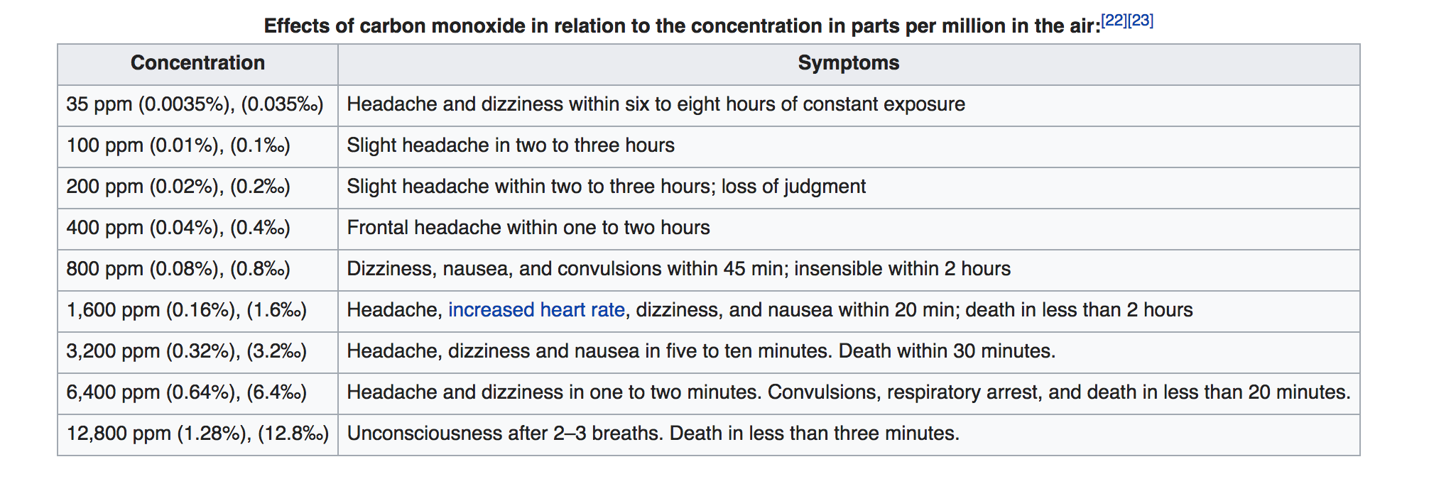

That's because CO poisoning is a dose-response thing.  As NIck said, it's a function of both concentration and duration of exposure.
SO DON'T PANIC!!;
I did actually say it was time related in the OP but was concerned it got to 174ppm which exceeds the US 'get peeps out of confined spaces' edict.
Kidde came back to me this afternoon and said that the meters conform to the EN standard which is the times and amounts in the fireangel as posted above......so at 174ppm they would go off after 10 mins.
Still at least I now know i) my meters are working (both of them)  and ii) dont leave the fire door open too long.
