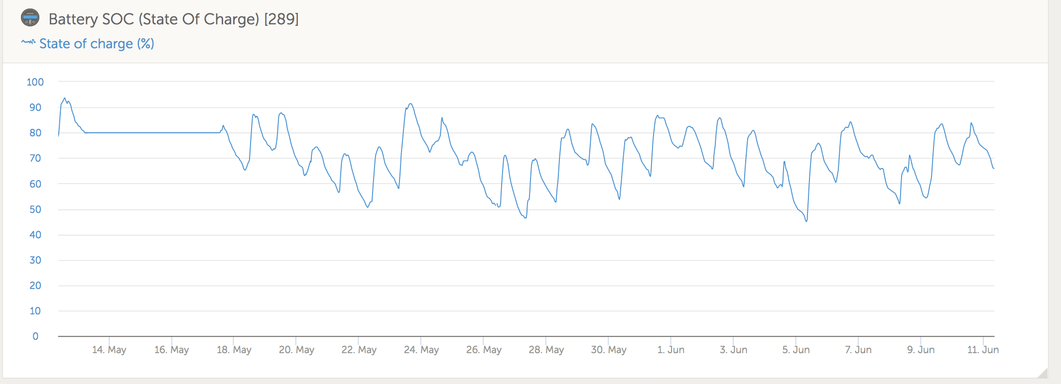

Have a look at the graph below. It is our SoC% over the last 3 weeks. It goes up and down but never reaches 80-90% (the SoC has drifted on the BMV and is reporting about 5-10% too high...so take off 5% and it should be right....from the BMV voltage. I will probably take it back to 100% in 3-4 weeks time to re-set the SoC on the BMV). We tend to do 2-3 hours every other day with an hour of engine each day when we park to heat the water when we are not moving.
