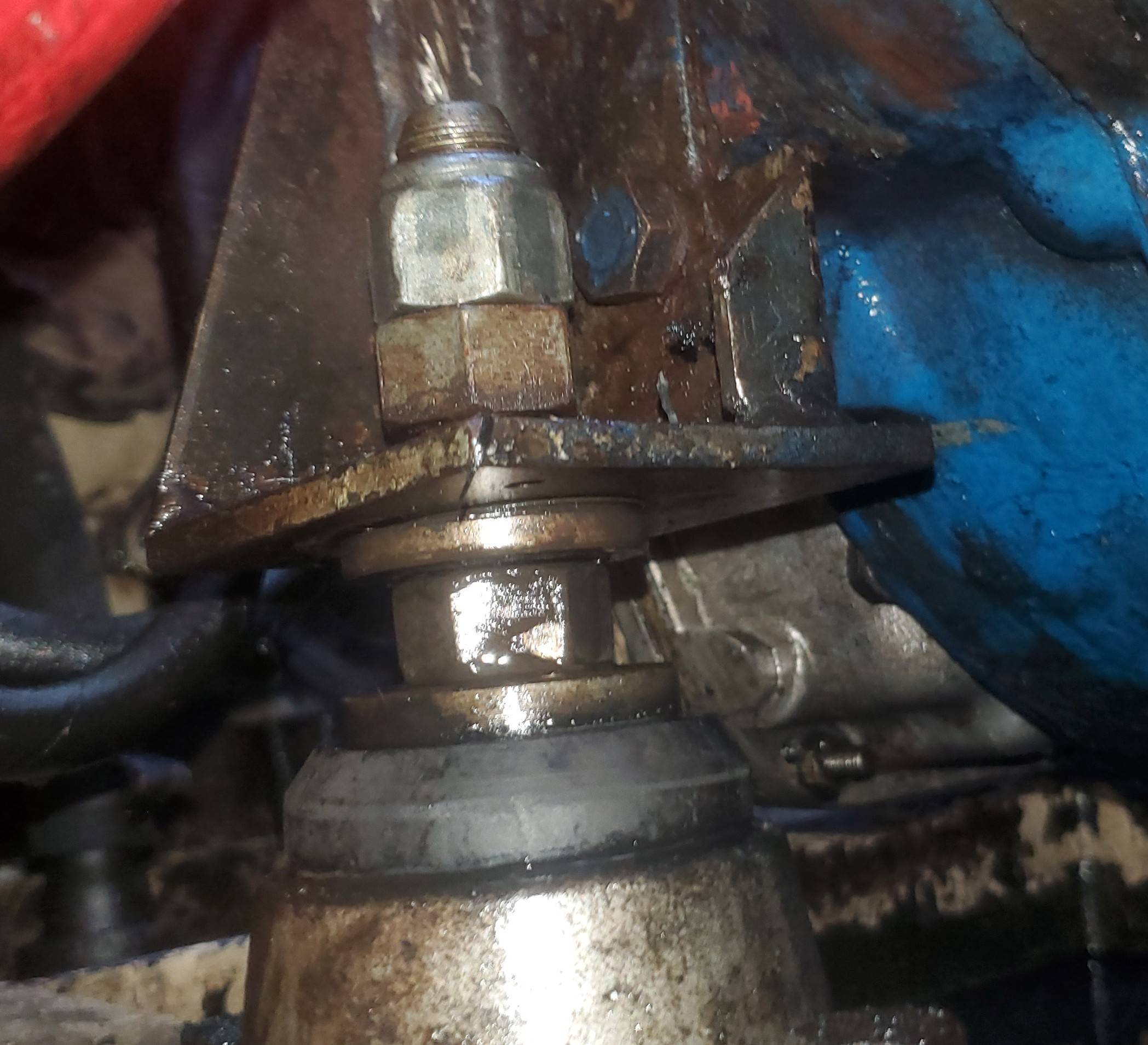

Initially I had an issue with the weed hatch, which created a swimming pool of oily water all around the mounts and lower part of the engine. The engine mounts I believe are only a few years old, but I don;t think my weed hatch incident has helped... Yes these mounts look to be the same. Still concerned that the mounting bolt turns.. My adventure sounds very similar (although significantly less stressful) !! So, as an update for those that have followed this thread.. Despite checking the engine mounts before travelling, and keeping a close eye on the coupling, yesterday the taper lock sheared and broke off again (yes the new one!). I believe the engine mount to be the culprit, as checking the nut, it had worked its way loose again (and yes I tightened as much as I possibly could by hand). Have ordered 2 new taper locks, tightened the engine mount as much as possible again and will repair the coupling tomorrow when the parts arrive. Should be a much quicker job this time. Will need to keep a much closer eye on the engine mount.. When it is tight, the engine looks nice and secure with it running and under load, so I am thinking that its not the mounting bolt that has sheared, and simply a case of the nut needing to be tighter.. -

Tightening the bottom nut has raised the engine up to the other nuts and we are now back into alignment.. Tony, I am also concerned that mount is not all's okay, but if it tightens up like it has, maybe it will be okay?? Will now reassemble the coupling. Having difficulty undoing the nuts on the shaft that attaches to the gearbox atm... -

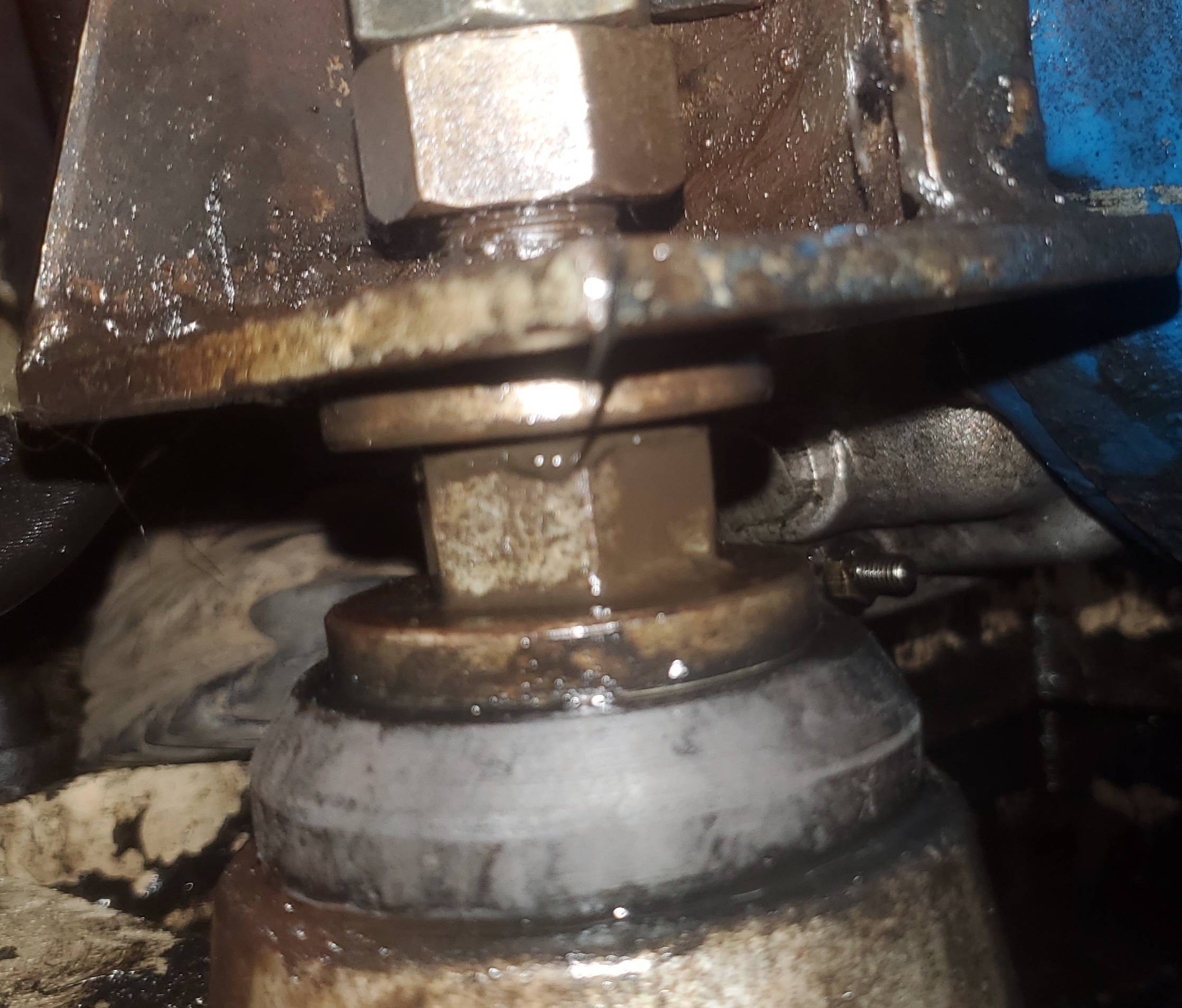

Here is a better picture.. The top nuts are a few mm above the mount, (you can see the gap on n this photo). The bottom nut has either worked it's way down, or it has collapsed somehow.. Will try and raise the bottom nut. (Had to be the mount which is hardest to get to 😞).. -

Really helpful, thank you for taking the time to write it. The prop side of the shaft seems to be fine. So I have started by checking my engine mounts. Three are nice and tight, but the forth ones nuts turns easily. But also the bolt also turns with it. With the shaft alignment, I am about 2-3 mm out on the x-plane. The mount that is loose is the one closest to the gearbox on the right hand side (looking from the shaft). I'm hoping that raising that mount will correct the alignment. I'm thinking that I need to tighten the nut/head under the mount to raise that leg up and make it right again, which should have the effect of adjusting the shaft back into alignment.?? Attaching a photo of the mount that is loose. Concerned now that if the bolt moves that maybe it has sheared? Should the bolt be able to move? Or should that be locked to the mount itself? -
