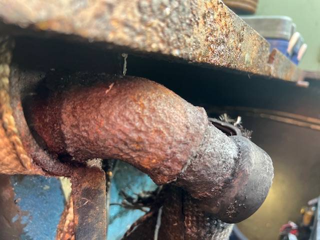

Mark R Posted September 29, 2024 Report Posted September 29, 2024 Morning all, I wonder if any of you could offer suggestions as to disconnecting exhaust fittings from one another. Normally I'd just cut them off with an angle grinder but in this case I need to salvage the 135° fitting as it's connected to the silencer which in turn is welded to a bracket. I tried heating with a blow torch with no luck. I could always cut off the collar that hangs out of the fitting leaving me a small section of pipe to connect in to but I'm not sure if there is a fitting allowing me to do so.
Popular Post blackrose Posted September 29, 2024 Popular Post Report Posted September 29, 2024 (edited) It all looks a bit fooked to me. Is the silencer as rusty as that elbow? If so I'd scrap the lot and start again. Edited September 29, 2024 by blackrose 5
Bee Posted September 29, 2024 Report Posted September 29, 2024 Stone the crows I think the chances of getting that apart are not great. It is almost certainly some sort of standard pipe fitting which should be easy enough to find in your local plumbers merchant or even somewhere on the internet. 1
Tony Brooks Posted September 29, 2024 Report Posted September 29, 2024 4 minutes ago, blackrose said: It all looks a bit fooked to me. Is the silencer as rusty as that elbow? If so I'd scrap the lot and start again. My thoughts as well. I fear working on the pipe may well rip it out of the silencer. All I can think of is to cut the larger diameter piece off the end and see if you can get something from a vehicle exhaust specialist to fit over the stud pipe and clamp it with an exhaust clamp. You would probably need to seal it with exhaust paste. 1

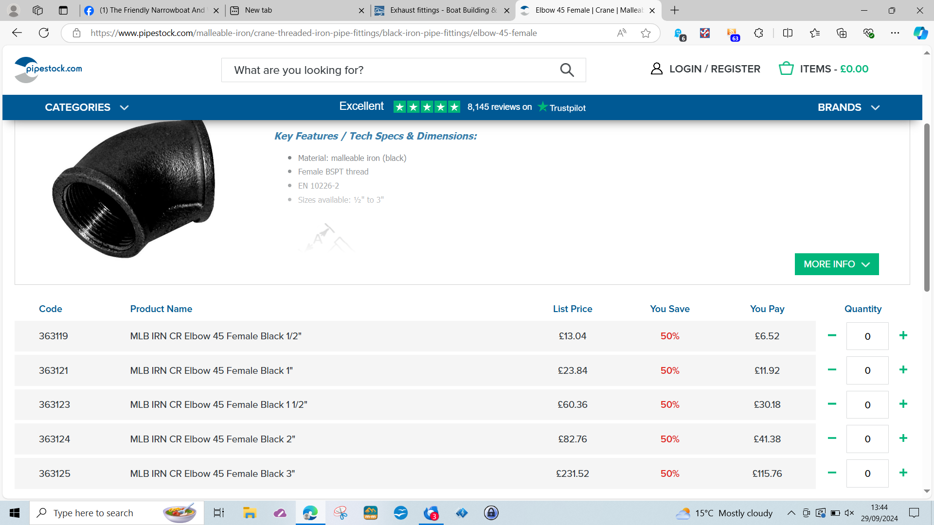

truckcab79 Posted September 29, 2024 Report Posted September 29, 2024 EBay or Amazon. No end of fittings available. If you can’t see it shown then message them and ask them to bend one up for you. When searching you’ll want a 45 not a 135. For some reason plumbing is regarded as 135 and exhaust 45. 1

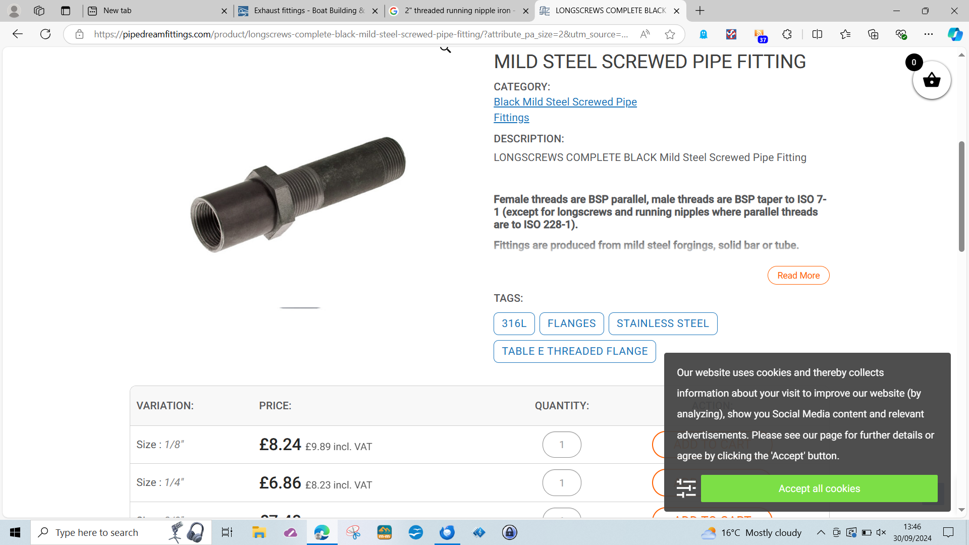

BEngo Posted September 29, 2024 Report Posted September 29, 2024 That bend is knackered. I would go to either a good plumbers merchant or a Pipeline Center and get a new one. To get the old one off split it with a thin disk in an angle or die grinder, going in only enough to clear the thread. Then heat it up. Open the slot with wedges if needed. If you really must reuse then get it all bright red hot and apply large (36 in plus) Stilsons. Silencer may not like this! If that fails, cut off the collar and cut a barrel nipple in half. Then weld the half barrel nipple to the stub end. Then fit a threaded coupler to give the female thread. N 1
hider Posted September 29, 2024 Report Posted September 29, 2024 George Fisher make compression fittings for iron pipe. Part off the fat end and use a compression fitting on the remaining plain pipe. But looking at the corroded state of that pipework I would scrap the lot and start again with new fittings and pipe. 1

truckcab79 Posted September 29, 2024 Report Posted September 29, 2024 3 hours ago, Bod said: Plus Gas and patience. Remove to a decent bench and vice, wire brush off the loose rust, soak in Plus Gas ( a very good penetrating fluid. DO NOT try WD 40 it won't work.) Large pipe wrench, whilest held in vice, soaking may be measured in days/weeks. Whether it will be any good again is the question. Bod Someone that knows what they’re talking about, if you insist on saving what you have. But honestly just cut it all off and replace with new. 1
Ronaldo47 Posted September 29, 2024 Report Posted September 29, 2024 (edited) It does look pretty hopeless. The method I use with Plus-gas (petrol-based lighter fluid is almost as good) is to apply some, leave to soak for a while, then apply more clean fluid and rock the wrench to and fro. Steel and iron are not infinitely stiff, and rocking to and fro can release the turns near the surface while the internal turns remain locked. The clean fluid will turn orange if the thread is starting to become free, and repeatedly flushing the rusty fluid away with clean fluid and continuing to rock the wrench, can have the effect of pumping fluid deeper into the thread. Patience may be required! If the fluid doesn't turn orange, then the thread is well and truly locked. Edited September 29, 2024 by Ronaldo47 typos 1

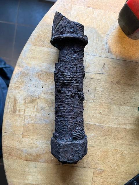

Mark R Posted September 30, 2024 Author Report Posted September 30, 2024 (edited) Thanks all, I went back to the boat yesterday and removed the silencer and as suggested it was fubarred. This leaves me with about an inch of (damaged) threaded bar hanging out of a female socket. I applied significant heat but it wasn't shifting so I shall try Ronaldo47's method or extra heat the next time. Out of curiosity can anyone identify this piece of pipe? I'm thinking it's a bellow, it measures about 180mm in length and had two male threaded ends (one in the remains of a fitting and the other attached to a nut from a flexible bellow above it). Edit: Could it be a piece of 1 1/2" threaded pipe where it's corroded so much the threads are falling off? Edited September 30, 2024 by Mark R

ditchcrawler Posted September 30, 2024 Report Posted September 30, 2024 (edited) 6 hours ago, Mark R said: Thanks all, I went back to the boat yesterday and removed the silencer and as suggested it was fubarred. This leaves me with about an inch of (damaged) threaded bar hanging out of a female socket. I applied significant heat but it wasn't shifting so I shall try Ronaldo47's method or extra heat the next time. Out of curiosity can anyone identify this piece of pipe? I'm thinking it's a bellow, it measures about 180mm in length and had two male threaded ends (one in the remains of a fitting and the other attached to a nut from a flexible bellow above it). Edit: Could it be a piece of 1 1/2" threaded pipe where it's corroded so much the threads are falling off? That looks like an ex running coupler. Edited September 30, 2024 by ditchcrawler 1
blackrose Posted September 30, 2024 Report Posted September 30, 2024 7 hours ago, Mark R said: Just be sure to lubricate those threads when you reuse that! 🤣 2
Mark R Posted September 30, 2024 Author Report Posted September 30, 2024 53 minutes ago, ditchcrawler said: That looks like an ex running coupler. Thanks @ditchcrawler, that's most helpful and might help me when fitting everything together. I’m looking at purchasing https://www.midlandchandlers.co.uk/products/ag-bellows-1-1-2-bsp-male-to-female-20-length-ea-010 , would I be right in assuming that tapered BSP fittings will fit into the female side of this, likewise will the male end fit into tapered fittings?
