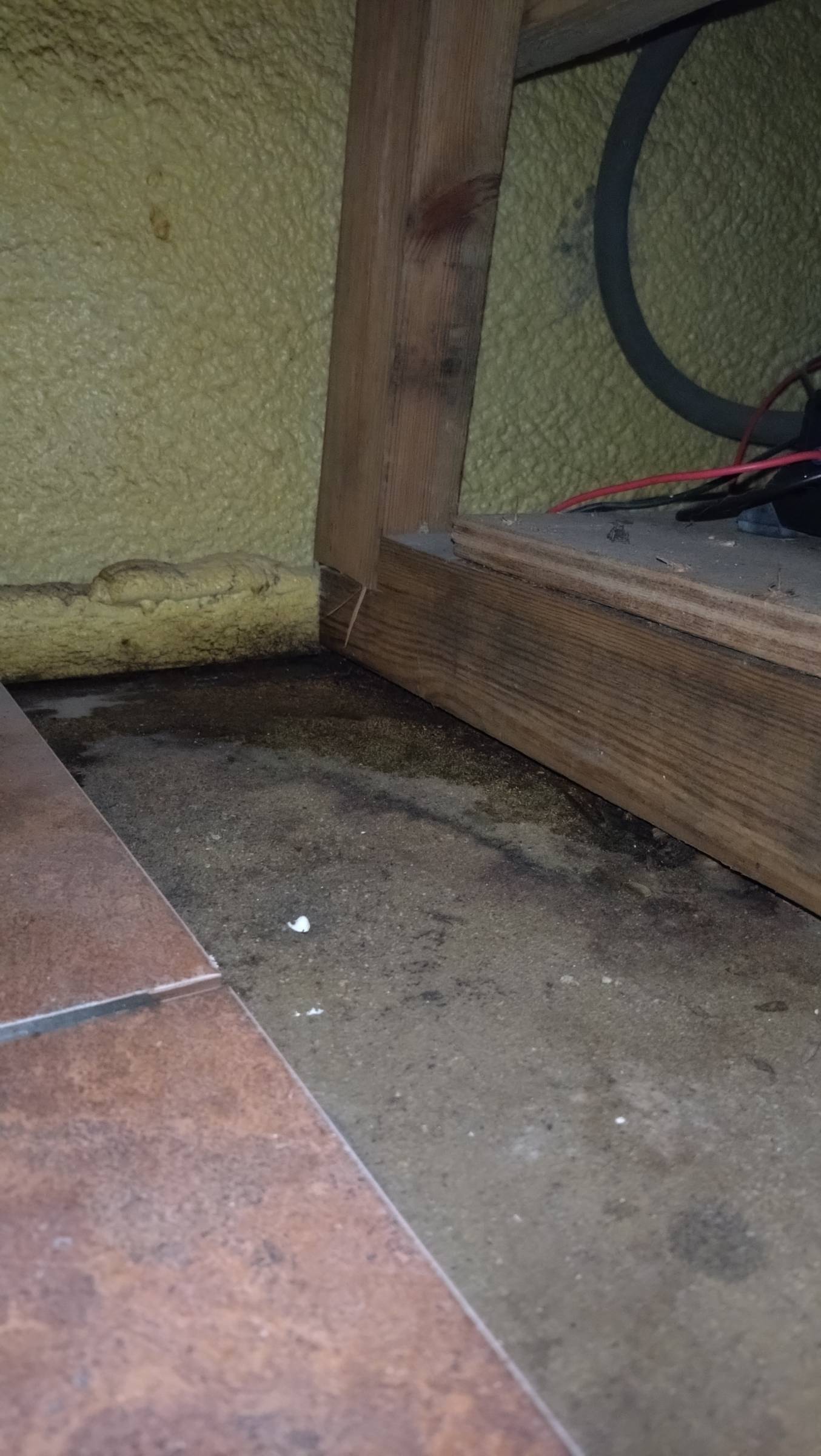

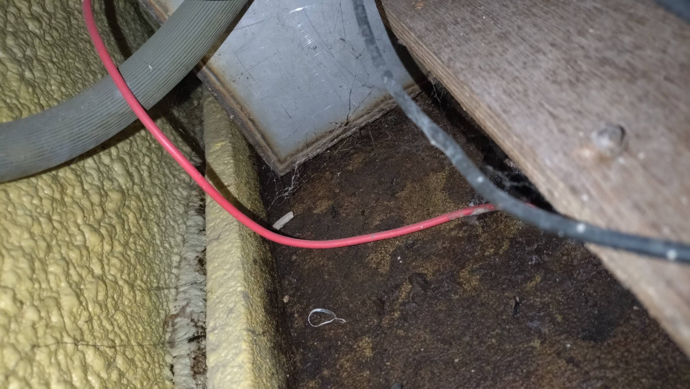

MixingWizzard Posted June 10, 2024 Report Posted June 10, 2024 (edited) Hey all, It's a bit early to tell yet, but my mind is jumping to the worst so I thought I'd put a post on here. I've recently moved into a 57ft narrowboat. Despite getting the all clear from my surveyor I have discovered that the pump out toilet tank is leaking. This combined with the fairly substantial sideways list (which I was reassured was due to the way it was fitted out) has lead me to believe that the tank might have been leaking into the bilge for a fairly long time. Has anyone had to deal with this before? I'm in the process of cutting out some access holes but my inverter wont run an angle grinder so I need to find some mains power to finish the job - why on earth would you fit out a boat without inspection hatches to the bilge! I wondered if I could just drop a smoker in the tank to find the leak, although judging by the wood around it, it has soaked in pretty thoroughly so I fear I may end up having to rip up the floor. I would greatly appreciate some advice, I'm at a bit of a loss as to what to do next. Edited June 10, 2024 by MixingWizzard

MixingWizzard Posted June 11, 2024 Author Report Posted June 11, 2024 Just an update. My attempts at creating an access hatch have failed. I can't get any of the tiles up. With a bit of an excavation with a drill it appears my floor is tile on MDF, with what appears to be a concrete subfloor - is it possible the bottom of the boat has just been filled with concrete?! That seems like a terrible idea. It might explain the list though - if it's just a flat concrete base it won't have been balanced properly.
Tony Brooks Posted June 11, 2024 Report Posted June 11, 2024 (edited) 1 minute ago, MixingWizzard said: Just an update. My attempts at creating an access hatch have failed. I can't get any of the tiles up. With a bit of an excavation with a drill it appears my floor is tile on MDF, with what appears to be a concrete subfloor - is it possible the bottom of the boat has just been filled with concrete?! That seems like a terrible idea. It might explain the list though - if it's just a flat concrete base it won't have been balanced properly. Yes it is possible, several builders have done it, and yes it is a terrible idea. If the concrete is below the MDF then it is very likely unless you hut a paving slab, but one would hope there would be an air gap above the paving slabs. Edited June 11, 2024 by Tony Brooks
MixingWizzard Posted June 11, 2024 Author Report Posted June 11, 2024 1 hour ago, Tony Brooks said: Yes it is possible, several builders have done it, and yes it is a terrible idea. If the concrete is below the MDF then it is very likely unless you hut a paving slab, but one would hope there would be an air gap above the paving slabs. The MDF is completely flush to the concrete so I'm almost certain this is the case. There also isn't at hint of hollowness when banging on the floor. At least this means I'm unlikely to have effluent under the flooring, although I'm not sure what it means for future maintenance. Thankfully the hull is pretty sound. It was built in 2000, and at its worst it was 0.4mm down from 6mm. Even that was a galvanic issue rather that internal degradation so I'm not overly worried. Now for the joyous task of tearing out the bathroom and removing the offending tank! Thank you for all your advice.
