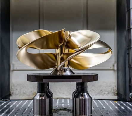

Alan de Enfield Posted January 28, 2023 Report Posted January 28, 2023 Regarding hydrodynamics, Sharrow Marine has developed a range of propellers that significantly advance rotor technology, which halted after the 1830s. Designed as twisted loops instead of traditional blades, the devices have ‘solved the most basic problem of rotary propulsion. Specifically, tip cavitation and vortices have been eliminated or significantly reduced, transforming your entire boating experience,’ explains the company. By decreasing and even eliminating tip cavitation and vortices, the Sharrow models also dramatically reduce noise and energy loss when a boat cruises through open waters. Additional benefits include 50% more reverse thrust, 30% more range, less vibration, and doubled speed at mid-range RPMs. Putting its products to the test, Sharrow demonstrates in the below video the dramatic difference in noise production between a standard propeller and its toroidal design. toroidal propellers turn your drones + boats into noiseless machines (designboom.com)

Tony Brooks Posted January 28, 2023 Report Posted January 28, 2023 A quick scan of both sites did not seem to provide any scientific test results (I may be wrong about that) only claims. Remember Axiom props? 2
StephenA Posted January 28, 2023 Report Posted January 28, 2023 4 minutes ago, Alan de Enfield said: I'd of thought it would slide off easier than on 'blades'. There is no narrow root for the rubbish to get around. But if something gets into those blade gaps...... their own blurb says "in open water" - I have no knowledge of the frequency of prop fouling on open water but I imagine its pretty much zero compared to canals.
magnetman Posted January 28, 2023 Report Posted January 28, 2023 Looks like quite a lot of extra load on the driveline. I hope they have done calculations for stern tube wear, gearbox thrust and engine mounts. Presumably if it produces 30 percent more range it must be extracting more power from the engine. Figures needed.

jonesthenuke Posted January 28, 2023 Report Posted January 28, 2023 55 minutes ago, Alan de Enfield said: Regarding hydrodynamics, Sharrow Marine has developed a range of propellers that significantly advance rotor technology, which halted after the 1830s. Hmm, so all those modern super quiet, super efficient submarine propellors are built to an 1830s design?🤣 Better tell the navy. 1
IanD Posted January 28, 2023 Report Posted January 28, 2023 51 minutes ago, magnetman said: Looks like quite a lot of extra load on the driveline. I hope they have done calculations for stern tube wear, gearbox thrust and engine mounts. Presumably if it produces 30 percent more range it must be extracting more power from the engine. Figures needed. If you go and read the articles there are actual test results; IIRC at the same engine power, they deliver something like 20% more thrust. This shouldn't be a problem for any driveline. Alternatively for the same speed they lower fuel consumption by the same amount, with no more thrust on the driveline at the same speed. 1

IanD Posted January 28, 2023 Report Posted January 28, 2023 21 minutes ago, jonesthenuke said: Hmm, so all those modern super quiet, super efficient submarine propellors are built to an 1830s design?🤣 Better tell the navy. They're all tweaked designs based on conventional turbine propellers, and still waste energy in tip vortices which the Sharrow doesn't. Having dug into the details it does look like a genuine advance in prop design, unlike the Axiom. But would certainly be a lot more prone to fouling on canals, the loops will catch stuff that is thrown off with a normal prop. And they're expensive because they're more difficult to make, and proprietary... 😞
