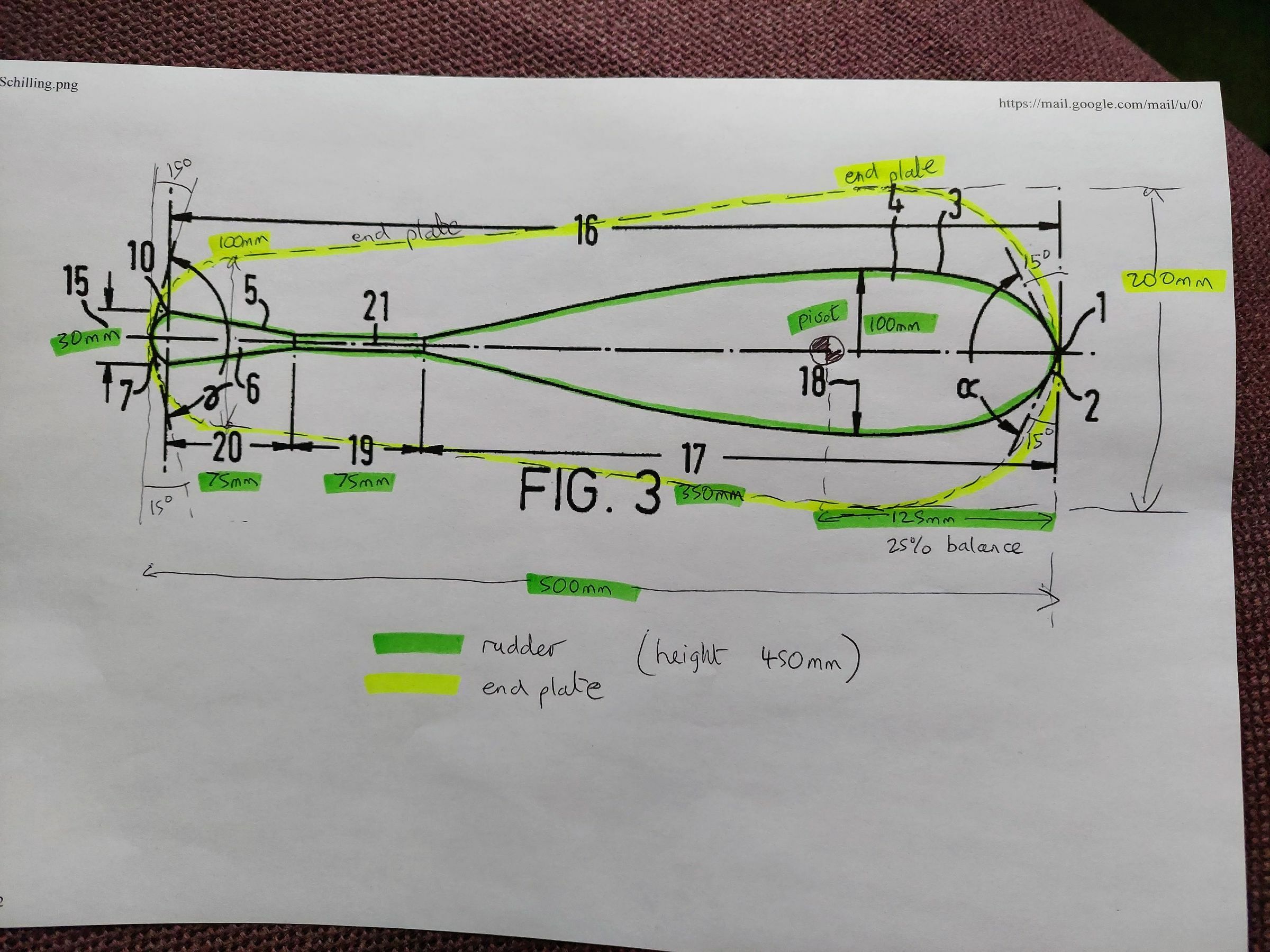

#44
4 minutes ago, IanD said:
Or if you don't mind being abused by the "new technology is bad" school and you have both a bow thruster *and* a Schilling rudder, you can move both ends of the boat away from the bank in parallel at the same time... 😉
Getting more technical now (had to look up a Schilling rudder) but I would have thought that having a bulbous shaped rudder (Schilling) would increase drag when travelling in a straight line wouldn't it? (isn't that why F1 cars have a DRG system?) Surely a twin flat rudder would have a better effect (not having seen either on a narrow boat though;)).
#45
Kort rudder, best of both worlds.
#46
The drag increase is tiny (especially at low speeds like on the canals), just like it is for an aeroplane aerofoil. In fact it can be zero, because the Schilling rudder has more lift (sideways thrust) for a given size, so you can use a smaller rudder -- mine is about 500mm long compared to about 700mm for a flat plate rudder, see drawing (from Schilling patent).
Twin flat rudders still don't work at large angles because the water flow breaks away from them (stalling), the Schilling rudder works up to much bigger angles by keeping the water flow attached to the rear side.
Kort rudders (or nozzles, to be more accurate) work very well in low-speed marine applications like tugs. On a canal they're very prone to getting jammed by weeds or canal debris because of the small clearance between propeller and nozzle... 😞
Edited by IanD
#47
8 minutes ago, IanD said:
The drag increase is tiny, just like it is for an aeroplane aerofoil. In fact it can be zero, because the Schilling rudder has more lift (sideways thrust) for a given size, so you can use a smaller rudder -- mine is about 500mm long compared to about 700mm for a flat plate rudder.
I would need convincing that the drag increase would be zero just because the rudder size is smaller since with a conventional rudder it will be the leading edge and thickness that creates the drag rather than the length of rudder. I was thinking that since water is a bit heavier than air, displacing the flow by having a bulbous rudder would lead to some increase in drag. Since my boat isn't highly powered in the first place, I'm not sure I'd want to.
#48
Rudder drag has two components, profile drag and skin drag. If you want to go and dig through all the academic papers on rudder design they show almost no drag increase for aerofoil rudders when straight ahead, and some increase as deflection increases -- however this is just rudder drag, which is orders of magnitude smaller than hull drag, so the overall drag increase on the boat is negligible. You also need to bear in mind that the rudder isn't just being dragged through the water, the rapidly rotating wash from the prop hits it, and a bulbous leading edge rather than a sharp one helps to straighten this flow out without turbulence or flow separation as it passes the rudder.
At low speeds (like narrowboats, or slow planes) thicker profiles are used to get more lift with very little drag increase -- the one I posted was a 20% profile, but even 25% has been used for low-speed ships. At high speeds like supersonic planes or planing boats the tradeoff is different and much thinner profiles are used (e.g. 5% or less), but this doesn't matter for the canals 🙂
Edited by IanD
