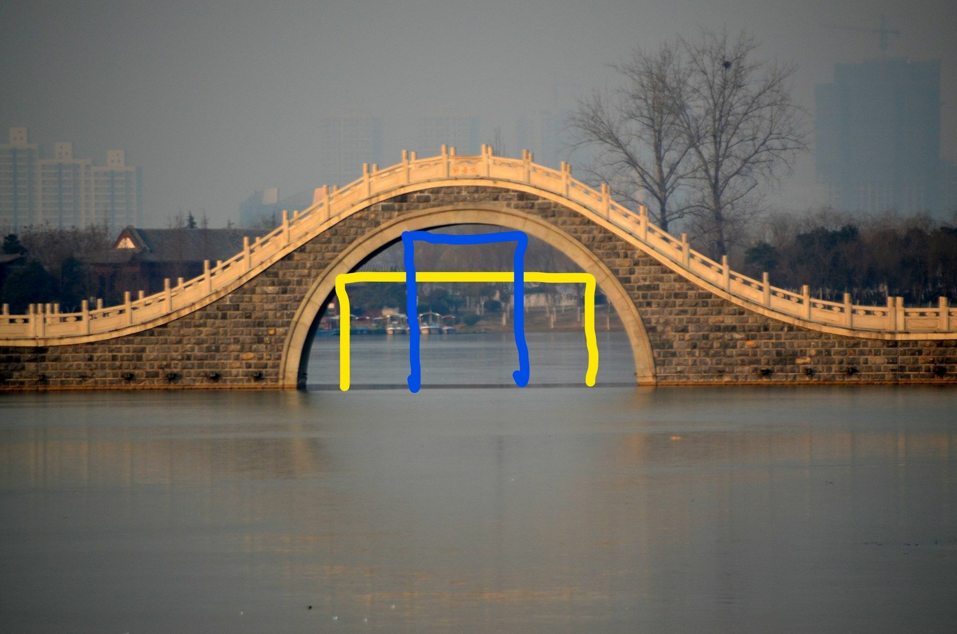

Alan de Enfield Posted October 10, 2021 Report Posted October 10, 2021 (edited) 30 minutes ago, TheBiscuits said: They still need to fit under the bridges so they can't go any higher to make up for it. If anything, a widebeam will have a lower headroom to make up for the width problem in getting thru arched bridges - but I guess if you are having a bespoke one built (not one from a 'production' line like Aqualine or Colecraft) I guess you can have anything you want if you are prepared to pay. We had a narrowboat with a 13mm base plate which meant the interior floor could be at least 6" lower than normal, remember that when you walk you 'lift' up on the balls of your feet and normally 'walk' about 3" higher than you actually are - my 6' 3" Son could easily walk down the NB without touching the roof. Our current 14 foot 'fatty' is much lower roof height in parts of the boat. A simple schematic to show a fat-boats height restriction compared to a narrow-boat height restriction. Hopefully self explanatory. Edited October 10, 2021 by Alan de Enfield 3
TheBiscuits Posted October 10, 2021 Report Posted October 10, 2021 Just now, Alan de Enfield said: A sinple schematic to show a fat-boats height restriction compared to a narrow-boat height restriction. Hopefully self explanatory. True, but only to a point. Curvature of the roof can change the internal height quite a bit, as long as you only walk down the centre ...
Alan de Enfield Posted October 10, 2021 Report Posted October 10, 2021 3 minutes ago, TheBiscuits said: True, but only to a point. Curvature of the roof can change the internal height quite a bit, as long as you only walk down the centre ... Indeed - fit an astrodome and you can look at the stars as you walk down the centre line of the boat :

nb Innisfree Posted October 11, 2021 Report Posted October 11, 2021 Bridge clearance is measured from arch to canal bed, that is the max space a boat has to fit in, no compromise, its either a lower roof line or deeper draught, take your pick.
Alan de Enfield Posted October 11, 2021 Report Posted October 11, 2021 (edited) 10 minutes ago, nb Innisfree said: Bridge clearance is measured from arch to canal bed, I do not believe that that statement is correct, 'bridge clearance' (or 'air draft') is the space between the bottom of the bridge and the water surface, you then also have 'draft' (or water depth) You are correct in that you need to consider both aspects, but in many cases they are mutually exclusive - It doesn't matter how shallow draft your boat if its air-draft is 8 feet and the bridges have a 'bridge clearance' of 7 feet you will not get under. Edited October 11, 2021 by Alan de Enfield
Rob-M Posted October 11, 2021 Report Posted October 11, 2021 12 minutes ago, Alan de Enfield said: I do not believe that that statement is correct, 'bridge clearance' (or 'air draft') is the space between the bottom of the bridge and the water surface, you then also have 'draft' (or water depth) You are correct in that you need to consider both aspects, but in many cases they are mutually exclusive - It doesn't matter how shallow draft your boat if its air-draft is 8 feet and the bridges have a 'bridge clearance' of 7 feet you will not get under. But if there was sufficient depth of water you could add some temporary ballast to sit deeper in the water and get through the bridge.
