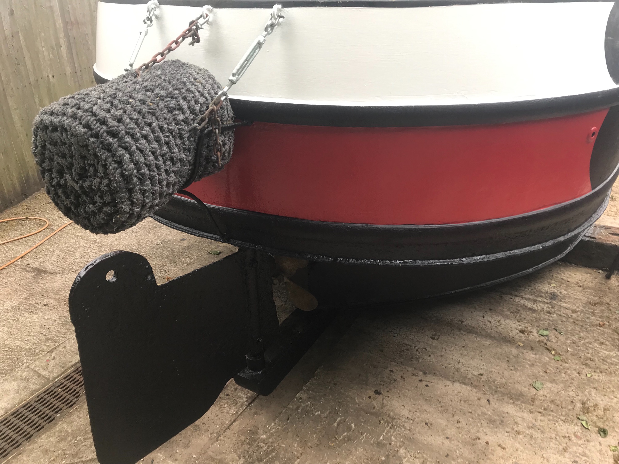

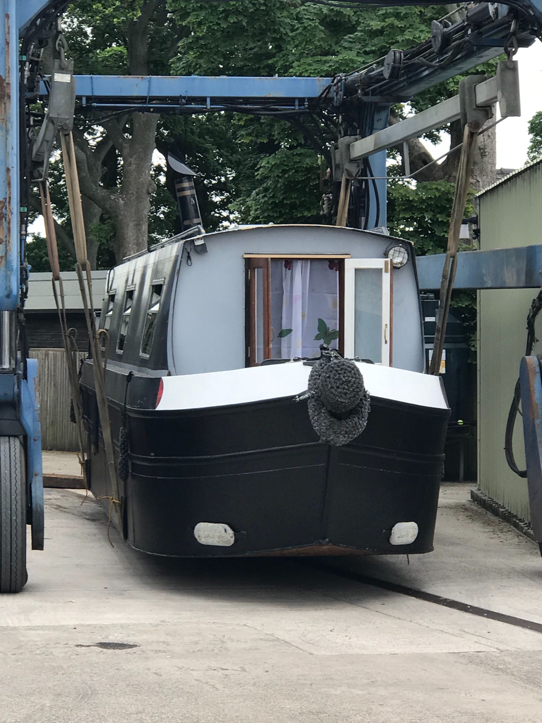

I should have measured our prop when it was out of the water, and this is the only pic I have. I looked at the other narrowboats that were out of the water and thought they all looked about the same size. But when cruising we are constantly having to let other boats pass us - so others are able to go faster, just not us. That’s the biggest problem really. If everyone else were as slow as us I probably wouldn’t mind. But then there’s that Ribble Link that we want to cross to get to the rest of the network!?
That is a shorter boat and in general the shorter the boat the shorter the swims are so the boat is as stable as possible within its size. Short stubby swims make it harder to get water into the prop and also tend to push more water in front of it than long swims will.
I very much doubt the Lancaster is that deep nowadays, not that I have been on it. Just like most other canals I would expect abut 2ft of water and then a couple of foot of mud slurry that increases its viscosity as you  go down. The pole may look a sf its gone down 5 ft but a lot of that will be in mud.
It's not just prop diameter, the pitch is important as well. As a general rule you want to swing the largest diameter prop that you can allowing enough tip clearance so may boats with a similar stern post height will look as if they have the same diameter prop but if the pitch is not enough you will need high revs for a given speed but I would expect more revs to give more speed until the maximum hull speed is reached or the engine runs out of revs. The maximum hull speed will be reduced in confined waters.
