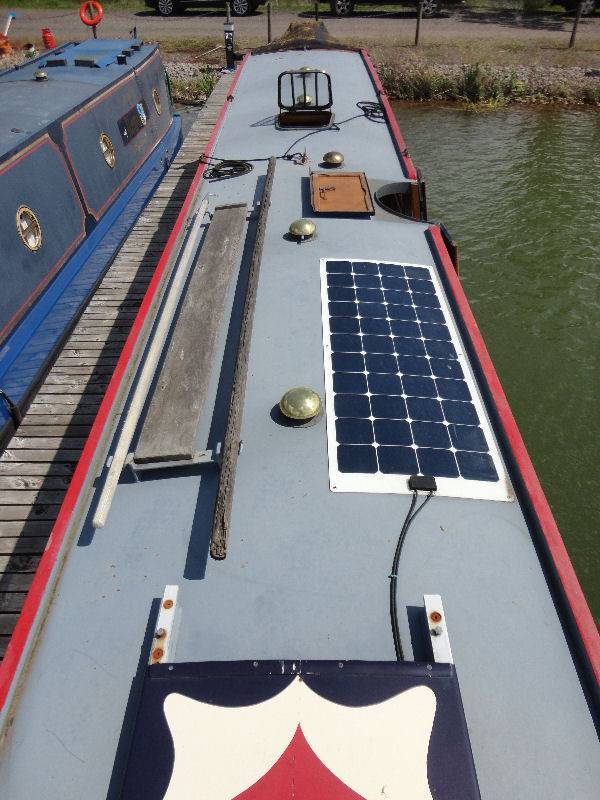

  15. We used a 240w semi-flexible panel as pictured below which kept up with most of our usage (pic is after the panel had been in place for 5 years) Semi flexible panels will not last as long as solid ones, the plastic coating degrades over time (probably UV damage) Based on when a friends identical panel failed I would expect 6-7 years lifespan.
