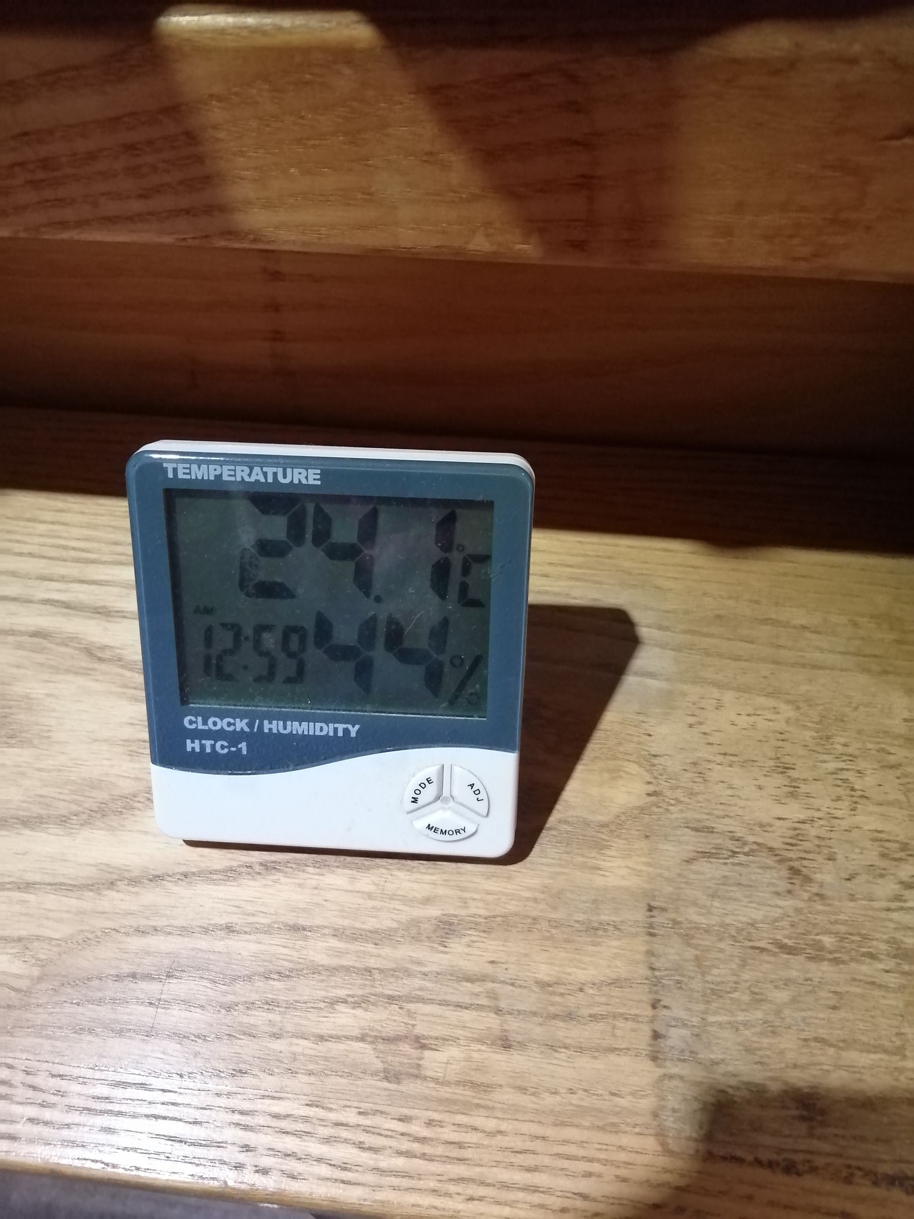

mrsmelly Posted December 27, 2020 Report Posted December 27, 2020 16 minutes ago, Detling said: I don't even heat my house to 22 degrees its what jumpers were made for. Bathroom is about 22 though. Those house places are horrible cold places. Just taken this on my boat and it's gone down nearly 2 degrees since 5 pm. Why live in horrible cold houses?
