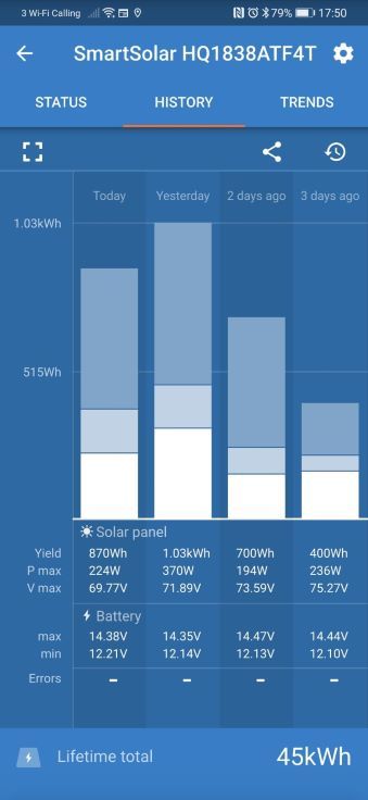

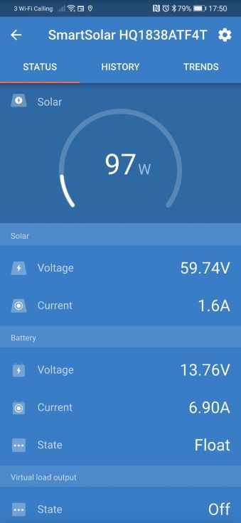

huami Posted June 25, 2020 Report Posted June 25, 2020 Hi Everyone, This is a question from someone who is not the most technical person around so if anyone can give me some basics (keep it simple please!) it would be great to hear from you. On a decent weather day my Solar (2 x 175 watt) will show it has filled the batteries by about 2pm. I have 2 x 12-volt leisure batteries. My thinking is that if I ditch these two batteries and buy 5 new 12-volt batteries (I have been told I have space for 5) then the solar (or my engine) can keep working, pumping in power until they are all full, giving me far more reserve storage. Am I thinking this right? (Or not understanding this good?). I have a Victron Inverter (Phoenix Multiplus 12-volt 1600 Va – 70 Amp, and a Smart Solar App that I took these screen shots from. Any help or advice would be most appreciated. Thanks, Neil

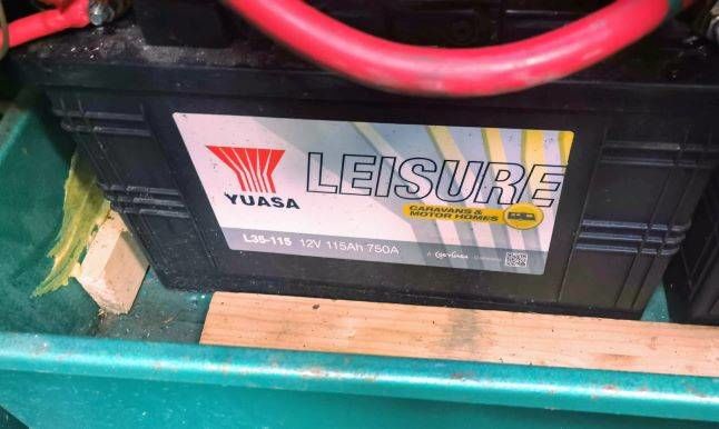

huami Posted June 25, 2020 Author Report Posted June 25, 2020 51 minutes ago, robtheplod said: Hi Neil!!! Having more batteries does mean you can build up more reserves. We've got 4 x leisure and 1 x starter. What type of batteries do you have - any markings on them? Hi Rob, Thanks for the reaction. I just took a photo and I seem to have two of these:- Thanks again Neil 43 minutes ago, mrsmelly said: Yes. Think of batteries as a simple fuel tank. Bigger fuel tank more fuel. Size needed to compare though as the capacity of each battery varies. Just remember that come winter solar is as much use as a chocolate fireguard. Hi, and thanks for your reply (amazing that I was on the right track!). Winters I am planning to return to Whilton Marina and will use shoreline most of the time. Thanks, Neil 1

ditchcrawler Posted June 25, 2020 Report Posted June 25, 2020 4 hours ago, huami said: Hi Everyone, This is a question from someone who is not the most technical person around so if anyone can give me some basics (keep it simple please!) it would be great to hear from you. On a decent weather day my Solar (2 x 175 watt) will show it has filled the batteries by about 2pm. I have 2 x 12-volt leisure batteries. My thinking is that if I ditch these two batteries and buy 5 new 12-volt batteries (I have been told I have space for 5) then the solar (or my engine) can keep working, pumping in power until they are all full, giving me far more reserve storage. Am I thinking this right? (Or not understanding this good?). I have a Victron Inverter (Phoenix Multiplus 12-volt 1600 Va – 70 Amp, and a Smart Solar App that I took these screen shots from. Any help or advice would be most appreciated. Thanks, Neil Your batteries have gone into float before they are charged unless you have a load on. I wouldn't want to see more than 3 amps at 14.4 volts to show the batteries are charged. Sorry I don't know how to change the settings.
huami Posted June 25, 2020 Author Report Posted June 25, 2020 4 hours ago, ditchcrawler said: Your batteries have gone into float before they are charged unless you have a load on. I wouldn't want to see more than 3 amps at 14.4 volts to show the batteries are charged. Sorry I don't know how to change the settings. Hi Brian .... From what you say "Your batteries have gone into float before they are charged" then should I get in touch with an electrician or the guy that installed the solar? Thanks for your comments Neil
Alan de Enfield Posted June 25, 2020 Report Posted June 25, 2020 5 minutes ago, huami said: Hi Brian .... From what you say "Your batteries have gone into float before they are charged" then should I get in touch with an electrician or the guy that installed the solar? Thanks for your comments Neil No, its just that the monitor is not set up correctly for the batteries, It may think your battery bank is bigger / smaller than it is, It may be that it is not set up for the correct type of batteries. It just needs reprogramming / re-setting. It can possibly be done via your phone and the Victron App.
ditchcrawler Posted June 25, 2020 Report Posted June 25, 2020 1 hour ago, Alan de Enfield said: No, its just that the monitor is not set up correctly for the batteries, It may think your battery bank is bigger / smaller than it is, It may be that it is not set up for the correct type of batteries. It just needs reprogramming / re-setting. It can possibly be done via your phone and the Victron App. Which is something I dont have first hand knowledge of, but it is a common problem

WotEver Posted June 25, 2020 Report Posted June 25, 2020 15 hours ago, huami said: On a decent weather day my Solar (2 x 175 watt) will show it has filled the batteries by about 2pm. Maybe it has, or maybe not. Going into float is not an indication that they're fully charged. If I'm reading the correct manual then section 1.9 reads: 1.9.1. Bulk During this stage the controller delivers as much charge current as possible to rapidly recharge the batteries. 1.9.2. Absorption When the battery voltage reaches the absorption voltage, the controller switches to constant voltage mode. When only shallow discharges occur, the absorption time is kept short in order to prevent overcharging of the battery. After a deep discharge the absorption time is automatically increased to make sure that the battery is completely recharged. Additionally, the absorption period is also ended when the charge current decreases to less than 1A. 1.9.3. Float During this stage, float voltage is applied to the battery to maintain a fully charged state. When the battery voltage drops below float voltage during at least 1 minute a new charge cycle will be triggered. This seems to me to be a very good algorithm, with 1.9.2 configured to give maximum battery life. However... Regardless of any other readings, if you have no loads switched on and if the controller is pushing in circa 7A at only 13.76V into say a 220Ah battery bank then I'd guess that the batteries are maybe 80% charged (it's difficult to know for sure). With no loads connected I'd expect the current to fall to about 1A at the float voltage. Of course, if you had lots of 12V stuff running when you took those images then they don't mean much at all. 1
