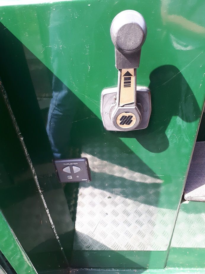

robtheplod Posted November 21, 2019 Report Posted November 21, 2019 Hi, I've got a Beta 43 with the usual two morse cables. I'm trying to identify them so I can carry a spare and I wondered are both of these cables likely to be the same or are they different types?
DaveR Posted November 21, 2019 Report Posted November 21, 2019 I believe yes, that is what I have on Legacy. It is just the length that is different. From memory the gear change is 5 feet & throttle is 6 feet, however each boat is different and you need to measure them both for yours. 1
Tony Brooks Posted November 21, 2019 Report Posted November 21, 2019 Almost a dead cert they will be 33C cables but the length may alter. You can use a longer one in most cases and hide the extra length in a wide bend or two but it may stiffen the action. 1

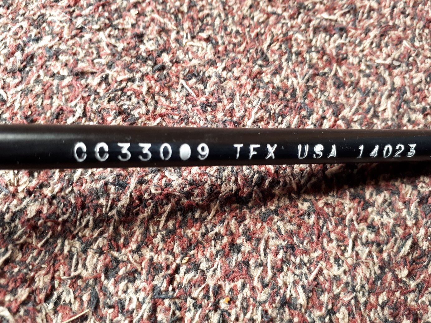

robtheplod Posted November 21, 2019 Author Report Posted November 21, 2019 The one I can identify is this one, but cant see an equiv in midland chandlers?

Flyboy Posted November 21, 2019 Report Posted November 21, 2019 (edited) 21 minutes ago, robtheplod said: The one I can identify is this one, but cant see an equiv in midland chandlers? This is 33C 9ft cable in your picture, Morse cables are now branded Seastar and come in red and black. I got some replacements from here, much cheaper than Midland. Morse Seastar cables are measured from end of end of the inner. https://www.ebay.co.uk/itm/Seastar-Morse-Red-Jacket-33C-Control-Cables-3-40ft-available/362145741239?hash=item54519179b7:m:mYOdpDhZyFsDfS-0CFQO89g Edited November 21, 2019 by Flyboy 1

robtheplod Posted November 21, 2019 Author Report Posted November 21, 2019 4 minutes ago, Onewheeler said: I've only had one fail in 20 years, at the end where it connects to the controller. It caused a spectacular stop onto the visitor pontoon in Bristol harbour, 30 minutes boating before locking down to the tidal Avon and Severn. Worth keeping a spare and knowing how to fit it. That's a good point, I shall have to do a dummy run to see how it fits the morse …. I'll have to figure out how this comes away...
Jen-in-Wellies Posted November 21, 2019 Report Posted November 21, 2019 11 minutes ago, robtheplod said: That's a good point, I shall have to do a dummy run to see how it fits the morse …. I'll have to figure out how this comes away... Mine isn't the same, but might offer some clues on where to look. Here is how to get at the cable connections on my boat. On the handle, there is an allen head grub screw that holds it to the splined shaft. Opposite end to the handle. Loosen it and the handle comes off. The black plastic cover can be unclipped to reveal a metal frame, held on with four bolts to the steel pedestal. Undo the bolts, then wiggle the mechanism around till you find the way to remove it through the pedestal. Alternatively, drop it down through the pedestal and get it from underneath. Jen
