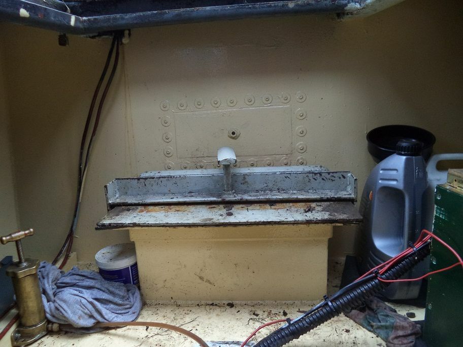

  7. Looking at the restriction for access to the weed hatch, do keep in mind the space needed to kneel/stand to be able to get down there. Also a thought for what & how you bring out the debris.. I concur about the thoughts on battery maintenance. Battery isolators, I think outside the engine room is the best location. Consider a vent plug on the skin cooling tank, easier to drill, tap & paint before everything is fitted. Also a larger plug will allow any silt/rust debris to be vacuumed out. Legacy has a plate cut into the diesel tank, easily removable for any clean out job.
