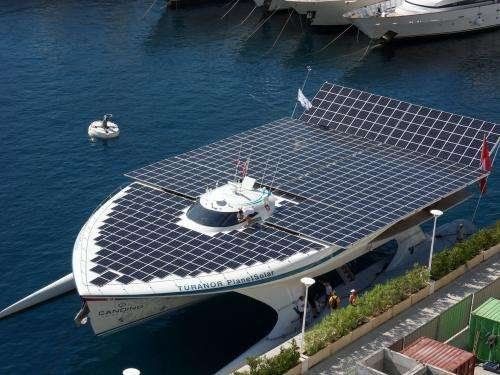

WotEver Posted April 9, 2019 Report Posted April 9, 2019 3 hours ago, zenataomm said: My concern is always that with the number of solar panels draping the rooves of boats there could be a drain on the sun. That'd result in a brightness drop for us all. I blame this bloke...

Jen-in-Wellies Posted April 10, 2019 Report Posted April 10, 2019 16 hours ago, WotEver said: I blame this bloke... If you look very carefully you can see the shore line cable used to keep the batteries topped up when it is cloudy. Jen 1

Guest Posted April 10, 2019 Report Posted April 10, 2019 1 hour ago, Jen-in-Wellies said: If you look very carefully you can see the shore line cable used to keep the batteries topped up when it is cloudy. Jen Doesnt it sail around the world constantly? its a very clever piece of work to be sure
