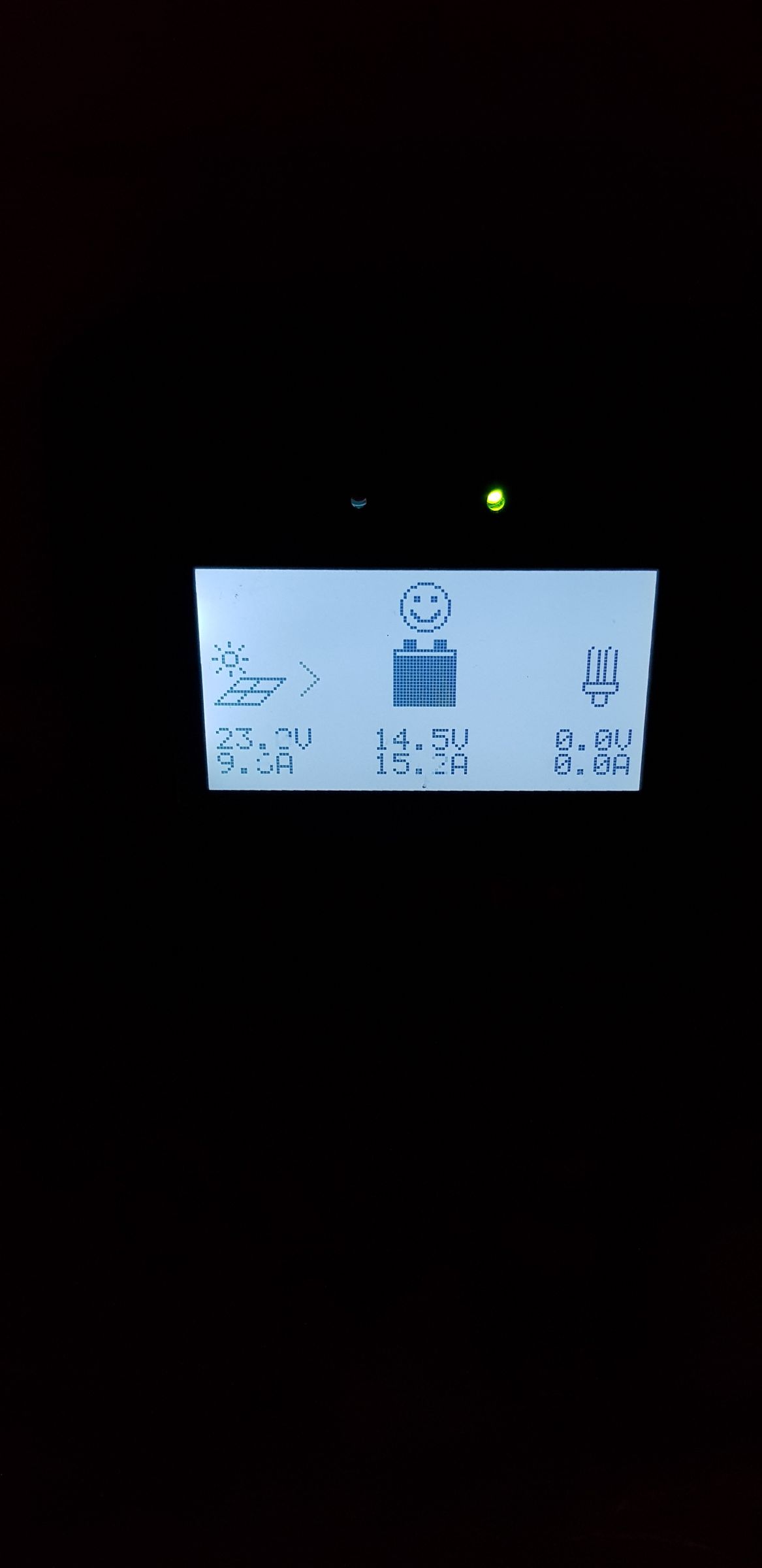

Rickent Posted April 21, 2019 Report Posted April 21, 2019 Panels now fitted and have been off grid since friday , fridge is running 24/7 , tv, lights pumps and phone chargers plus fan during the day. At 8.30 this morning batteries charging nicely and 9 amps currently going in. Should be full by lunchtime. Why anyone would choose not to have solar is beyond me.
The Welsh Cruiser Posted April 21, 2019 Report Posted April 21, 2019 15 minutes ago, Rickent said: Panels now fitted and have been off grid since friday , fridge is running 24/7 , tv, lights pumps and phone chargers plus fan during the day. At 8.30 this morning batteries charging nicely and 9 amps currently going in. Should be full by lunchtime. Why anyone would choose not to have solar is beyond me. It's a great feeling isn't it, no more noisy engines to run, no need to think about conserving energy for 8 months of the year. I fitted mine 5 years ago, best thing I ever did. 1
