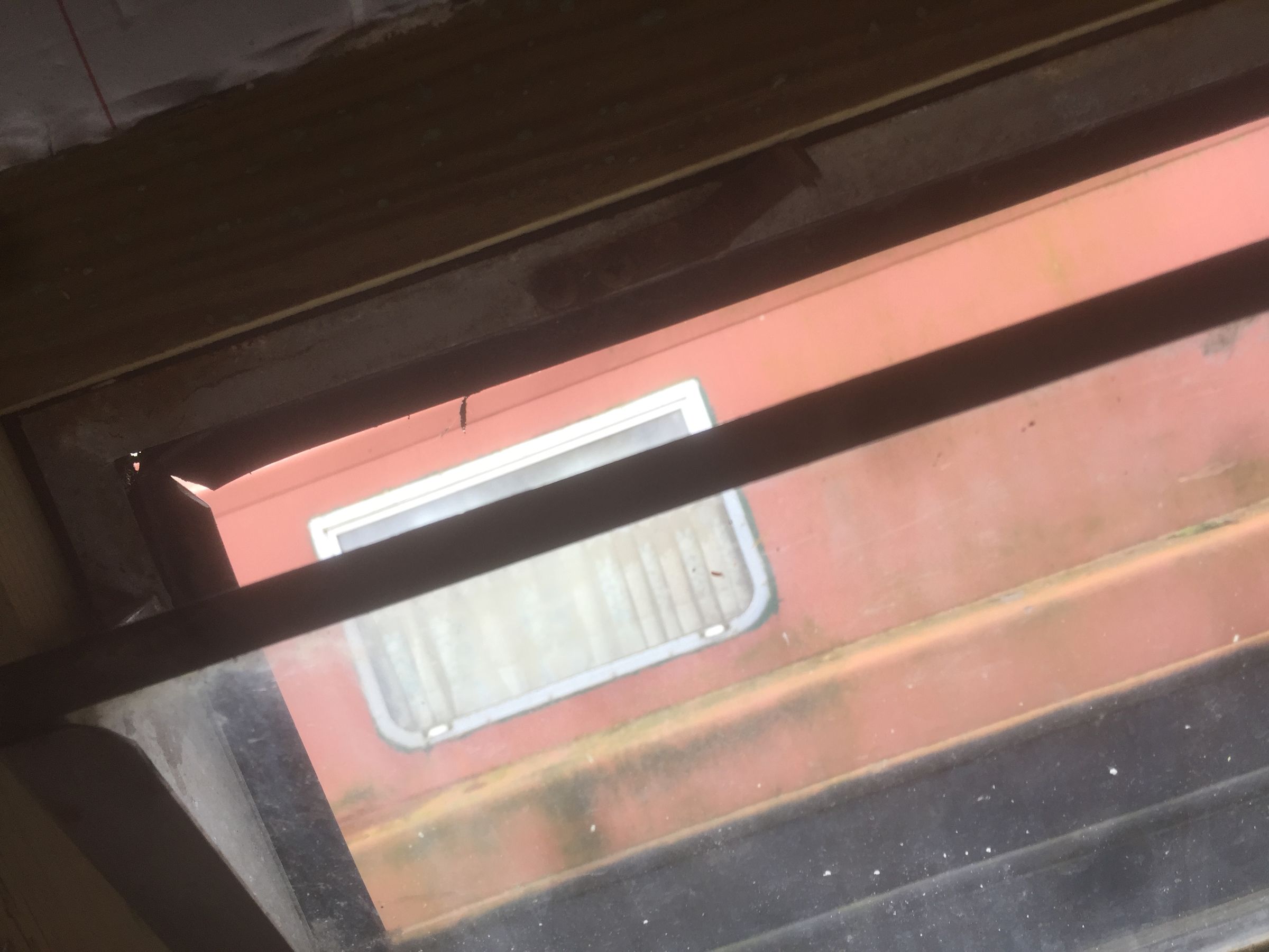

Rory_d Posted March 13, 2019 Report Posted March 13, 2019 Evening all! ok so I’ve really been progressing with the boat project the last few weeks and am currently sourcing all leaks to get the boat water right. basically every single window leaks, I’ve spoken to channel glaze and seals direct to no avail! Basically I need to replace the external seal that pushes into the frame that the top hopper window pushes against when it’s closed. channel glaze have told me that there seals don’t fit as mine weren’t manufactured by them and seals direct don’t do a seal that matches my profile. channel glaze have told me that the windows were manufactured by a company called hardall or ardall and they seized trading many years ago. can any body tell me or have any advice or ideas as to what on earth I can do to rescue these windows. ive piled thousands into this boat and really can not afford the expense of replacing the windows. Also do another window issue is the bathroom windows are total pants, they screw in at the top outside then flip outwards yet the seals are totally shot and there is no window casements for them. Thankyou all in advance!

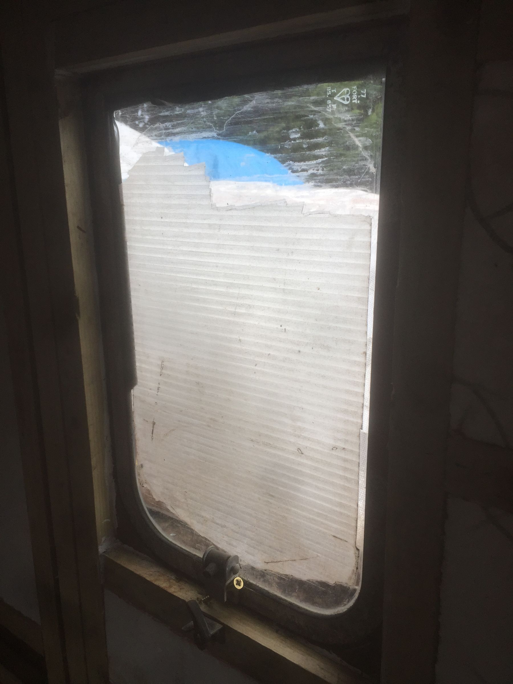

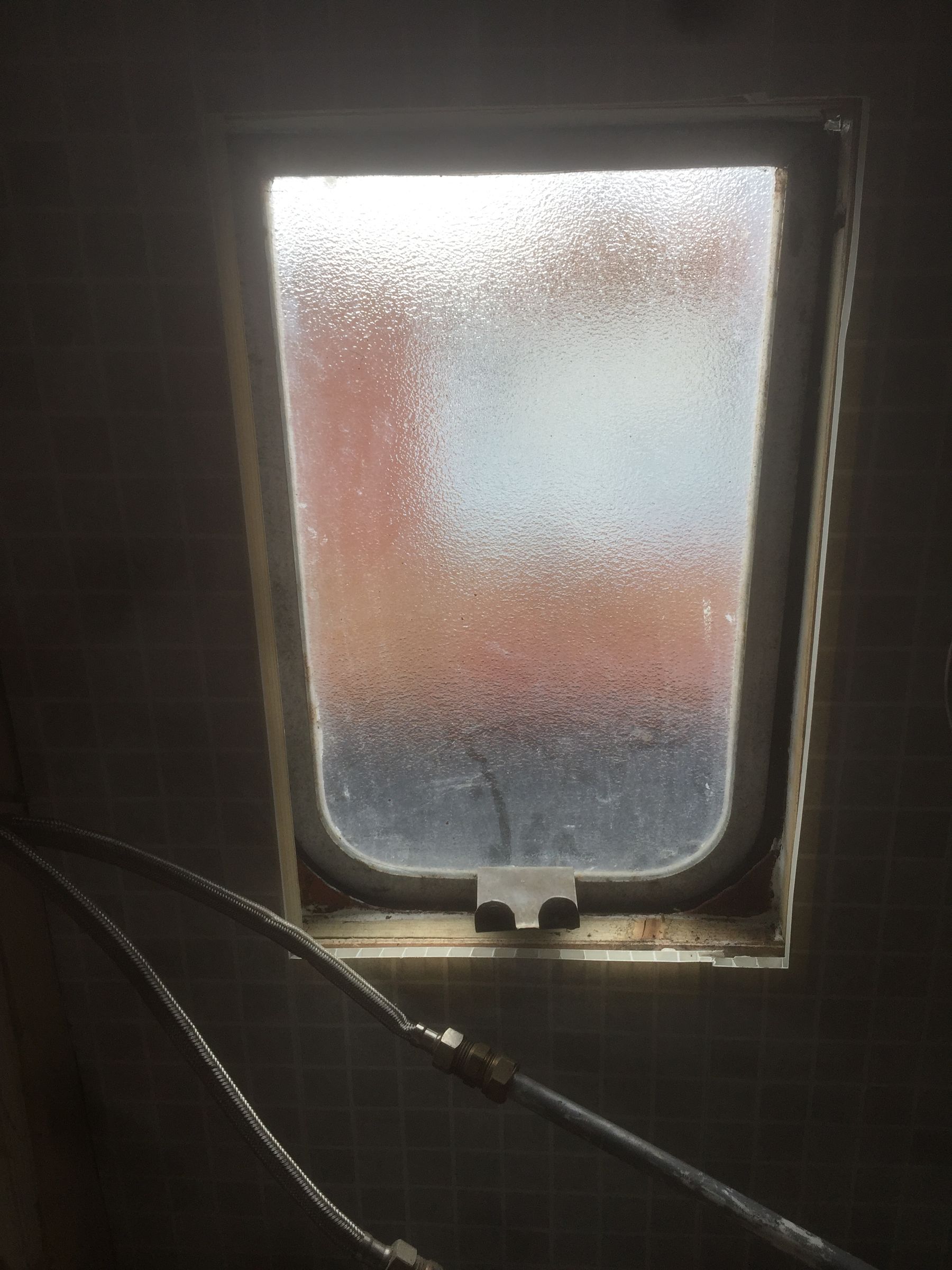

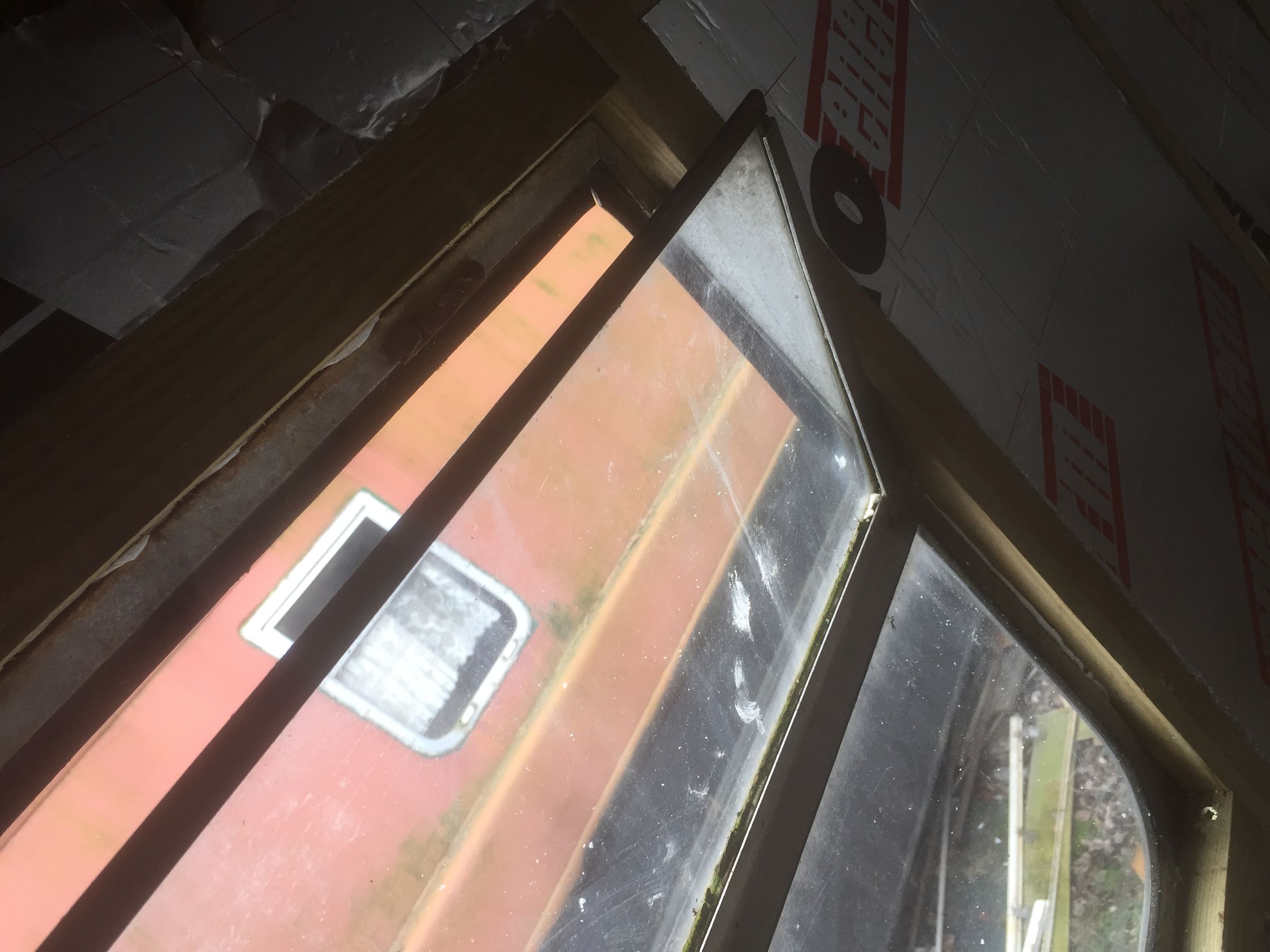

matty40s Posted March 13, 2019 Report Posted March 13, 2019 With your hopper window pictures either use a flash inside or take one from outside as its difficult to tell what is right or wrong. The bathroom window could be resolved with some this 3M window seal - or get Channel glaze to make you a new window to fit the same gap.

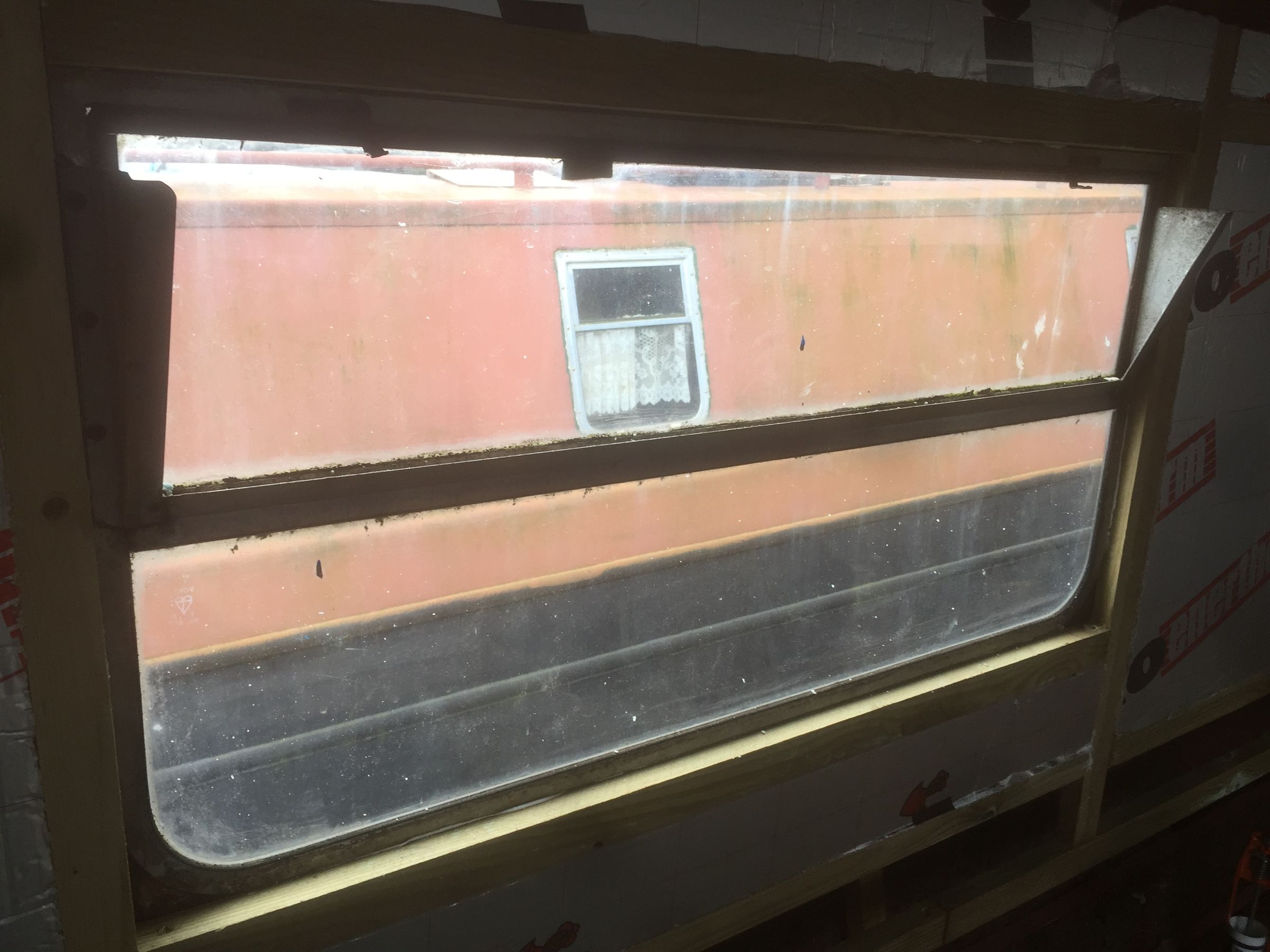

Rory_d Posted March 13, 2019 Author Report Posted March 13, 2019 If you look at the second and the fourth photo you can see the rubber insert is totally split in the corners. Thats the seals that need replacing
WotEver Posted March 13, 2019 Report Posted March 13, 2019 Even if Seals Direct don’t sell your exact seal I’d have thought you’d be able to fashion something from what they do sell. Mitred corners on rubber profiles can be very effectively glued with cyanoacrylate (buy a decent one) but obviously it’s fiddly. You really only have three options that I can see... 1. Fashion a seal from what you can get. 2. Close all the windows up and seal them. 3. Replace the windows. 2 is obviously a bad idea, you can’t afford 3, so that only leaves 1.
Tony Brooks Posted March 13, 2019 Report Posted March 13, 2019 I have used self adhesive close cell neoprene strip on mine. I think its something like 4 or 5 mm thick and about 7mm wide but it comes in a dumber of different sizes. Just take care how you cut it for the corners. I have also glued U section rubber nearly all the way along the hopper bottom edge.

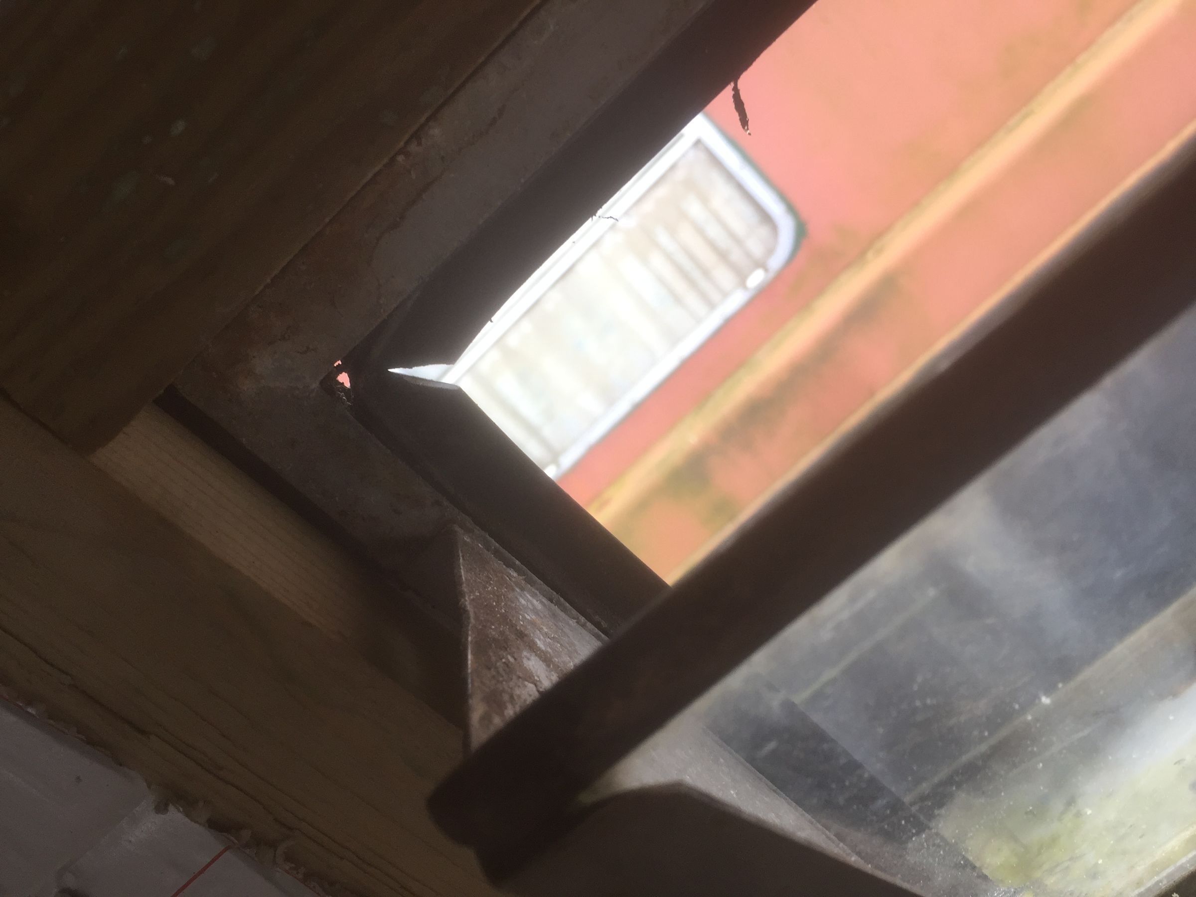

matty40s Posted March 14, 2019 Report Posted March 14, 2019 Ok, looking again at the pics since you havnt posted any better ones (a picture is worth a thousand words unless it's a crap picture) .... The seals aren't split they are cut, it's a single flat seal piece which has a V cut at where the corners are going to be. The seal has slipped/stretched over time and is no longer flush to the corner so the more has opened. As others have said, the window still shouldn't leak if the angle is properly joined. You may have a lot of moss/growth at the base of the louvre which can let water seep inside. Blocked bottom drains are the most usual cause of water staying in the boat though.
Rory_d Posted March 14, 2019 Author Report Posted March 14, 2019 The lower seals are all perished that seal the lower fixed glass section and there is like has just been said a lot of moss etc in the middle sections, i did however find a bundle of 8 windows that are seven years old on eBay so have just bought them and will just replace all the windows in the boat, theory being that as the windows aren’t that old it should be a piece of cake to find who manufactures them. the seller thinks they are channel glaze or Caldwell’s , the item number is : 202624115205 does anybody know know who makes these ones? If so I will ring tomorrow and get the spares for them then hopefully can get them fitted next week
