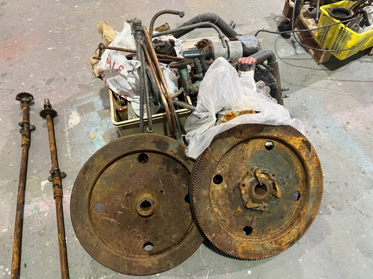

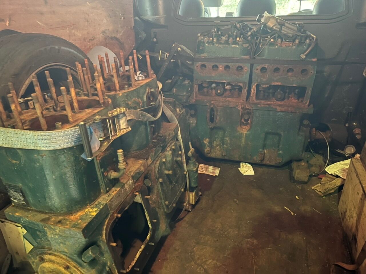

  3. These engines have resurfaced, will add them to the queue for rebuilding, they have suffered a bit from standing for 9 years or so since their removal

    The cylinders I have don’t look too bad, until you start digging. Full of internal corrosion and lots of loose scale, they’re both cracking from the bottom up. I have tried welding, with stainless wire in the MIG and using cast rods with the inverter, but it’s very porous and fragile. I’ve considered chemical metal as a last resort but as I’ve got so many other new parts it would be a shame.

    my experience with seaward is that you can drive up there with a pocket full of cash and still come away with nothing, I have some spares for the K and J but no castings unfortunately, I do have a box of bits to drop off with Phil Robins with a cylinder in it. I have some new piston ring sets for the earlier pistons and .030 U/S Main bearings How bad are your current cylinders? I have welded some Kelvin cylinders for both the poppet valve engines and my F4 in my boat. Tom
