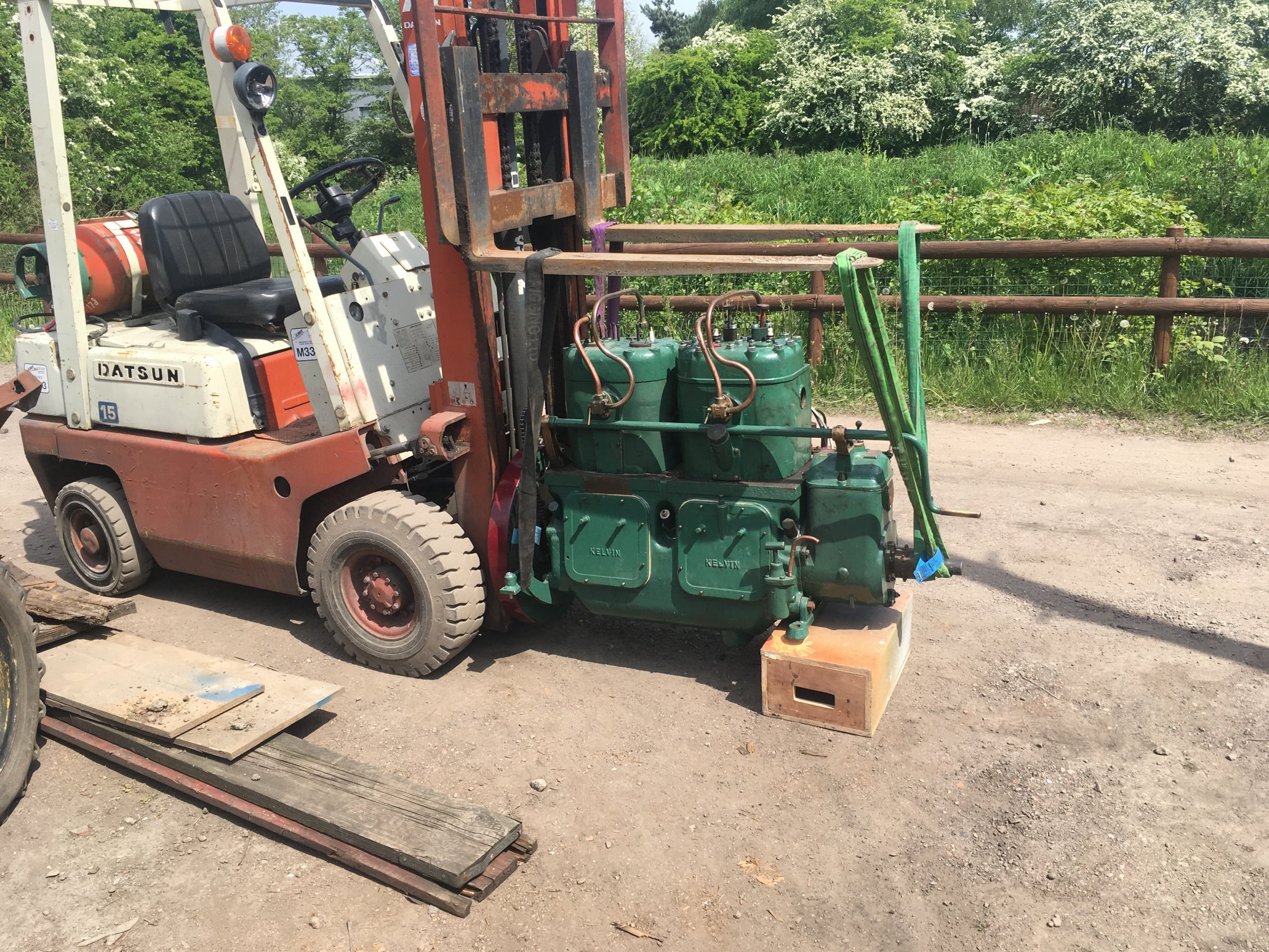

  1. I can’t imagine many people would want that dynamo, it is unusual in being chain driven from the flywheel end, I’m not sure there are that many Fowler marine engines around now, the list can’t be that long….

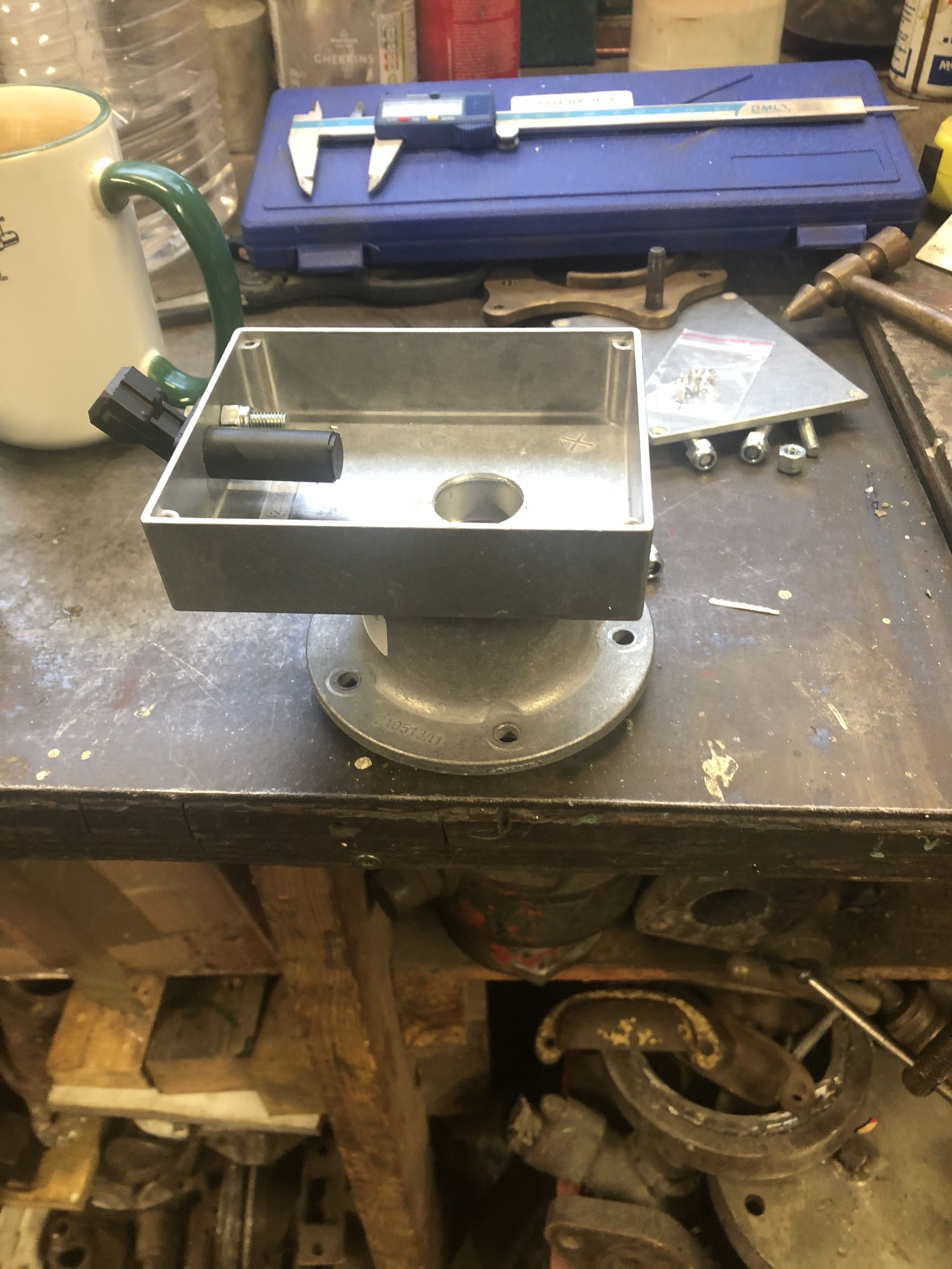

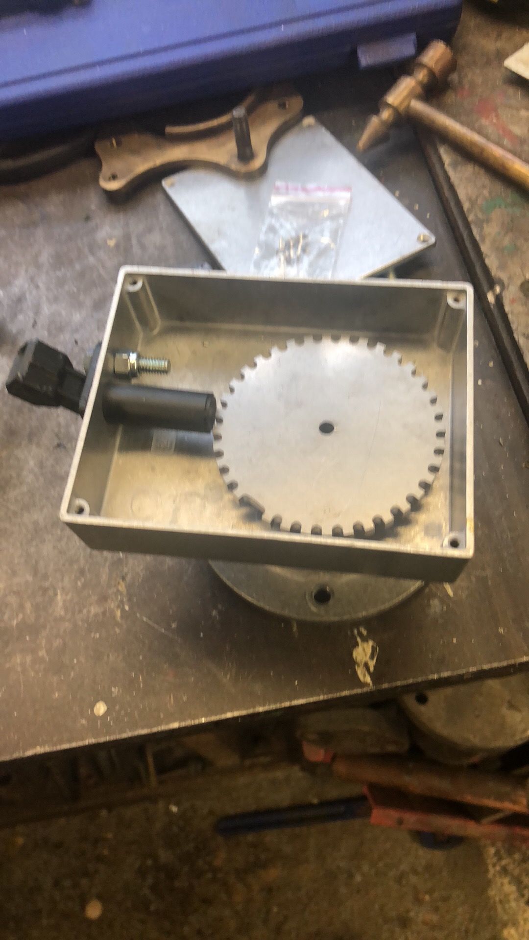

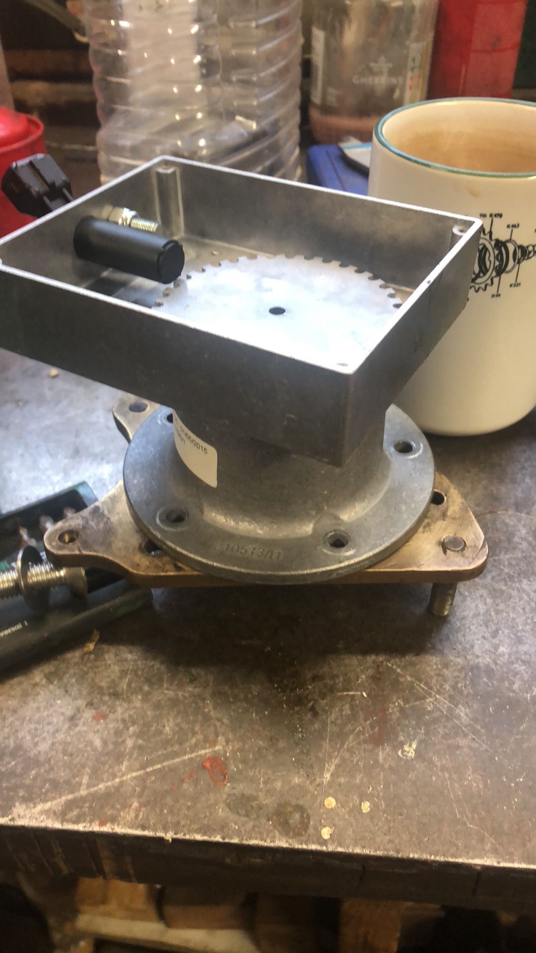

    The round flanged piece is a hub from a large fan, it just happens to be about the right size to fit the mounting. I have quite a few of them. I am keeping a magneto as a spare but they are not the most reliable of things. With this system I will be able to have multiple sparks for each firing stroke but still retain the manual ignition timing control the whole system will have cost less than a magneto ht coil rewind! Tom

    Sorry for the long delay since the last update, today I started on the electronic ignition system to replace the magneto, this will use a trigger wheel and a sensor and bolts in place of the magneto. Just awaiting the the arrival of some bearings and can then assemble and fit to the engine. Tom

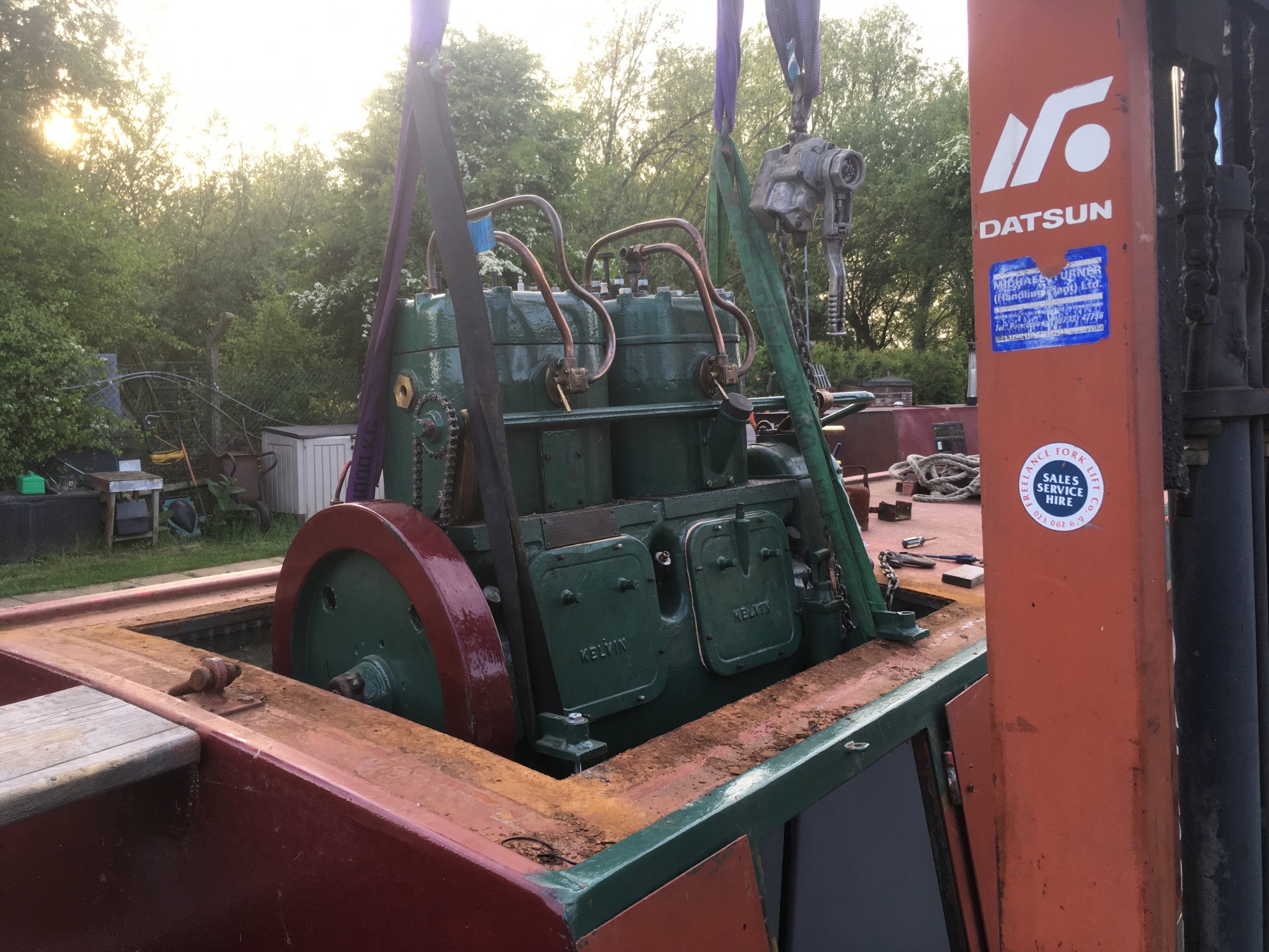

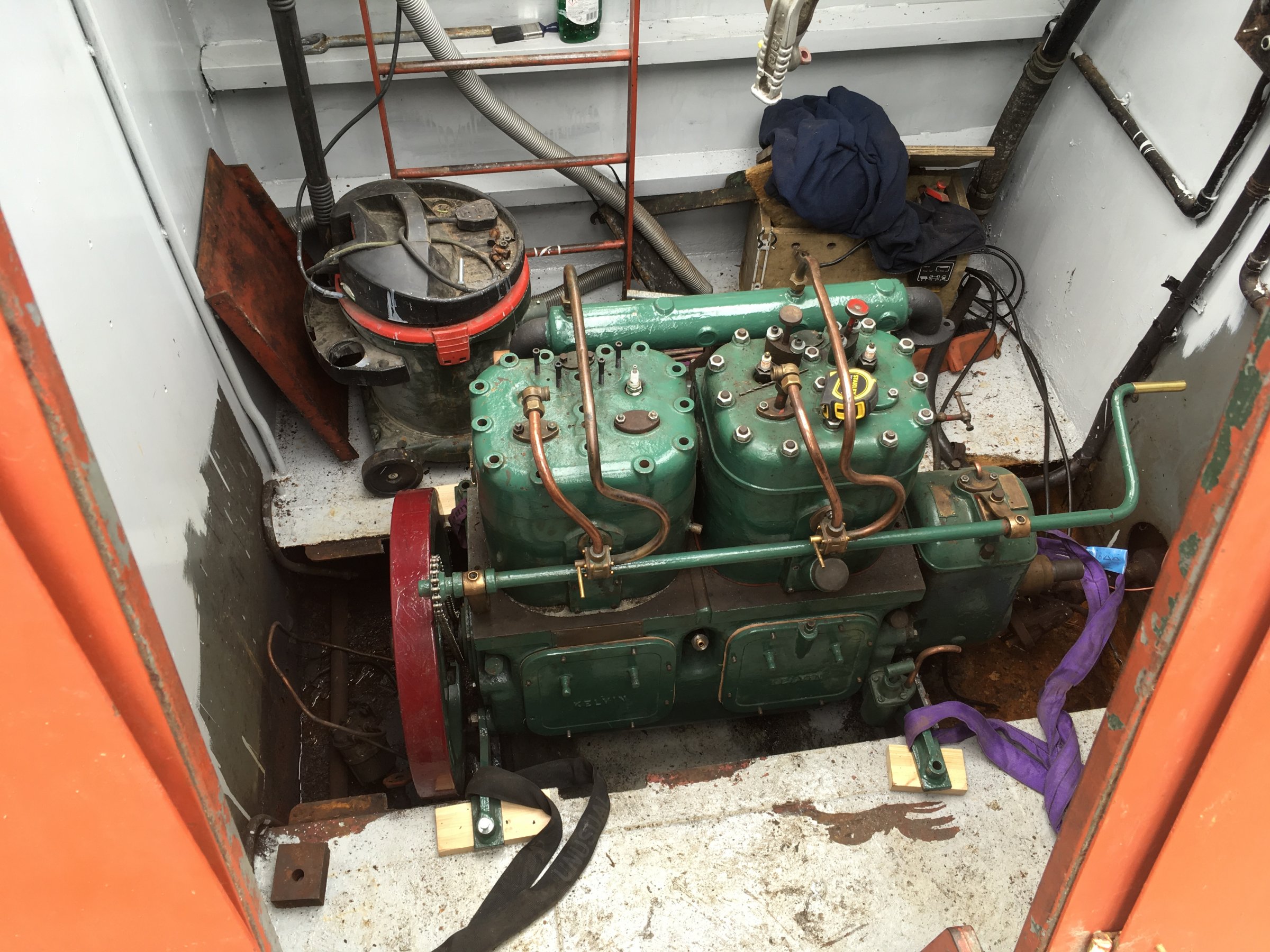

    Progress has been slow over the last couple of months, but the engine is roughly in position in the boat, next step is aligning it with the shaft then I will start on the fuel tanks and plumbing
