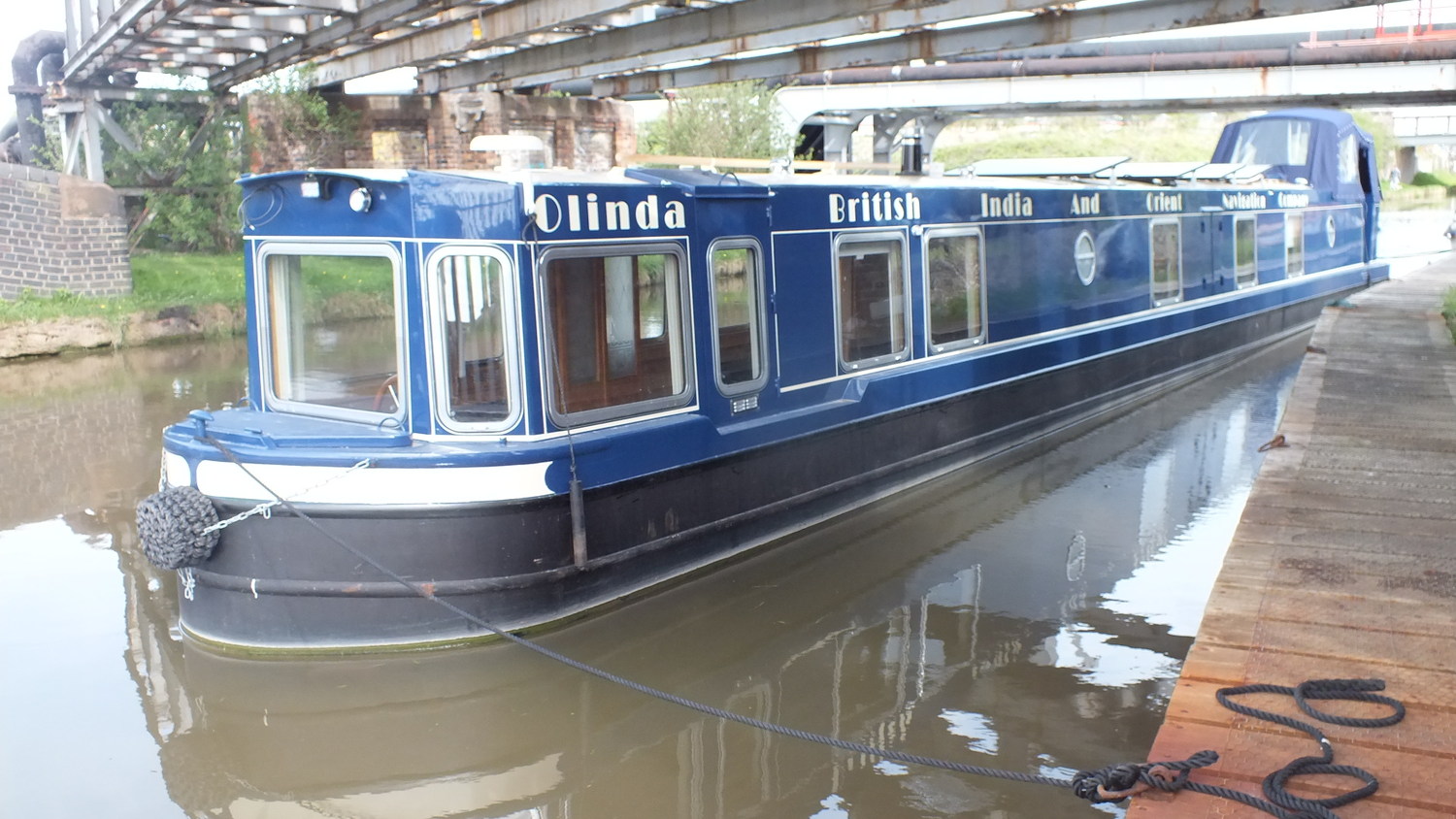

11 hours ago, TheBiscuits said:
No, Olinda was a very specific custom boat for Norman - he basically wanted a floating railway carriage, and that is exactly what he got.
Oh, and note the forward steering wheel just visible - it does get about in all weathers!
It would be an interesting boat to sail single handed!
Up to the lock landing,sprint the half mile to the stern before it drifts away from the bank,tie up,get soaked from the rain,[you would steer from the stern if the weather was good] set the lock,get even wetter,take the boat into the lock steering from the stern this time,tie up and close the lock,and cast off and sprint through the boat to the forward helm,dripping water and leaving muddy footprints in your nice new boat.
It's very nice,but,it will never replace the boat.:giggles:
It's OK, he has an automatic lock operating mechanism.
She makes a fine cuppa as well. :giggles:
