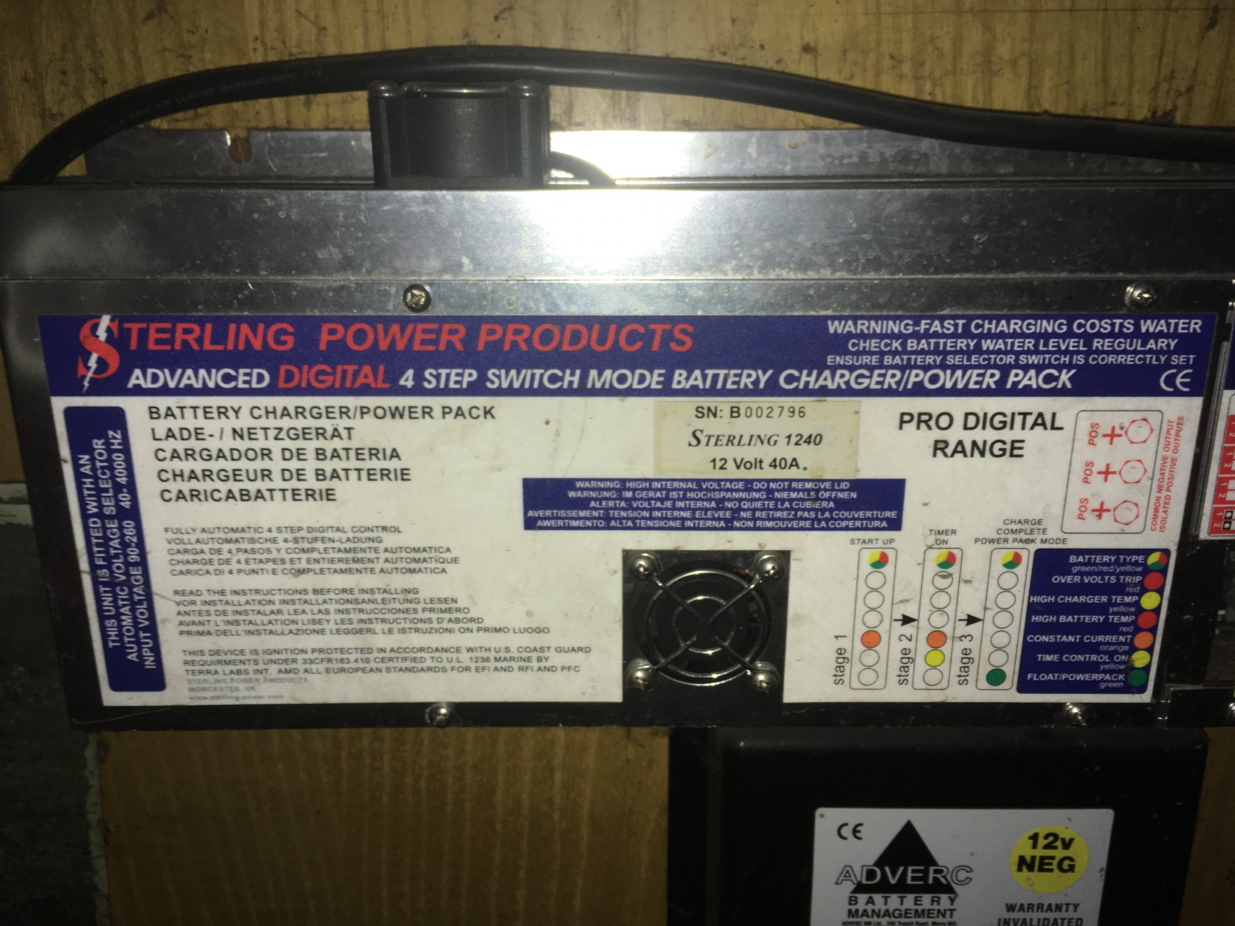

23 minutes ago, Dave_P said:
This is my battery charger. Any thoughts?
the battery type selector is set to unsealed lead acid
I'm not a lead-acid battery expert, but to my scant knowledge bot the above items should / could cope with your charging needs -
I have the same model as your Sterling charger and it works hard for me (mine's a 25 amp @ 24V) and I have an Adverc for when cruising. I'm a fan of both; but then I'm a leisure boater.
Even if you're a high power user, having the charger on 24/7 should make a good or better contribution to your charging regime - but something in the back of my mind says you have some really power hungry  appliances that are on for long periods in the day? I'm also wondering whether your batteries have become goosed during the summer season where the engine use and solar haven't kept pace with your daily use and have degraded to the point of you noticing it.
Recent discussions have pushed the minimum battery capacity far beyond your 330 Ah and towards 1,000 Ah. I suggest and extra battery / or a capacity of 400 - 500 Ah would be better. It's not only a question of capacity but also the discharge rate and you may be taking quite high current out of your pack and cheap leisure's just can't cope.
Perhaps other will come back and demolish my arguments - but it's worth starting yet another discussion!
