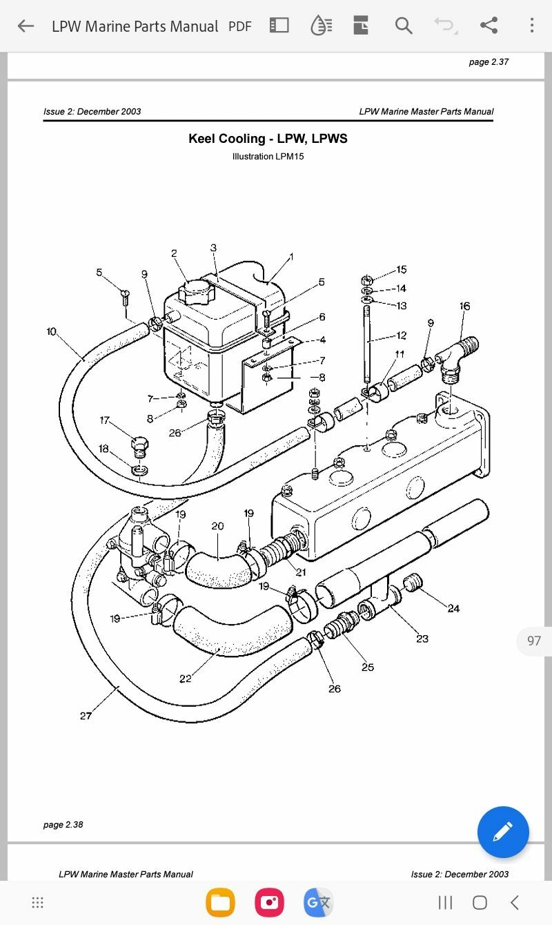

David Mack Posted June 29, 2023 Report Posted June 29, 2023 8 hours ago, SiFi said: I believe it's overheating because the temperature alarm goes off and the expansion/header tank cap is losing water and the first time billowing steam. Takes about 25-30 minutes from cold. The calorifier and skin tank and all the pipes get very hot. There is one thing that puzzles me. When the engine is running hot the top half of the skin tank gets really hot but the lower half never gets so hot that you can't touch it. I would think that this cooler water would be enough to stop the engine from overheating. So the hot water from the engine is able to get to the calorifier and the top of the skin tank, possibly just by convection within the pipes, so there can't be too much of a blockage in the top half of the circuit. But the water isn't circulating properly. So either there is a blockage in the bottom half of the circuit, or the water pump is not actually circulating the water. Do we know the water pump is actually working?
Tony Brooks Posted June 29, 2023 Report Posted June 29, 2023 Just now, David Mack said: So the hot water from the engine is able to get to the calorifier and the top of the skin tank, possibly just by convection within the pipes, so there can't be too much of a blockage in the top half of the circuit. But the water isn't circulating properly. So either there is a blockage in the bottom half of the circuit, or the water pump is not actually circulating the water. Do we know the water pump is actually working? OR something is allowing coolant flow to bypass the skin tank to some degree.

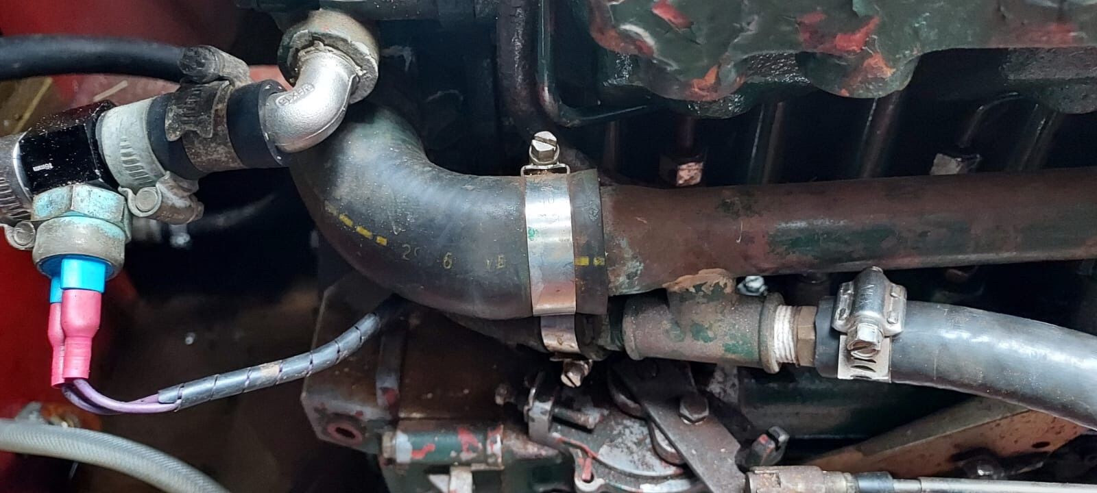

Steve56 Posted June 29, 2023 Report Posted June 29, 2023 6 minutes ago, jonathanA said: just to be clear that picture is my lister NOT Si-Fi's. which is this one and not the proper lister part in use, hence the temp switch in the pipe, don't see why that would matter. Does seem to me to be a flow problem - perhaps a faulty stat or wrong stat ? I suspect the issue with the expansion tank could be overfilling ? As you say not the correct Lister part, but would make no difference to the operation.
SiFi Posted June 29, 2023 Report Posted June 29, 2023 27 minutes ago, David Mack said: So the hot water from the engine is able to get to the calorifier and the top of the skin tank, possibly just by convection within the pipes, so there can't be too much of a blockage in the top half of the circuit. But the water isn't circulating properly. So either there is a blockage in the bottom half of the circuit, or the water pump is not actually circulating the water. Do we know the water pump is actually working? That is the question I keep coming back too, conflicted between what can stop a pump and how do you check? 22 minutes ago, Steve56 said: As you say not the correct Lister part, but would make no difference to the operation. I am going to check the overfilling this morning and if I can fit a temperature gauge
Steve56 Posted June 29, 2023 Report Posted June 29, 2023 One thing that could give an indication of pump operation. If you have the standard set up as per diagram remove the filler cap and run the engine up to a relatively fast speed. You should then see a steady trickle of water being returned to the tank via hose number 10.

SiFi Posted June 29, 2023 Report Posted June 29, 2023 (edited) 3 hours ago, Steve56 said: One thing that could give an indication of pump operation. If you have the standard set up as per diagram remove the filler cap and run the engine up to a relatively fast speed. You should then see a steady trickle of water being returned to the tank via hose number 10. Thanks, this useful Edited June 29, 2023 by SiFi

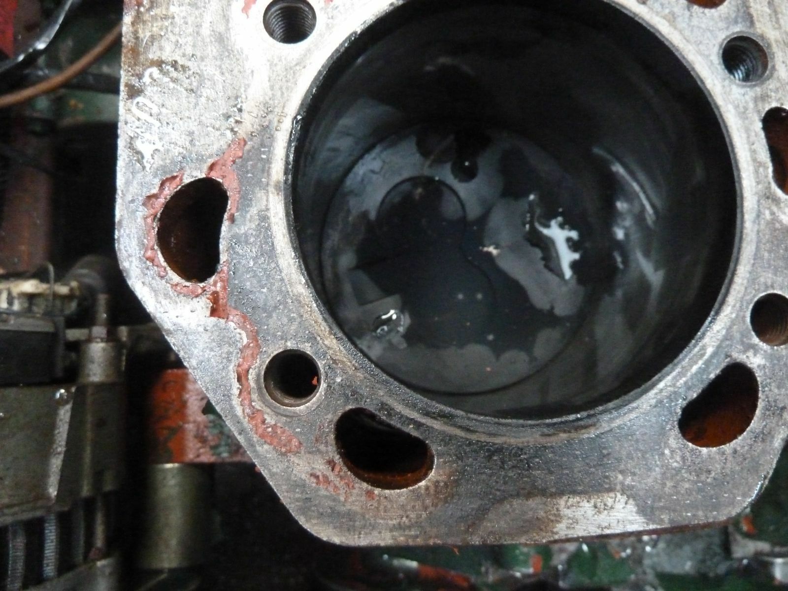

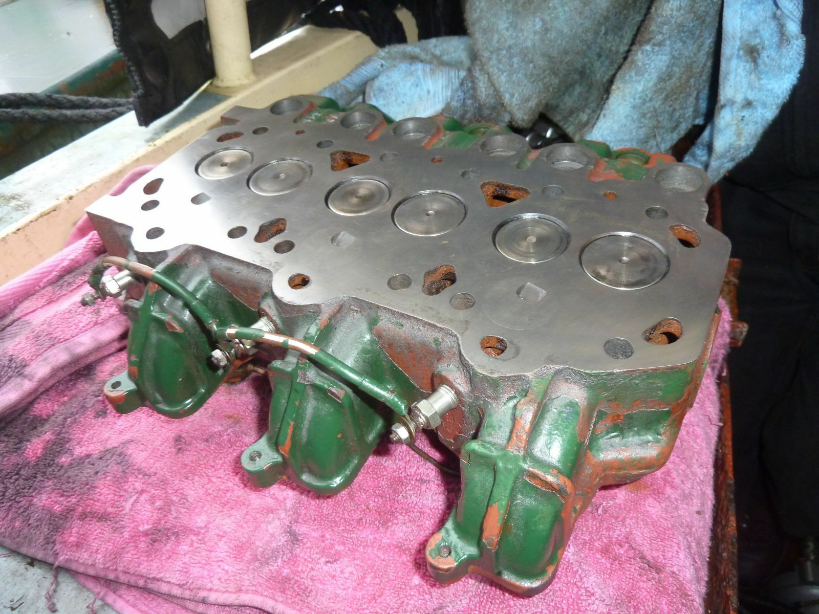

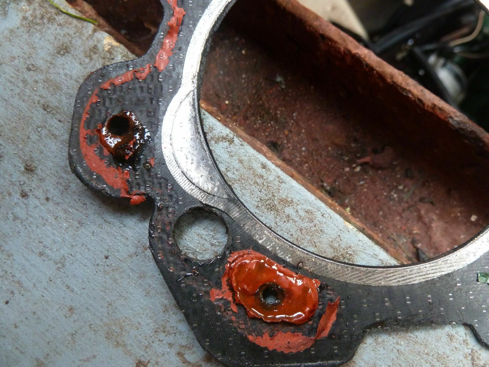

Psychalist Posted June 30, 2023 Report Posted June 30, 2023 23 hours ago, Tracy D'arth said: revving, with a combustion bubbler in the place of the header cap I feel your frustration. I went through this process with our LPWS. It's annoying to have so many possible causes and contributing factors. In my case, analysis over a frustrating few months finally revealed a head gasket leak. Initially a little coolant was blowing out the top of the header tank but only when the engine was hot and under reasonable load. Over time this degraded to happening under light load but never at tickover. I'm surprised your engine overheats after only 30 minutes as it usually takes about 15 minutes to warm up. What I learned was: Combustion leak testers might work but didn't show anything for me. The black pressure cap has a bronze coloured disc under a hole on the underside. Mine was faulty and it was possible to blow through it. This wasn't possible with a new replacement (Land Rover) from ebay. The Land Rover header tank isn't the most suitable as there are a couple of problems: 1) Volume insufficient for coolant expansion from a decent sized skin tank - I run mine almost empty, which results in full on a longer run. 2) the pipe from the exhaust cooler enters just under the cap which results in some coolant loss as the air being expelled drags some of the bypass coolant out with it. A common solution is to replace it with a larger higher version (Renault seems a popular choice) - I didn't do this . Conclusive evidence of a combustion leak only manifest after removing the head. This was the action of last resort as it is obviously the most expensive. It showed gasses were passing the gasket on cylinder 1. The cause was re-use of stretch head bolts from a recent rebuild. News ones should always be used.
SiFi Posted June 30, 2023 Report Posted June 30, 2023 Thanks for this, what I don't understand is why a head gasket leak, even a small one produces an overheat. Is it simply that it drives out the coolant?
Tony Brooks Posted June 30, 2023 Report Posted June 30, 2023 7 minutes ago, SiFi said: Thanks for this, what I don't understand is why a head gasket leak, even a small one produces an overheat. Is it simply that it drives out the coolant? One reason is that the gas will be at between 200C and 700C depending upon lead and power. A small leak should not drive out coolant because it should collect at a high point and vent - if a facility for it to vent is provided. So in most skin thanks there is no vent, so a gradual build up of gasses will just push the coolant level down.
Psychalist Posted June 30, 2023 Report Posted June 30, 2023 In my case the gassing was not obvious as there were no excessive bubbling in the coolant though the feed from the exhaust cooler did seem to be quite actively passing coolant. My problem was I didn't know what was normal as the boat was new to me. Mainly the symptom seemed to be over pressure and the header tank venting. As it progressed over the months, there did seem to be more bubbling whilst under load - I spent quite some time observing it under the deck boards whilst cruising. The engine didn't overheat until it finally got bad enough to stop circulation, probably through a mixture of cavitation and air lock. There's no saying SiFi's situation is the same but it does bear some similarities. Some pictures follow, that I had meant to upload on a previous thread on this topic. Peugeot106 was particularly interested in the head and the absence of oil galleries across the head gasket. (Oil to the valves comes via the pushrods). Here's the arrangement of the calorifier connection. The spare wires are from the loom for a temperature gauge (not fitted). Temperature switch is on the end of the T piece at the top of the picture. This is the gasket after the head was removed. The carbon staining around the bore is the evidence of a compression leak. And this is the corresponding part of the engine block. Finally, the head, skimmed and cleaned:

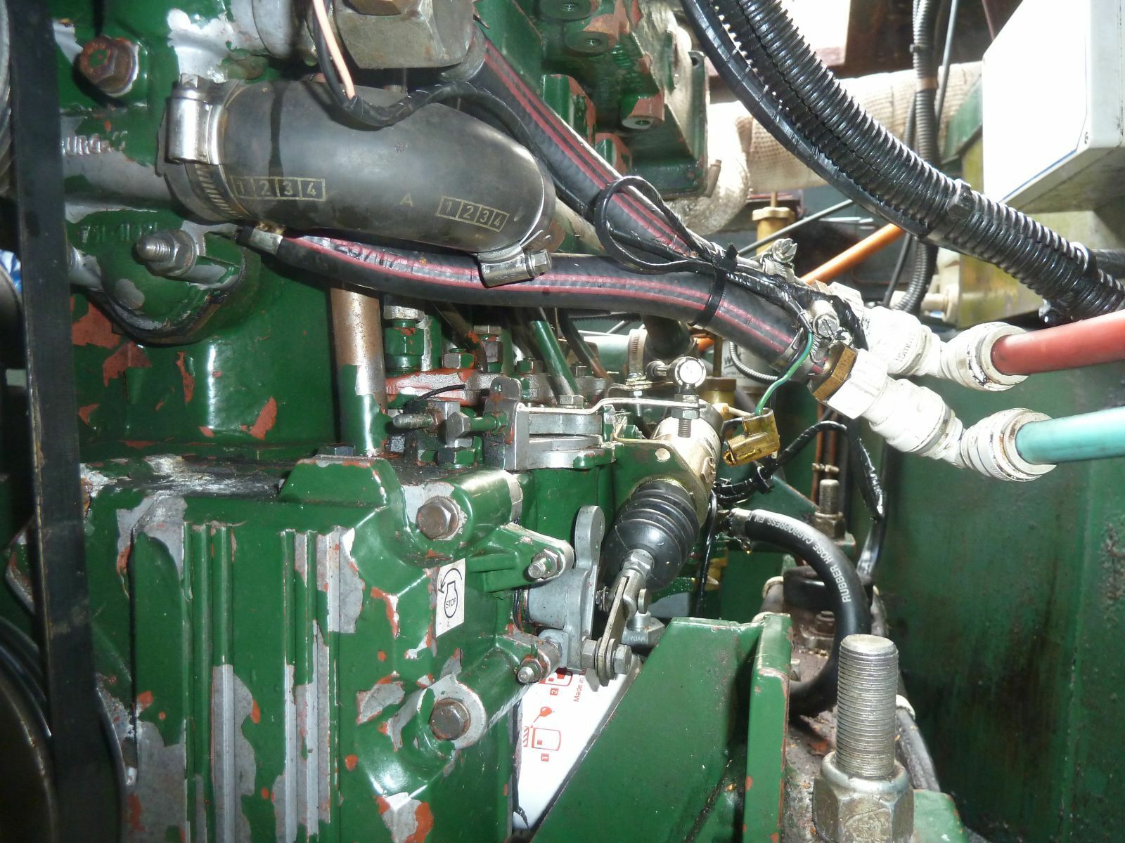

SiFi Posted June 30, 2023 Report Posted June 30, 2023 22 hours ago, RLWP said: We are starting to see LPW engines where the spring that joins the rack to the governor breaks - the hook on the end of the spring wears through. Makes the engine sort of uncontrollable Richard That's interesting, I have come to a similar situation where I am suspecting the rack and governor. Today I have started to remove the end cover to just be sure that they are still linked and working.
Peugeot 106 Posted June 30, 2023 Report Posted June 30, 2023 11 minutes ago, SiFi said: That's interesting, I have come to a similar situation where I am suspecting the rack and governor. Today I have started to remove the end cover to just be sure that they are still linked and working. If it’s on the just have courage. i replaced the speeder o ring and the speeder spring with the help of mirrors, fisherman’s forceps, torches and string with the engine still on the boat against the bulkhead . I did first get some practice in on a spare engine in the dark jammed against my shed wall with the lights out first! to be honest I doubt very much this is your problem I would leave the governor well alone you can gat into all sorts of problems with it including runaway. My problem was a very small oil leak which started to do my head in. Please look elsewhere first
