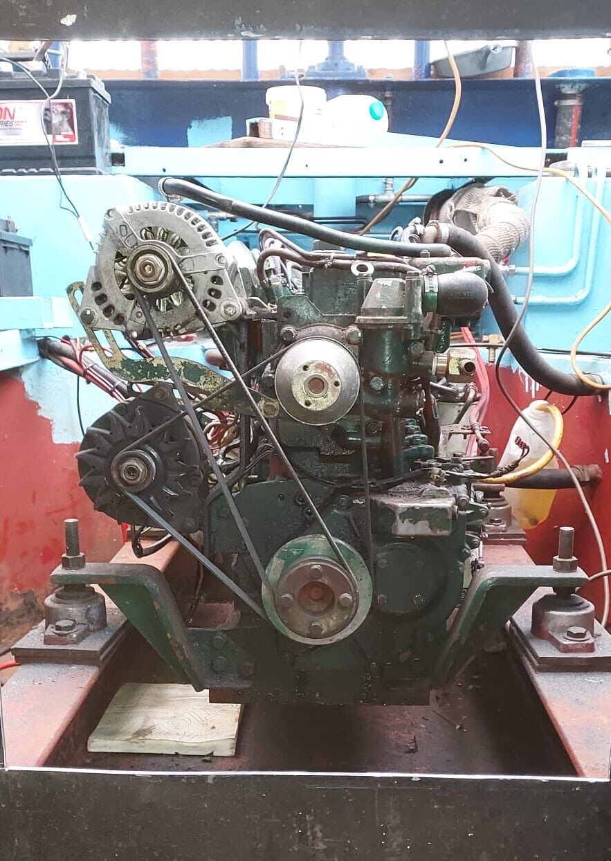

SiFi Posted June 30, 2023 Report Posted June 30, 2023 I have had the cover off before when I had two injection pumps gummed up and the rack would not move at all. The reason I suspect it might be the cause of the sudden non-starting is that the engine stop lever has no resistance to rotation, it feels disconnected. To get at it I had to cut an access hole in the bulkhead. 1

SiFi Posted July 1, 2023 Report Posted July 1, 2023 https://youtu.be/MjLDBd-EtBo This is what I found, not a broken spring.
Peugeot 106 Posted July 1, 2023 Report Posted July 1, 2023 8 minutes ago, SiFi said: https://youtu.be/MjLDBd-EtBo This is what I found, not a broken spring. Your best bet is RWLP at this stage. Everything should move smoothly it is easy to bend the rack if the pumps are not fitted properly . Read the manual there is an explanation on how to fit the pumps on YouTube somewhere. Have your hand or something available to block the air inlet if it takes off. It may be your only means of stopping it
SiFi Posted July 1, 2023 Report Posted July 1, 2023 Who or what is RWLP ... i was very careful, following the manual, when i had the pumps out, they had been gummed up. I'm hoping it is not the rack but one of the pumps being stiff. Is there a way back if it is the rack?
Peugeot 106 Posted July 1, 2023 Report Posted July 1, 2023 2 minutes ago, SiFi said: Who or what is RWLP ... i was very careful, following the manual, when i had the pumps out, they had been gummed up. I'm hoping it is not the rack but one of the pumps being stiff. Is there a way back if it is the rack? RWLP is a specialist lister repair and parts man. Google primrose engineering you’ll see how he fixed my engine! And get his contact details. also I’ve found video re pumps for you. Google YouTube MEP 802A - LPW2 injector pump. It’s quite good. good luck at least the bits are available and not not too daft pricing. I’m sorry my manual and parts list are not to hand cbheck all the springs are there and the pump spigots are correctly located in the rack slots. You could just take them out (one at a time) to check they are free I still don’t get why this could cause overheating. Do you have 2 separate problems? all best You can easily buy a new rack if it’s bent or straighten yours
David Mack Posted July 1, 2023 Report Posted July 1, 2023 1 hour ago, SiFi said: Who or what is RWLP @RLWP should attract his attention.
Peugeot 106 Posted July 1, 2023 Report Posted July 1, 2023 More thoughts. The back of the rack slides in and out of a hole in the crankcase. Always seems a bit crude. But if you pull the rack out too far it will come out of the hole and not slide back in Check its correctly in its sliding hole (I know it’s awkward to see) I dob’t think you’d get the cover on if it was out but it’s worth checking. also check the sliding hole isn’t full of gunge same as you say the pumps were
Steve56 Posted July 1, 2023 Report Posted July 1, 2023 2 hours ago, SiFi said: https://youtu.be/MjLDBd-EtBo This is what I found, not a broken spring. Looks like one or more of the pumps are gummed up or tight. That's about the oly thing that would make the rack that stiff.
SiFi Posted July 1, 2023 Report Posted July 1, 2023 (edited) 8 hours ago, Peugeot 106 said: RWLP is a specialist lister repair and parts man. Google primrose engineering you’ll see how he fixed my engine! And get his contact details. also I’ve found video re pumps for you. Google YouTube MEP 802A - LPW2 injector pump. It’s quite good. good luck at least the bits are available and not not too daft pricing. I’m sorry my manual and parts list are not to hand cbheck all the springs are there and the pump spigots are correctly located in the rack slots. You could just take them out (one at a time) to check they are free I still don’t get why this could cause overheating. Do you have 2 separate problems? all best You can easily buy a new rack if it’s bent or straighten yours Yes sorry I do now have this second seemingly unrelated problem. How straightforward or not is replacing the rack it looks devilish. I'm hoping the rail can be removed and checked without removing all the other mechanism around it. Edited July 1, 2023 by SiFi
RLWP Posted July 2, 2023 Report Posted July 2, 2023 18 hours ago, SiFi said: Who or what is RWLP ... i was very careful, following the manual, when i had the pumps out, they had been gummed up. I'm hoping it is not the rack but one of the pumps being stiff. Is there a way back if it is the rack? Me! Richard

SiFi Posted July 10, 2023 Report Posted July 10, 2023 On 01/07/2023 at 14:19, Peugeot 106 said: RWLP is a specialist lister repair and parts man. Google primrose engineering you’ll see how he fixed my engine! And get his contact details. also I’ve found video re pumps for you. Google YouTube MEP 802A - LPW2 injector pump. It’s quite good. good luck at least the bits are available and not not too daft pricing. I’m sorry my manual and parts list are not to hand cbheck all the springs are there and the pump spigots are correctly located in the rack slots. You could just take them out (one at a time) to check they are free I still don’t get why this could cause overheating. Do you have 2 separate problems? all best You can easily buy a new rack if it’s bent or straighten yours I discovered that I need a new pump. The spring has broken in two places. I am hoping this will explain why the engine went down hill so quickly and refuses to restart. The pump is one from Delphi.
RLWP Posted July 10, 2023 Report Posted July 10, 2023 23 minutes ago, SiFi said: I discovered that I need a new pump. The spring has broken in two places. I am hoping this will explain why the engine went down hill so quickly and refuses to restart. The pump is one from Delphi. Or you need a spring Richard On 06/07/2023 at 04:15, Steve56 said: Personally I would always remove them and squeeze in a vice to ensure all the old oil was out of them. Then they spring back to full length It's much easier to follow the other instruction in the manual and wait 30-45 minutes before trying to turn the engine over after fitting them. In practice, unless your in a race pit it takes longer than that to reassemble the engine to the point it will run Richard
Steve56 Posted July 10, 2023 Report Posted July 10, 2023 15 minutes ago, RLWP said: Then they spring back to full length It's much easier to follow the other instruction in the manual and wait 30-45 minutes before trying to turn the engine over after fitting them. In practice, unless your in a race pit it takes longer than that to reassemble the engine to the point it will run Richard Yes they do spring back when you release them. But this will not cause any problems as there is no oil in them. They will only operate again one the oil has circulated through them. I like to do it this way just for the sake of clearing out any dirty/contaminated oil.
SiFi Posted July 10, 2023 Report Posted July 10, 2023 39 minutes ago, RLWP said: Or you need a spring Richard I did wonder about trying to find a replacement spring, do you have one?
Peugeot 106 Posted July 10, 2023 Report Posted July 10, 2023 Sounds like you now know what you are shooting at which will be a relief just after a brief search can these people help if Richard can’t, They refurb lister petter injectors MPS Vintage Diesels. Blandford Forum
RLWP Posted July 10, 2023 Report Posted July 10, 2023 6 hours ago, SiFi said: I did wonder about trying to find a replacement spring, do you have one? If i can find an old pump, yes. I'll have a look Richard
