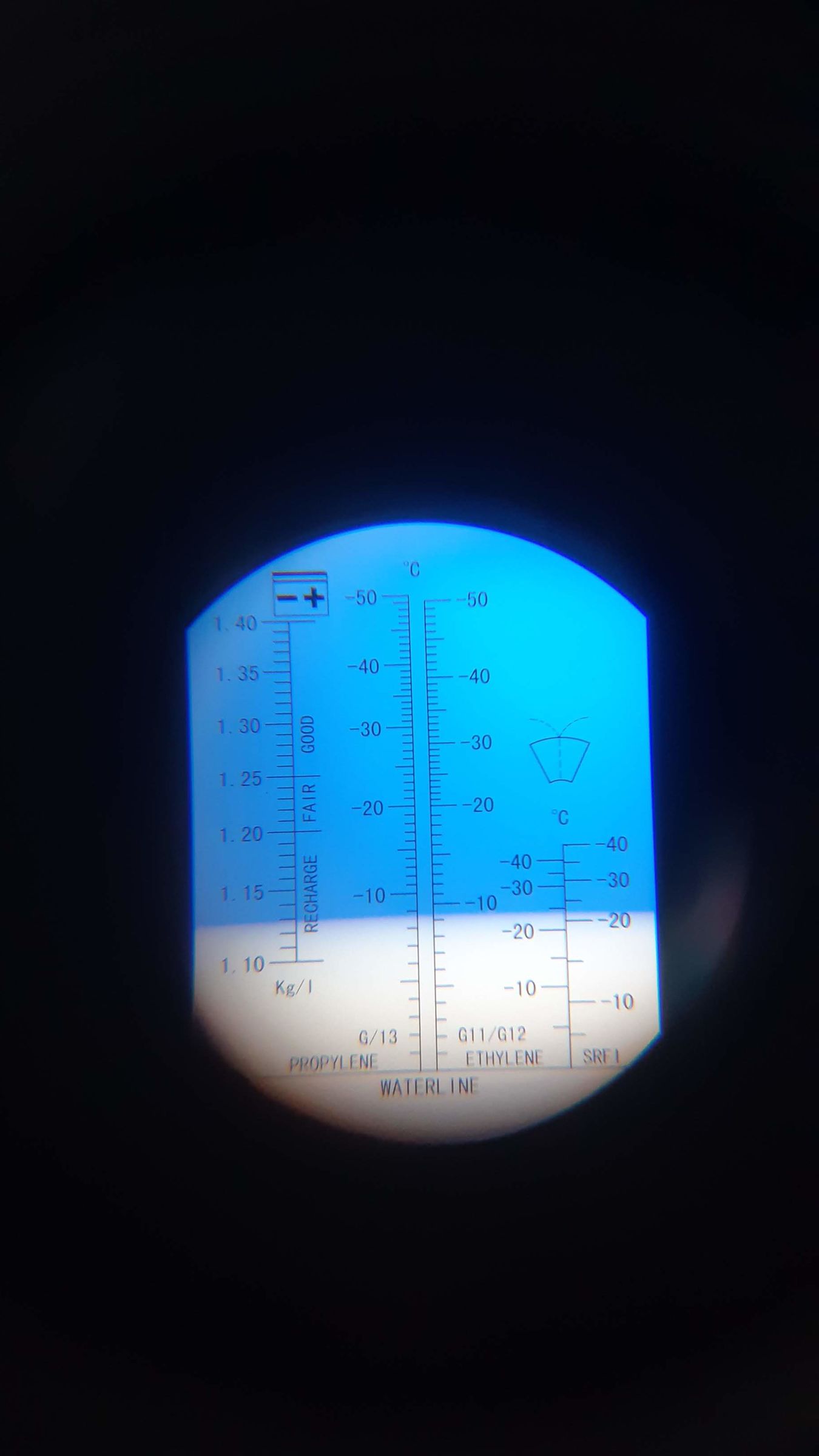

Tim Read Posted October 12, 2020 Report Posted October 12, 2020 (edited) I found a refractometer good for checking coolant ( see attached ). But I wondering if I don't need to add some sort of biocide. Some signs of growth in the header tank and I needed to bleed most of the radiators ( air - or CO2/CH4 from bugs ? ). Anyone put a biocide in their heating system ? Edited October 12, 2020 by Tim Read Photo size
Chewbacka Posted January 10, 2021 Report Posted January 10, 2021 On 12/10/2020 at 22:49, Tim Read said: I found a refractometer good for checking coolant ( see attached ). But I wondering if I don't need to add some sort of biocide. Some signs of growth in the header tank and I needed to bleed most of the radiators ( air - or CO2/CH4 from bugs ? ). Anyone put a biocide in their heating system ? If your circulation pipes are plastic and don’t have a barrier layer, oxygen can diffuse through the pipe walls encouraging corrosion of rads and possibly helping ‘bugs’ to grow. Copper on the other hand is a natural biocide.
