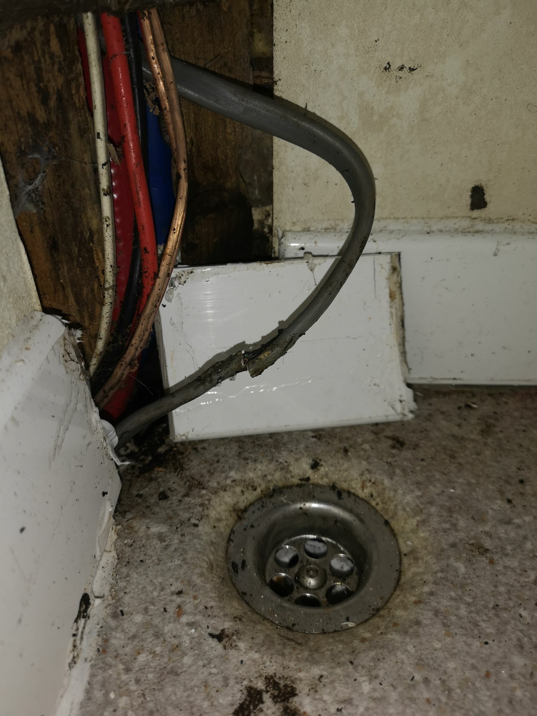

  10. Well.... perseverance paid off! Replaced both MCB's, the 16A was very corroded. Opened up all fittings, all good but still shorting somewhere. Put my meter on continuity and there's a short across live and earth. Disconnected all fittings, tested each run of cable. Eventually found the problem cable, physically traced what I could get to and there's a split in the insulation and scorching :-). Cut the cable, put a connector in and sorted. Put everything back together and... tripped again aaarrgghhhh. Decided there must be another meltdown on that cable, bought new cable... Boom fixed... frustrating job but hey electricians are selective so no choice. BUT.... having previously removed and Sikaflexed two windows, we turned up today and find 2" water on the cabin floor, devastated as we'd gone through trouble and expense of lifting boat, moving a Hull fitting and gel coating some crazing. I'd sealed the water heater flue too as that had leaked, still leaking but the rain on the Lancaster had been torrential and blowing sideways I'm told. You know the feeling of losing the will to live? Seems no matter what, each visit consists of pumping water and not cruising. And there's me thinking cruisers we're less agro than narrowboats 😞

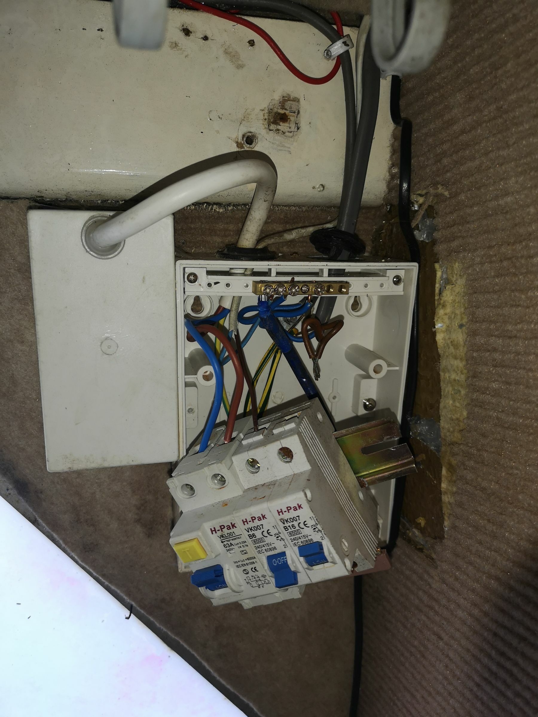

  13. Thank you, I'll bite the bullet as the pro's are all busy lol. I'll change the breakers if I can get that bottom strap off, especially the rusty one. The light fitting has an LED bulb.
  14. There are four double sockets on one breaker, the other has one light fitting. One breaker is showing a rusty screw. The pic is as far as I got because I tried pulling the link off the bottom of the breakers and it won't budge. All the fittings look good but I don't know if there's a bad connection somewhere in a cable. The boat was very wet inside when we bought her.
