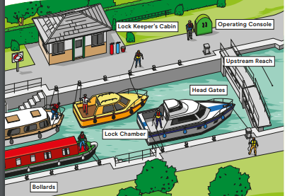

Being river based and where the locks are somewhat larger than on most canals we always have a rope on bow and  stern as per the image below.
This is unlikely to be practical if single handed but worth bearing in mind for those locks where  controlling the boat is a challenge.
If I am passing through a Thames lock unattended then I run a longish stern line to a bollard and take the bow line ashore to control the boat while Diana operates the lock.
