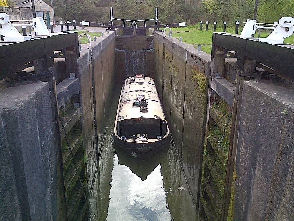

You need a longer rope!
You're gonna need a bigger boat!
1 hour ago, Scholar Gypsy said:
On the Nene, going uphill single handed, the locks can be really  quite lively. So I normally tie off the stern line at the back of the lock, and then take in the bow line while operating the paddle.  I only use one paddle as they are huge, and it is not possible to cross the top gates (you need to walk all the way round the lock).  The bow line is connected to a long light line (you can see it in a heap on the grass) which I take to the stern of the boat once the lock is full.  Then I am ready for going up the ladder at the stern, at the next lock.
I usually use both paddles as I can hop across the bow of my widebeam, but using one would be less hassle - does it take much longer to fill the locks?
My bow ropes are kept on either side of the roof so that they can be grabbed from the bank if necessary. When I enter a lock going uphill (single handed) I generally throw a stern rope up and then jump up onto the roof to throw a bow rope across. Sometimes I can step from the roof to the bank and secure both ropes, other times I have to go back to the stern and use the ladder. I don't particularly like carrying ropes up ladders as the potential for trips and accidents increases. Likewise if I'm jumping from the top of the lock onto the roof (going downhill) I throw any ropes onto the roof first and then make a very predetermined jump - often that's safer than going down a slippery ladder, but if I am using the ladder I won't be carrying a rope.
I obviously didn't jump from the top of Bath Deep Lock!

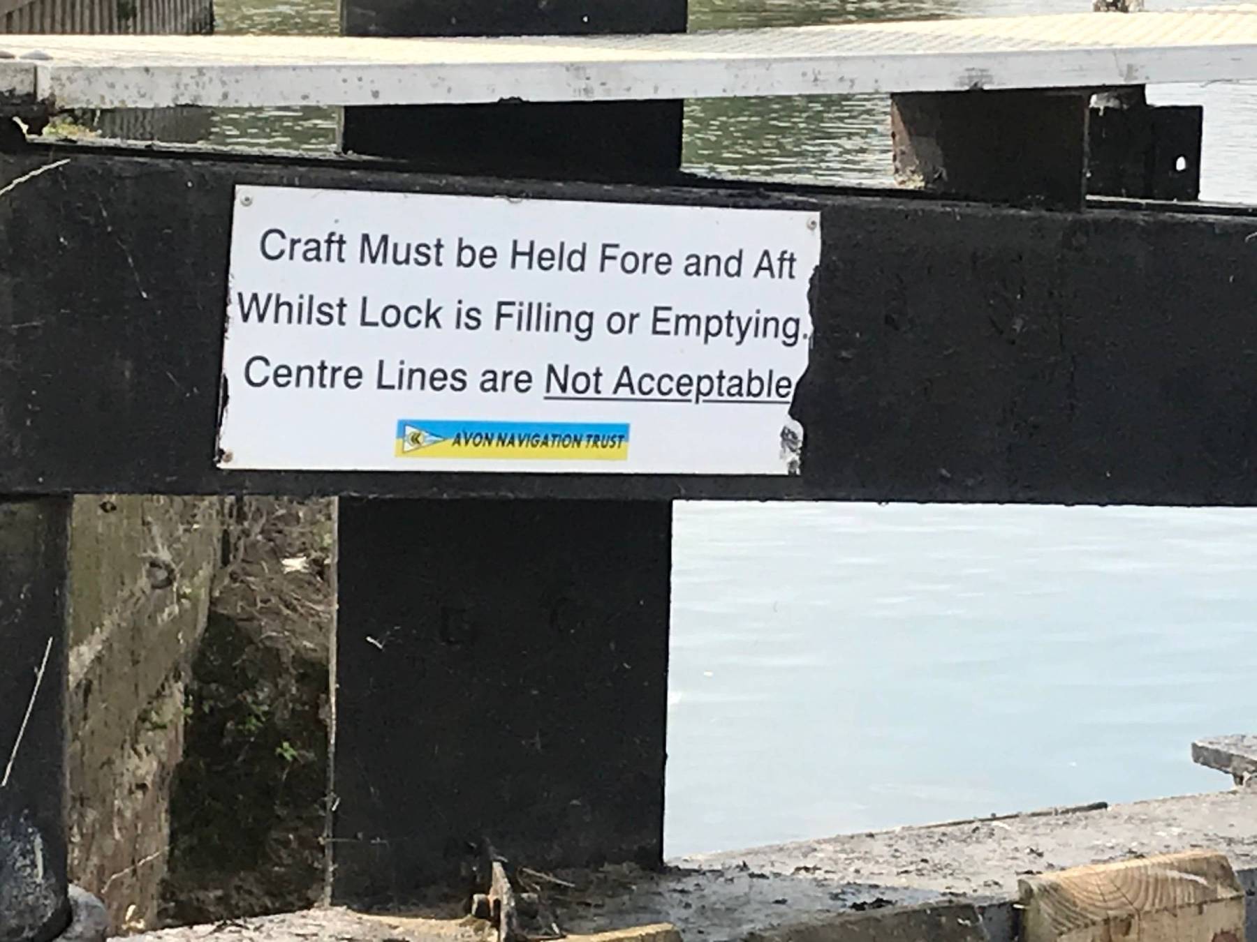

Enter lock close gates, move boat back to gates, tie off forward line backwards from bow, tiller over to side of lock that you are moored against and run engine in forward gear, then have crew member on bankside open paddles. I know of a fuel boat that always did it this way and it worked every time. This going up the locks.
This is good for the GU locks but not correct for longer boats that have to sit across the locks- in Calder and Hebble and Huddersfield Broad locks for example. Here the tiller arm should  point into the lock, otherwise it will tend to snag on the lock side especially going down. Accepting that 70+ foot fuel boats won’t fit in these locks at all!
It may not be correct in other broad locks- The Avon seems to have a mind of its own,  and note the sign at Pershore lock, not the triangular one.
