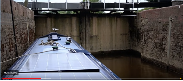

robtheplod Posted January 29, 2024 Report Posted January 29, 2024 Hi All Prior to our move to Droitwich I'm researching the locks in the Severn. When we came up Diglis lock when we did the Avon Ring i encountered exactly the same issue David does in the video below and wondered is there a correct procedure for these big locks that avoids the embarrassing pull over to the other side?
nicknorman Posted January 29, 2024 Report Posted January 29, 2024 1 hour ago, robtheplod said: Hi All Prior to our move to Droitwich I'm researching the locks in the Severn. When we came up Diglis lock when we did the Avon Ring i encountered exactly the same issue David does in the video below and wondered is there a correct procedure for these big locks that avoids the embarrassing pull over to the other side? I'm not quite sure exactly what you mean by "pull over the other side" - in the vid he just seems to struggle to come alongside on the intended side. This is caused by hitting reverse too hard - water is pushed forwards and pushes the boat away from the wall. Come in more in the centre of the lock and turn towards the wall, swing the back in just before it hits at the front, and hit reverse when you have momentum carrying you towards the side. If you come in slowly, you need less reverse and the effect is less. He was going downhill, if you were going uphill and had problems with the "pull over to the other side" when the lock is filling, it is because you started out on the wrong side! Normally the Severn lock keeps tell you which side to go if there is just the one boat, such that the water flow from the paddles keeps you on that side. Mind you, with the advent of volockies, maybe that is no longer SOP.
Jen-in-Wellies Posted January 29, 2024 Report Posted January 29, 2024 What @nicknorman said. If the issue is coming in to a lock and stopping adjacent to one wall, then the problem is similar to coming in to a bank, or quay side, where the water rushing down the side from the reversed prop pushes you away. As with coming in to a wall in general, the deeper the water is under the boat, the easier it is, so going down a lock is easier than coming up. My approach is to come in to the wall at an angle, with reverse prop, then a burst of forward prop and rudder to turn the boat parallel at the last moment, then reverse prop again to kill the last of the forward speed. If judged right, the turning moment of the boat counteracts the reverse rush of water between boat and wall and you come to a stop parallel to and close to the wall. Success! With the water rush from paddles moving the boat, the direction it comes from with each paddle depends on the design of the lock and can sometimes even reverse at a certain water depth. Local knowledge and experience will soon let you know how to deal with the quirks of the local wide locks.
dmr Posted January 29, 2024 Report Posted January 29, 2024 We had this problem, one of the top two locks heading up from Droitwich to Stourport. There was a bit of leakage from the corner of one of the top gates going accross the lock and getting between us and the wall. It was much worse than in the video and pushed the front out before I could get a rope round the riser. Also once we were roped up (on the other sde) it was a strong pull as the locked filled. Big locks need a crew of two, one driving, one at the front, and this is where you realise that a cratch cover is really bad news (and why we don't have one). Getting a front rope on to a bollard or riser and a half turn round the T stud if needed, should keep the front under control.

David Mack Posted January 29, 2024 Report Posted January 29, 2024 If there's a wind blowing across the lock, some of that will be caught by the downwind wall and will circulate within the chamber. In these locks, when full in normal river conditions, the lockside is higher than the cabin top, so the boat isn't exposed to the side force from the wind, which would push it towards the downwind side, but may be carried in the opposite direction by the circulating airflow, in the same way as when filling a lock from one side only the current takes the boat towards the side with the open paddles. 1

Wanderer Vagabond Posted January 29, 2024 Report Posted January 29, 2024 Have to say that I rather looked with horror at how the guy has his centre line in the lock😱 Does he REALLY have that line around his mushroom?? If it is anything like my boat, they are not big screws holding those mushrooms on and they are very easy to rip off (DAMHIK!!)
blackrose Posted January 30, 2024 Report Posted January 30, 2024 (edited) 21 hours ago, nicknorman said: in the vid he just seems to struggle to come alongside on the intended side. This is caused by hitting reverse too hard - water is pushed forwards and pushes the boat away from the wall. Going back a step it's also caused by coming into the lock too fast when there's really no need to. If you come in dead slow then you don't need a lot of reverse to stop and avoiding all those excess revs in astern means you're less likely to get pushed away from your desired side of the lock. Moving a widebeam single handed has taught me to do everything much slower and more gently than when I owned a narrowboat. Use the boat's momentum, you don't need all those revs. Edited January 30, 2024 by blackrose 1
Bee Posted January 31, 2024 Report Posted January 31, 2024 On Bee it is dead easy to come alongside the LH wall, coming alongside the RH wall is a different kettle of fish, it takes time and careful handling or it ends up in the middle of the lock. David Macks comment about contrary winds is also something to bear in mind. Its a bit stressful for us as we get shoved into the bit of free water at the back of the commercial locks after the big stuff has filled most of the lock and pratting around whilst everybody else waits for you is embarrassing. This is when you realise that the most important person on the boat is not the person twiddling the wheel - it is the person with the rope trying to catch a bollard before the boat bounces off the wall / runs into the back end of something really big.
Momac Posted January 31, 2024 Report Posted January 31, 2024 On 29/01/2024 at 18:18, Wanderer Vagabond said: Does he REALLY have that line around his mushroom?? It appears so
Mike Coombes Posted August 1 Report Posted August 1 On 29/01/2024 at 10:30, nicknorman said: I'm not quite sure exactly what you mean by "pull over the other side" - in the vid he just seems to struggle to come alongside on the intended side. This is caused by hitting reverse too hard - water is pushed forwards and pushes the boat away from the wall. Come in more in the centre of the lock and turn towards the wall, swing the back in just before it hits at the front, and hit reverse when you have momentum carrying you towards the side. If you come in slowly, you need less reverse and the effect is less. He was going downhill, if you were going uphill and had problems with the "pull over to the other side" when the lock is filling, it is because you started out on the wrong side! Normally the Severn lock keeps tell you which side to go if there is just the one boat, such that the water flow from the paddles keeps you on that side. Mind you, with the advent of volockies, maybe that is no longer SOP. Every propeller I have ever used not only pushes water forwards, but also to either Port or Starboard, depending on its rotation. It is known as 'Prop Walk' and is a useful tool when coming alongside. We always try and come alongside Port side to. Our prop walk moves the stern of the boat significantly to Port. Our heavy, long keel 12 metre Motorsailer has a swim platform at the stern. I stand on this, looking forward and using canal calls 'steer in-steer out'. When I call 'hard astern' and she does it, the stern is magically pulled towards the dock and I step off, calling 'neutral' as I do so. I quickly attatch the stern with a short stern line to a cleat and call 'Ahead at idle'. This is quickly tightens the stern line and straightens the boat parallel to the dock. The bow line has been cunningly hung over the guardails so I can easily reach it, I then make it off so the boat is secured. Springs next, then into neutral. Took about four years/8,000 NM's to perfect this method of docking. Our boat goes about 17 tons fully loaded, watered and fuelled, has massive windage and a long keel. Wind and tide affect it dramatically. We find narrowboat handling quite easy after 17 years with long keel heavy yachts. Just returned from a four night hire with a 60 footer on the K&A. The prop walk was there, less pronounced, but still useful. Surprised not to see it mentioned in this forum.
