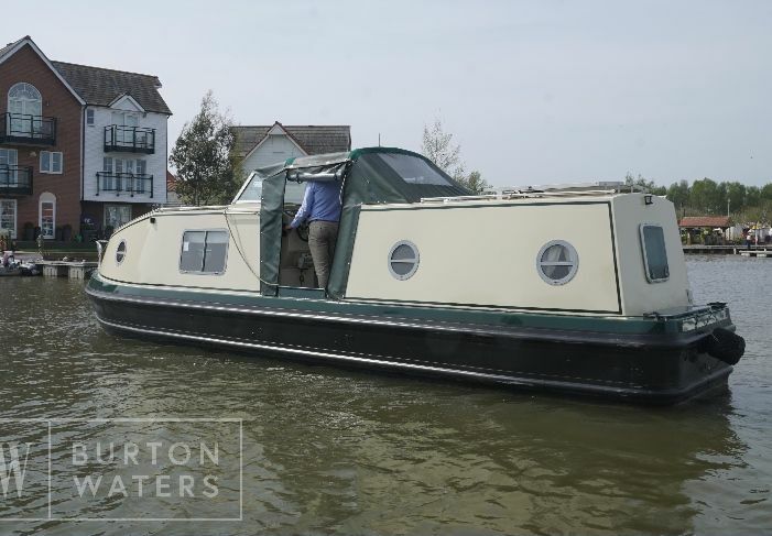

There is a risk of prop fouling when reversing and springing off a starn line if the water is shallow. clickety click on the prop.
Also if it is excessively windy and you are reversing the rudder can be put at risk depending on construction of the canal bank.
It does work but if the Boat is light, which it seems to be, it could do unpredictable things.
I would look after the rudder and starn gear on an aluminium narrow Boat very carefully.
I would find it preferable on balance with this particular Boat to get the back end into deep water as early as possible rather than encouraging it to get into shallower water.
Also I think the Sea Otters have square starns not rounded anyway.
IMG_20231218_005450.jpg.2555c4b9695b53927a06a014e07d40a9.jpgIts this Boat I believe.

Not really.
If you look a the Boat in question it is actually a very light weight craft.
If they do really want to get away from the side in windy conditions the hook could do this because it is not a heavy Boat.
