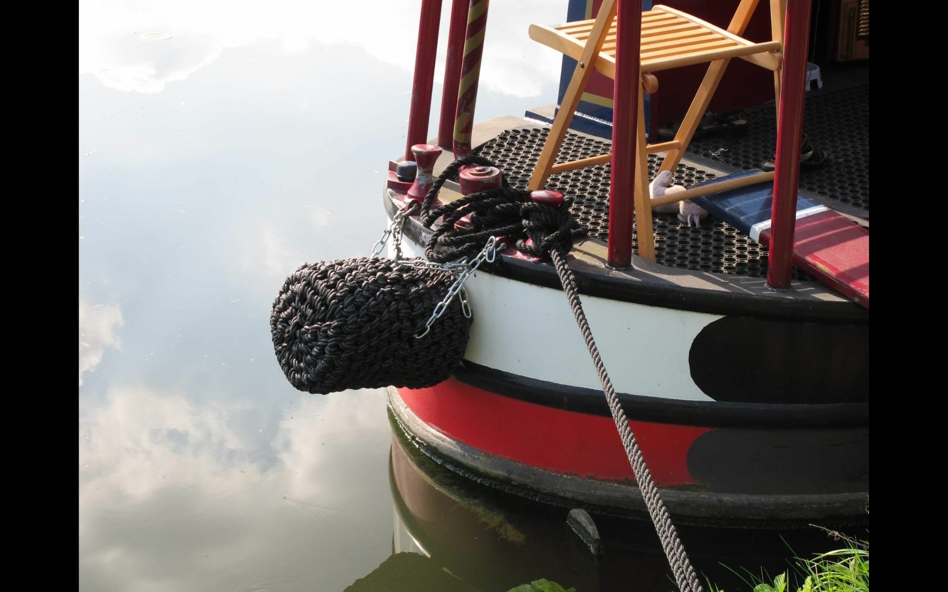

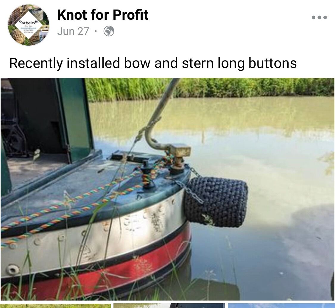

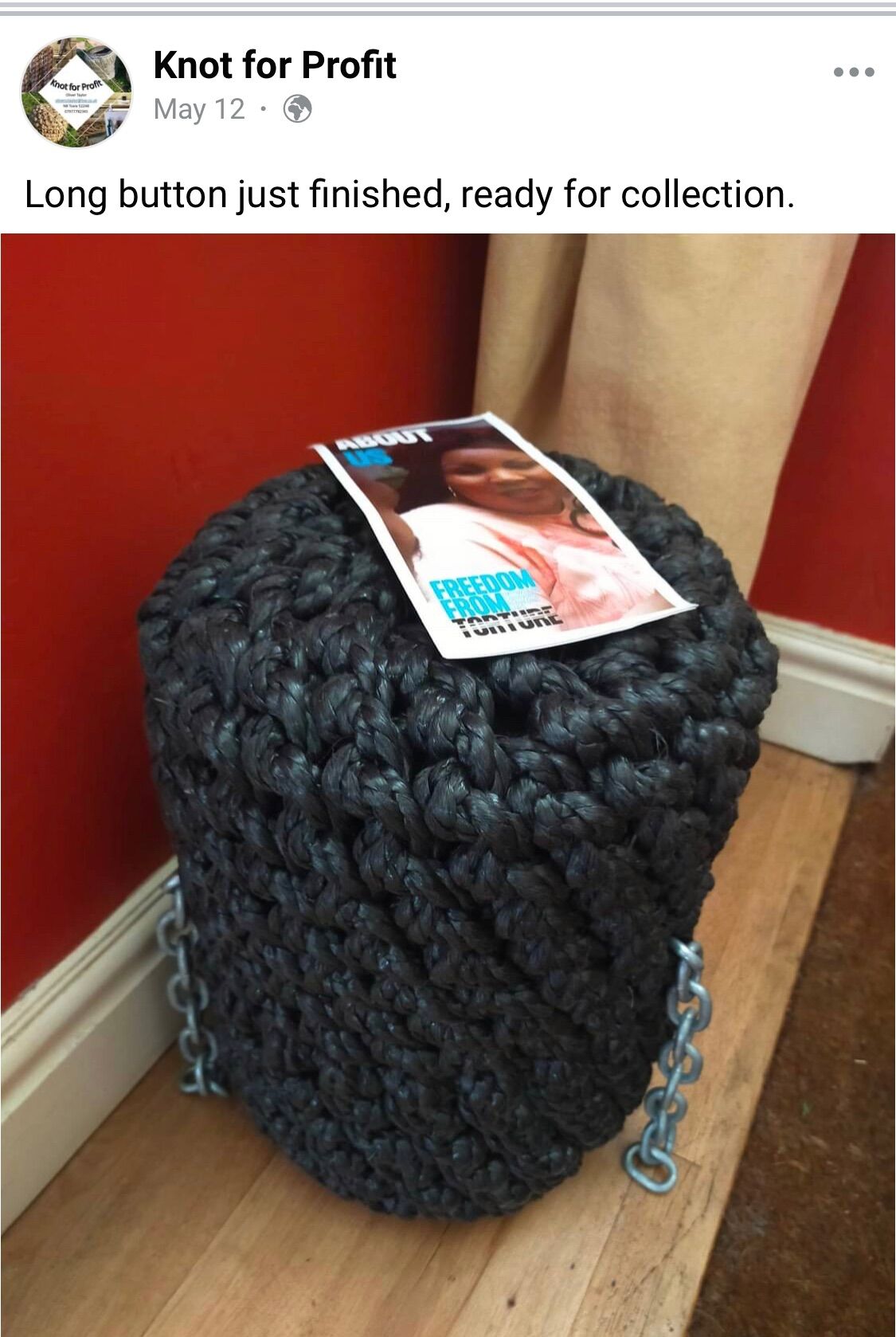

Your boat setup has four fixing points for a tipcat and button, which I can make for you (Knot for Profit Fenders). The advantage of this arrangement is that it breaks in half if you ever get stuck in a tight lock or winding hole, by simply lifting up the button. It also means the button takes the majority of the daily wear and can be replaced without changing the tipcat. And it looks so much better than a droopy long fender. I can also make this for you if you want; I use old car tyres as the core to avoid the droop, it should be 3-4" longer than your rudder.

Thats an interesting tyre.
What did it come off ?
I see its a rolled up car tyre. Thought for a minute that was the original size maybe I need specs !

Long buttons at the stern always look wrong to me. Tipcat and short button looks right.
Plus you can force a short button inside a go-kart tyre making it last much longer.

Looks very much like the one we bought from a passing boat based fender maker on the T&M
But ours had four chains.

Sounds like a good option, rudder sticks out about 8" so I'd be looking for about 11" total -- which annoyingly is exactly half-way between the two "standard" lengths of around 8" amd 14". I suspect this is too short for a tipcat plus button, so I'd be looking for an 11" four-chain button. How long would this take, and what would the cost be?

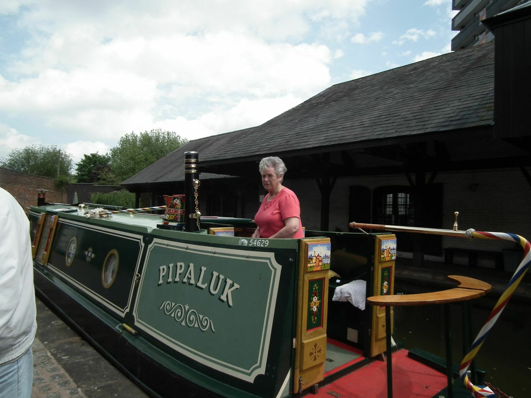

A semi trad leisure boat which belonged to retired working boaters, has all the ingredients of above.

Agreed, there was an intimation that a semi trad boat would not have a mop, a can and a chimney. Ray merely demonstrated that it was entirely possible.
