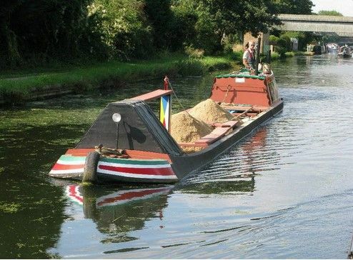

Plenty of photos of working boats show that fully loaded they're trimmed close to level with perhaps 8" of freeboard, here's one example. Can't see how unloaded the stern can be at the same level, the bows will come up a lot (up to 3' for a Big Woolwich?) but the stern will come up as well (maybe half that amount?).
I understand why the fenders are where they are on a working boat (just below deck level), but don't see why they should be that way on a modern leisure boat.
