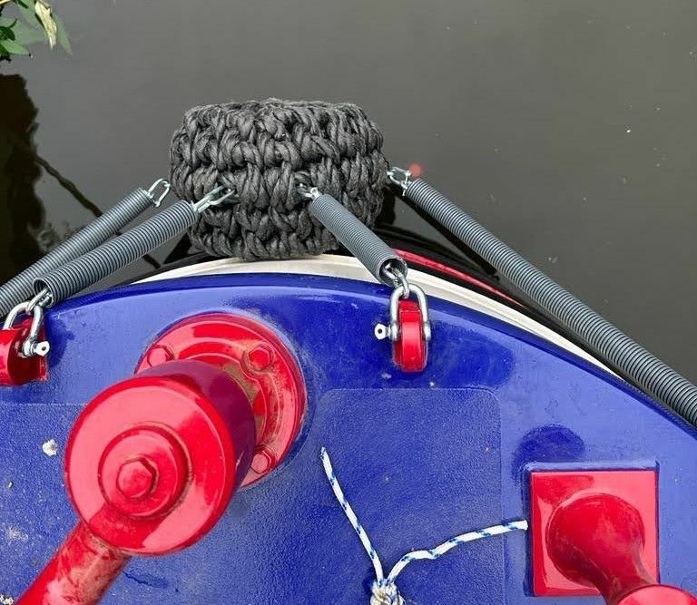

This might seem like a strange request, but does anyone know a source for a "medium-length" stern button -- in between the "short" (about 8") and "long" (about 14") ones that everyone seems to supply?
Don't really want/need the longer one (rudder sticks out less than normal, trying to avoid lifting the button in locks like Salterhebble) but the short one doesn't stick out quite far enough to protect the rudder against hitting a cill, see photo. Like Goldilock's porridge, something in between would be *just* right... 😉

Try Tradline at Braunston. They may have something but you’ll likely need to have it made to order. The good news is that they’ll make it as you want it. The bad news is that there will probably be a nine month waiting list.
They will also make you something that looks a whole lot better than that.
Edited by Captain Pegg
#3
Buy a short one and some rope and tie knots in the rope to cover the short one.

A motor  narrow boat would traditionally have two tipcats and one button fender on the stern, as in this picture from Tradline's website.
grand-union-manila-tipcats-(2)-1028-p.jp
In your case you might want just a single tipcat plus button.
But when I spoke to Tradline a few months ago they had no tipcats in stock and a waiting list of several months.
If you are happy with fenders made of plastic rope rather than manilla, other suppliers are available who may have stock or shorter waiting lists.
Or of course you could buy some rope and make your own fender of whatever size and shape you want!

We have a single tipcat and a button, just enough to stop the rudder hitting something.  We had to have two extra mounting points welded on but you appear to have four so would be ok.

I've looked at that, and it ends up about the same length or longer than a "long" button -- your rudder (and most others) almost certainly sticks out further than mine does.
#11
Why not just ask the builder to source you one and put it on, after all your paying a hell of a lot of money for a brand new boat, so to put on a small fender that doesn’t really do the job for the sake of a medium one. I would be asking the builder to replace, instead of doing their job and buying one myself.

Ricky put the short one on because I asked him to because I thought a long one would be too long. The only other size he can find is the long one, and after looking everywhere I agree with him -- which is why I asked if anyone on CWDF knew of any, but it seems not... 😞
So I'll get him to swap it for a long one, because I can't wait months for a custom one from Tradline -- assuming they can make one.

I don't think it's likely to sag or rotate, being attached by four chains not two -- the middle ones go to the top and the outer ones to the sides, like this short one.
I've had a long stern button attached by only two chains rotate round when it rubbed up a gate and end up vertically, it was a pig to get back again... 😞
