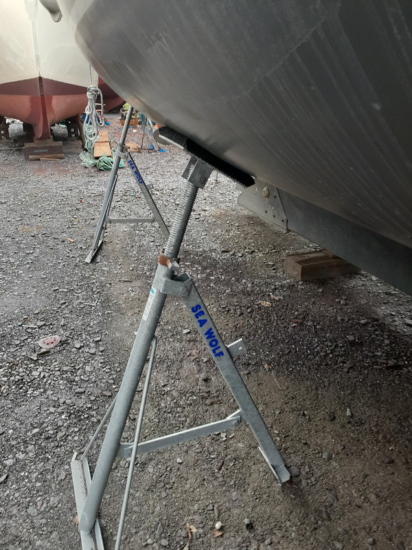

Alan de Enfield Posted August 29, 2023 Report Posted August 29, 2023 3 minutes ago, truckcab79 said: I think if it came to that we’d probably just look for another boat to be honest. The vast majority (99% ?) are V-bottom to some extent so it is no big issue to 'prop' them either with lengths of wood or cradles / stands. Our boat on steel stands and wooden pit-props.
