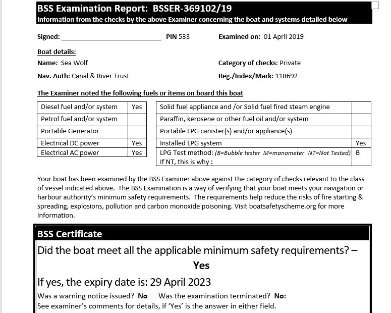

Bod Posted August 31, 2023 Report Posted August 31, 2023 On 29/08/2023 at 12:16, truckcab79 said: BSC until Feb 26. So long as it’s sound structurally none of the work phases me at all. In my day job I design and build gardens, fencing, patios, ponds, pergolas, wood fired oven. I also fit kitchens and bathrooms and restore cars and build engines. So pretty much covered on all skills and equipment including being able to stick, mig and tig weld though I have no intention of doing any plating myself if I can avoid it. My main issue will be that my business currently occupies me 7 days as week and I’m trying to take less on and give myself some weekends ‘off’. Hence the boat. In other news I think we have a Marina spot at Harefield. Complete with HS2 alongside so may be not the prettiest but conveniently placed and they sound very helpful on the phone. (According to my wife as I’m currently painting a clients house!) 😂 Cheers. Saw those last night as it happens. They’re a backstop if we need to but think we’re sorted. I may be preaching to the already converted, but narrowboats exist in a world of their own, many normal world things don't appear in the narrowboat world. 1. The current BSc will become invalid once any major work starts. Will need redoing at the end of the works. 2. Boat electrics are all negative cable return, No "earth/body work" returns. Voltage drop is far more of a problem than current carrying capacity, due to cable lenght. 3. All water systems are pump pressured, no gravity system works, even sewage has to be lifted, either by pump or muscle power! 4. Spirit levels are useless on boats, Right-angles are as rare at hens teeth. 5. The ability to work on engines will be helpful, be aware boat engines are sometimes based on very old car designs, but marinised by different companies. Each installation is unique. 6. Gas work needs doing to BSc standards, by either a "competent" person or a GasSafe engineer qualified to work on LPG systems and boat systems. The average boiler installer is NOT suitably qualified. 7. It will take at least 3 times longer and cost 4 times more than expected. Bod.
truckcab79 Posted August 31, 2023 Author Report Posted August 31, 2023 1 hour ago, Bod said: I may be preaching to the already converted, but narrowboats exist in a world of their own, many normal world things don't appear in the narrowboat world. 1. The current BSc will become invalid once any major work starts. Will need redoing at the end of the works. 2. Boat electrics are all negative cable return, No "earth/body work" returns. Voltage drop is far more of a problem than current carrying capacity, due to cable lenght. 3. All water systems are pump pressured, no gravity system works, even sewage has to be lifted, either by pump or muscle power! 4. Spirit levels are useless on boats, Right-angles are as rare at hens teeth. 5. The ability to work on engines will be helpful, be aware boat engines are sometimes based on very old car designs, but marinised by different companies. Each installation is unique. 6. Gas work needs doing to BSc standards, by either a "competent" person or a GasSafe engineer qualified to work on LPG systems and boat systems. The average boiler installer is NOT suitably qualified. 7. It will take at least 3 times longer and cost 4 times more than expected. Bod. Sounds like most of my hobbies. 😂 Funnily enough I had thought about the spirit levels. Those and laser levels are my constant companions normally. I had assumed that I’m going to just have to take 90° off the floor for everything. 😂 Great info on the neg return. Hadn’t crossed my mind that it wouldn’t be earthed via the big steel shell. 👍

MtB Posted August 31, 2023 Report Posted August 31, 2023 2 hours ago, Bod said: 1. The current BSc will become invalid once any major work starts. Will need redoing at the end of the works. This bit is only half true. The only reason you need a BSS ticket is to get a licence, and after major works nobody will know or care that major works have been carried out. The BSS ticket will still appear valid and you'll still be able to get. licence. The fun might start when it runs out and you need a new one. Or it might be fine. Depends on the BSS bod.

David Mack Posted September 1, 2023 Report Posted September 1, 2023 10 hours ago, Bod said: 1. The current BSc will become invalid once any major work starts. Will need redoing at the end of the works. No it won't. There is no process within the Boat Safety Scheme whereby an existing BSC is invalidated and can be withdrawn during its four year currency. Once you have the certificate you have it for four years, and can use it to licence the boat. There is however a requirement that any work done to the boat should comply with the scheme. You can of course get a new BSC at any time, you don't have to wait for the 4 years to be up, and then the new BSC would supersede the old one. And if work done in the meantime is compliant then getting a new certificate shouldn't be a problem (subject to the vagaries of individual examiners).

Bod Posted September 1, 2023 Report Posted September 1, 2023 1 hour ago, David Mack said: No it won't. There is no process within the Boat Safety Scheme whereby an existing BSC is invalidated and can be withdrawn during its four year currency. Once you have the certificate you have it for four years, and can use it to licence the boat. There is however a requirement that any work done to the boat should comply with the scheme. You can of course get a new BSC at any time, you don't have to wait for the 4 years to be up, and then the new BSC would supersede the old one. And if work done in the meantime is compliant then getting a new certificate shouldn't be a problem (subject to the vagaries of individual examiners). British waterways act 1983 section 7. https://www.legislation.gov.uk/ukla/1983/2/pdfs/ukla_19830002_en.pdf If this section was used more often than the infamous Section 8, then many more boats would be of concern. Bod
