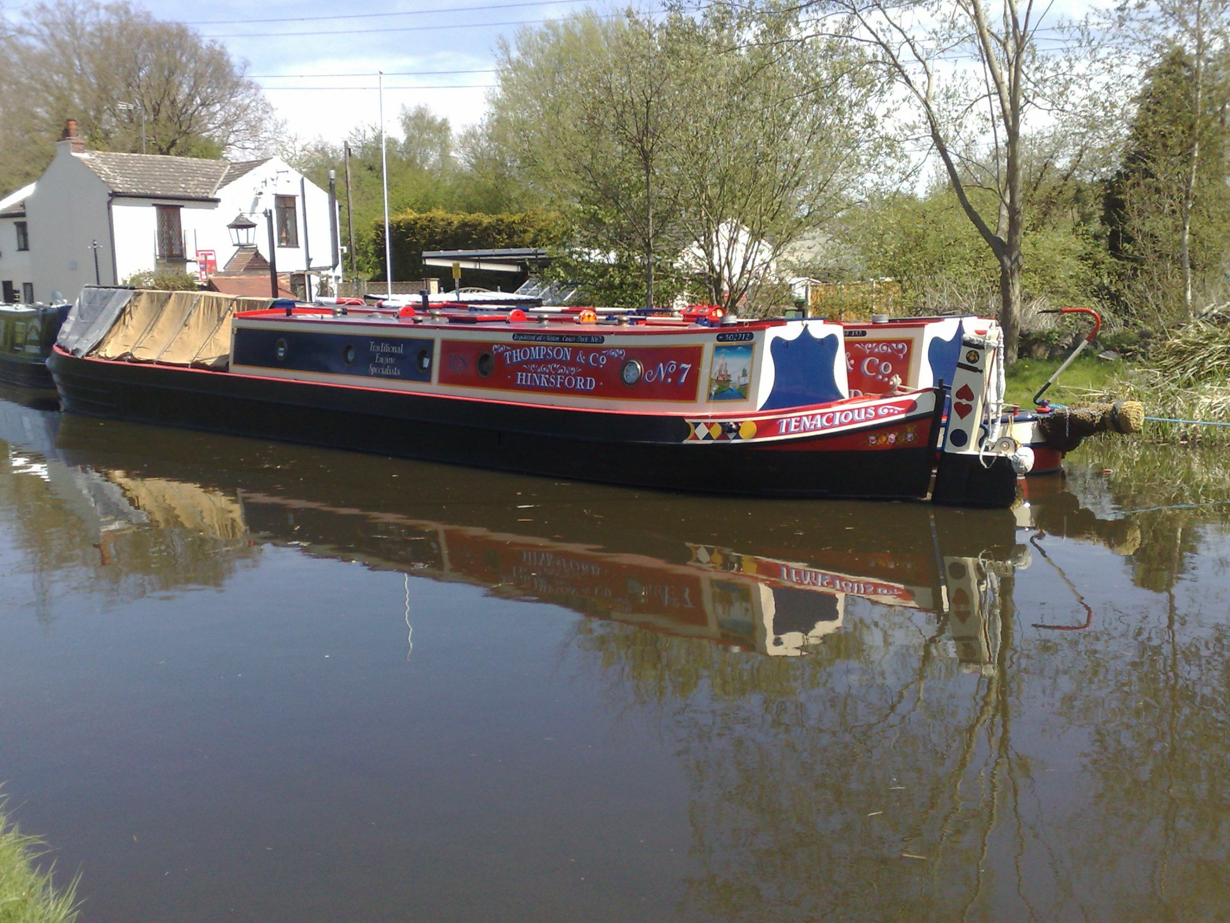

I can shed  light on this. Titan was commissioned by Dr Ian Thompson, a local canal enthusiast since the 60s. It was his 3rd boat, Malcom Braine built his first, Temeraire, then in the 90s Norton Canes built a motorised butty, Tenacious, we called it the “ mutty “ at NC. Titan was built by next door builders, CTS, the intention being to base the boat in Ireland, sadly health issues put paid to that plan and the boat stayed in the Midlands. Ian lived at Hinksford on the S&W and was heavily involved with the RN diesel engine company, hence the Trad Engine Specialists on the cabin sides. My work was on all 3 boats. Ian was a fine fellow and I mourn his passing some years ago. Family wheeled him out to the wharf shortly before his death to listen to the engines he loved so much. All 3 boats were sold later. Poor Titan.
At Hinksford Wharf when owned by Dr. Thompson, August 2013.
