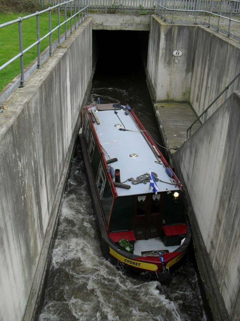

The new Lock 3E on the Huddersfield Narrow, outside Kirklees College, has been built much wider than standard - certainly over 8ft. I've no idea why.  I've tried to find a pic with a boat in it to get an idea, but can't yet.
Here we are.  This is Cygnet below the lock.  I think the lock is that wide - I don't remember any narrowing on going in.  If so, then this 'narrow' lock is over 9ft wide.

The new Lock 3E on the Huddersfield Narrow, outside Kirklees College, has been built much wider than standard - certainly over 8ft. I've no idea why. ...  a pic with a boat in it to get an idea, ...
A few thoughts on Lock 3e here and a picture of the earlier location of lock 3E (both from 2016)

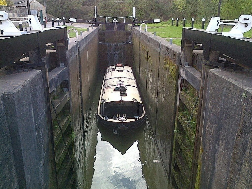

 Bath Deep Lock is just under 19 feet deep - it is user operated and thus is the deepest user operated lock on the system - it is, however, wide! Bath Deep Lock combines the fall of the former Bridge Lock (9) and Chapel Lock (8) and is more or less on the site of Bridge Lock - nothing remains of either of the old locks and one can't easily tell where Chapel Lock was other than the obvious - it was next to the Chapel you refer to.
