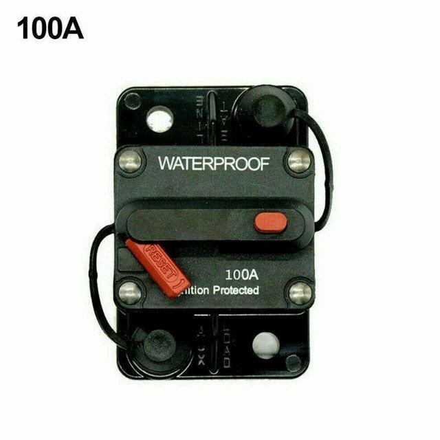

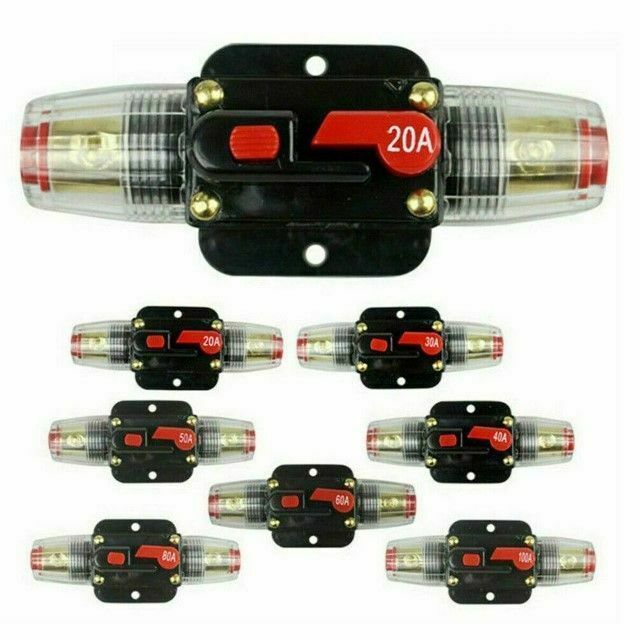

You state that you have a fuse protector, I have no idea what you mean by that. P!ease be aware that some types of breaker/ fuse sold for solar are known to be poor such as the types shown below which can givine a high resistance due to poor contacts. The high resistance vauses voltage drop so the solar controller sees a higher voltage than the batteries actually are at so it backs of the charging current. You need to check the voltage directly at the MPPT output terminals and compare this to the battery voltage. Another cause of this is if your MPPT to battery cables are too long or too thin, you state your cables are 4mm, I hope the MPPT to battery cables are much more then 4mm2 for 50Amp.
See a thread a few weeks ago which covered this very topic showing one with high resistance. https://www.canalworld.net/forums/index.php?/topic/115089-solar-controller-over-voltage-cutout-problem/#comment-2791824
Some other advice, the Victron MPPT itself will not be able to deliver more than 50A, it is limited to that, you do not need to fuse it to protect against that. Victron will recommend a 60 or 70Amp fuse (I have a 150/60 MPPT and that is 80Amp fuse), the fuse is to protect the cable in case of a short circuit.
