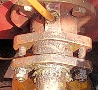

SiFi Posted June 29, 2023 Report Posted June 29, 2023 Rather than start a fresh topic I thought it might be better to tack on to the end of this one. I know it's a poor photo but does anybody recognise this gland assembly and if so do you know the size of stuffing I should get. Its on a ~1990 Colecraft.
rusty69 Posted June 29, 2023 Report Posted June 29, 2023 (edited) 13 hours ago, SiFi said: Rather than start a fresh topic I thought it might be better to tack on to the end of this one. I know it's a poor photo but does anybody recognise this gland assembly and if so do you know the size of stuffing I should get. Its on a ~1990 Colecraft. Remove gland follower, measure gap with drill bit. Measure drill bit. If you are lucky, it will be the same on each side. If you are unlucky, it will be like mine. Edited June 30, 2023 by rusty69
Tracy D'arth Posted June 29, 2023 Report Posted June 29, 2023 (edited) Impossible to be certain from the photo. Measure the diameter of the pusher, ( the bit next to the nuts ) deduct the diameter of the shaft, divide by 2 and that is the packing thickness. Likely to be 5/16" or 1/4". Edited June 29, 2023 by Tracy D'arth
