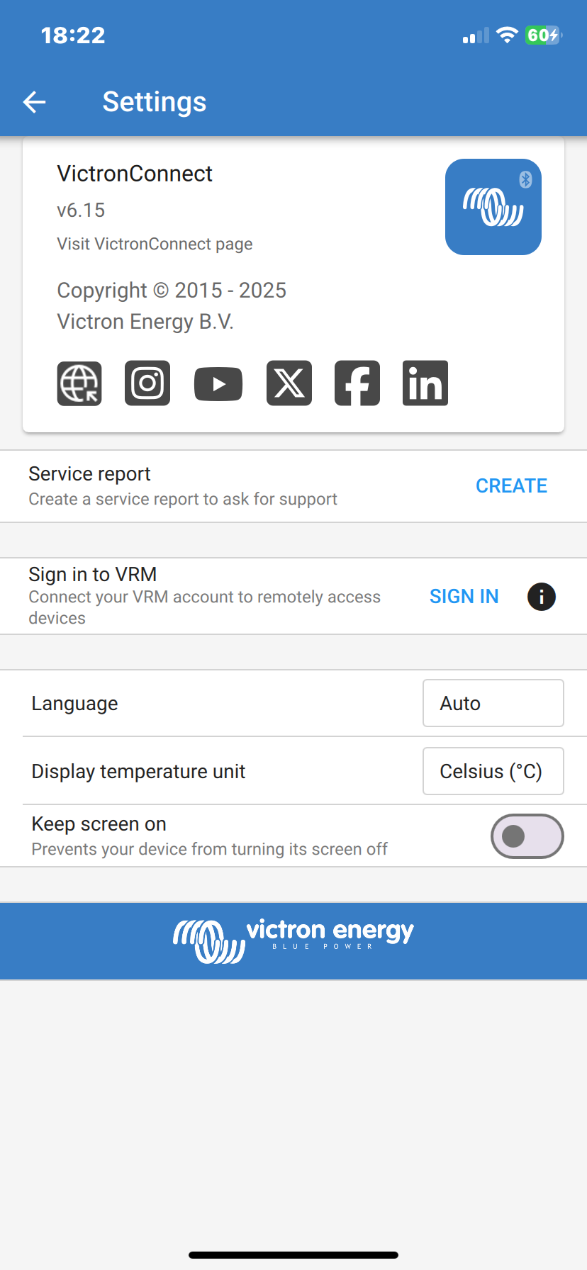

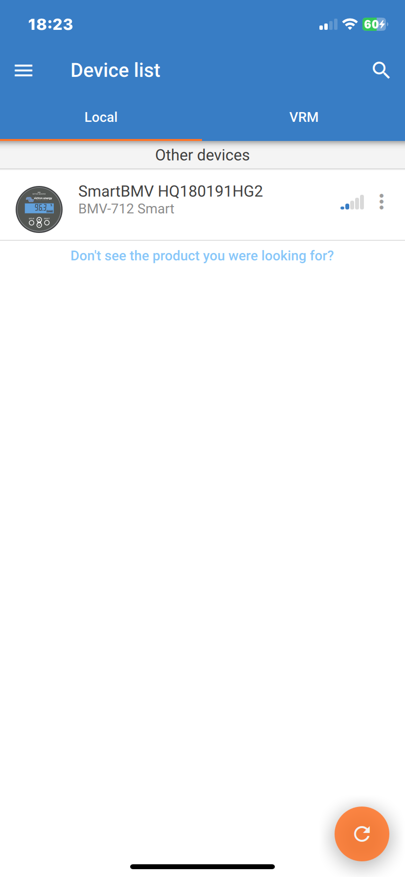

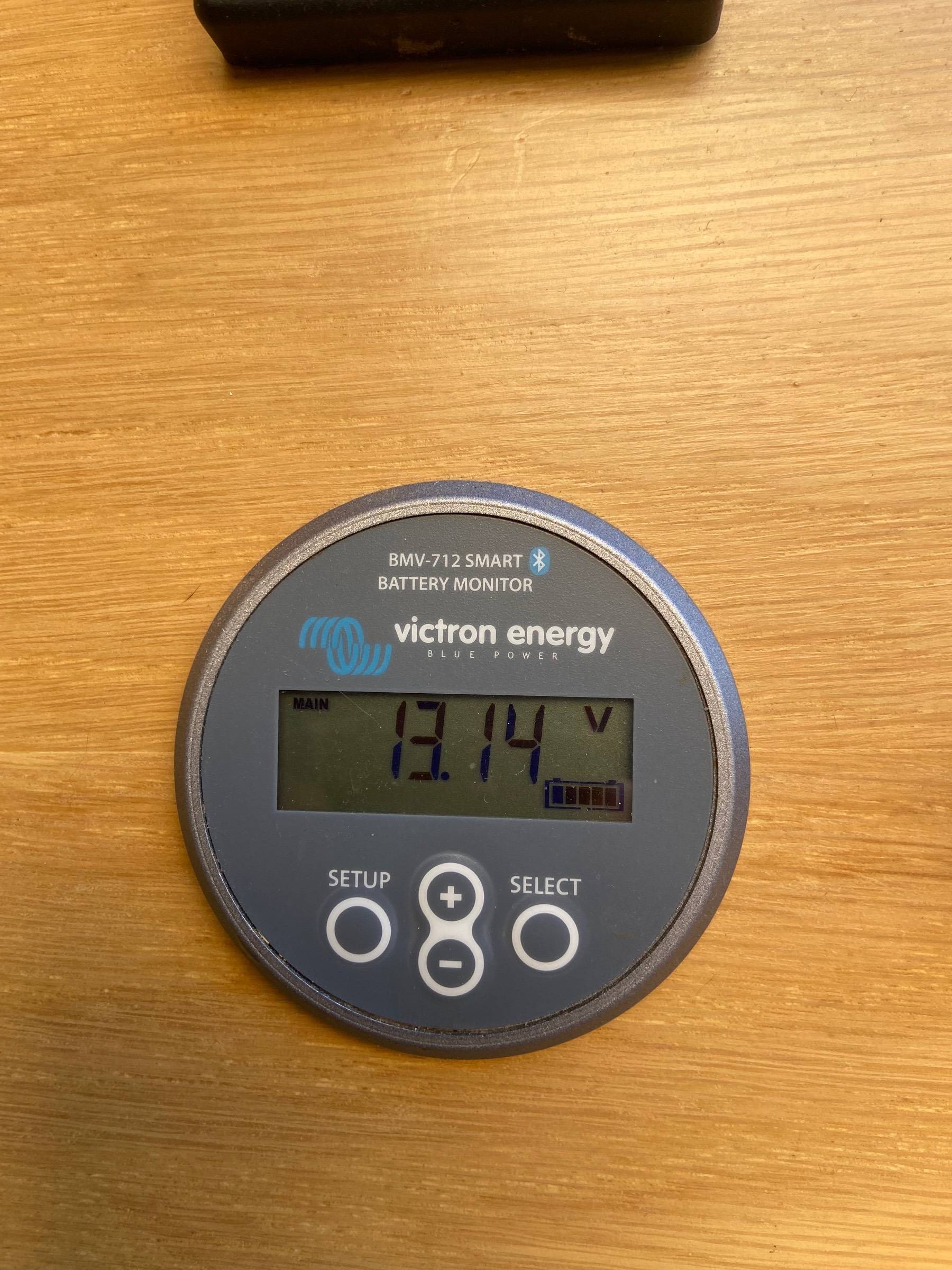

  5. Have the above but it will not connect to the VictronConnect app. The app can see it but will not give any info other than that. I’ve reset PUK, clear and reloaded app etc, no joy. I’ve also reset the controller to factory settings. Getting frustrated, any advice please. Has been working fine until a few days ago. Is there away of turning the monitor off and on?
