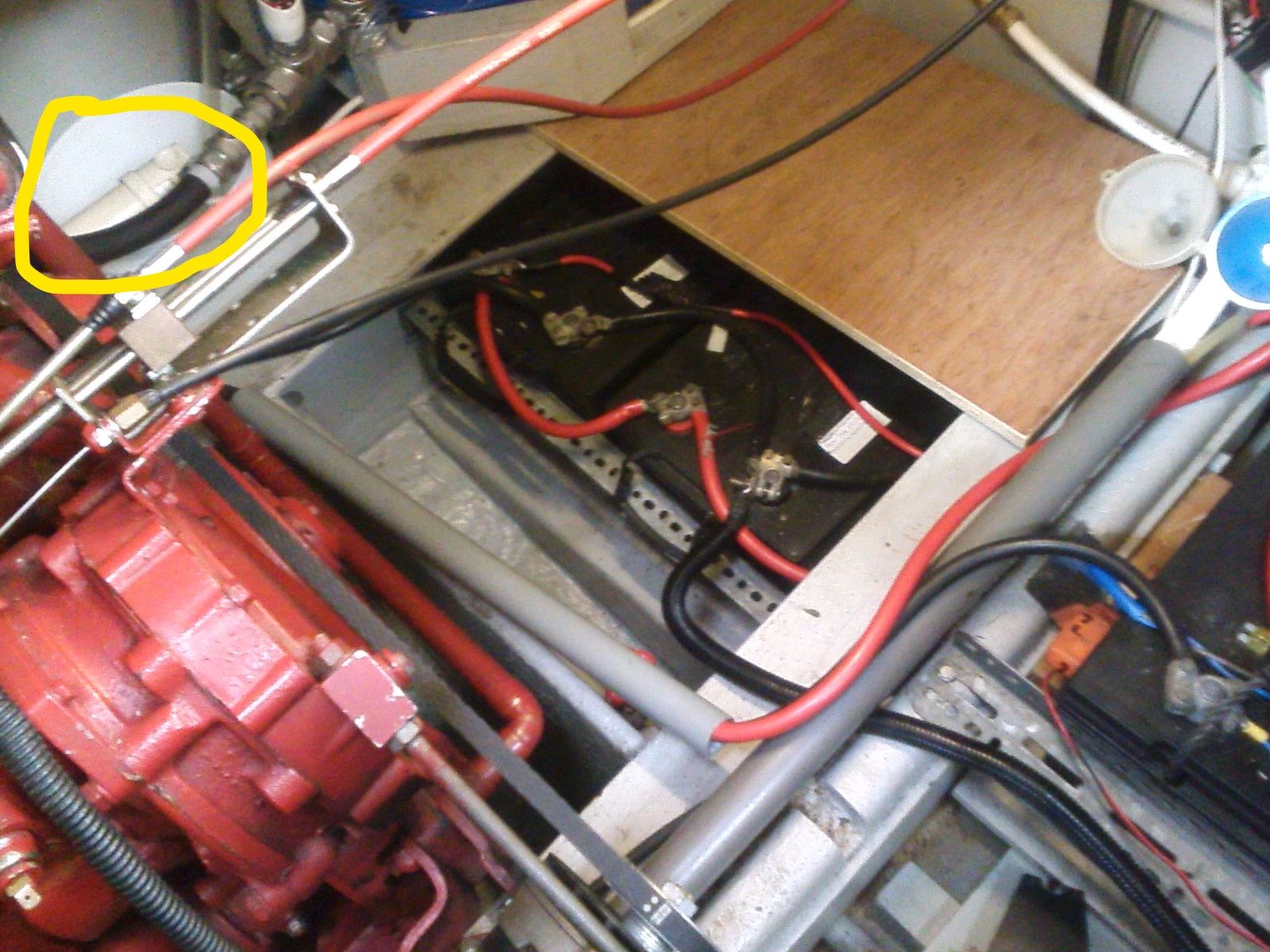

Alan de Enfield Posted December 28, 2020 Report Posted December 28, 2020 (edited) 18 minutes ago, BWM said: That's good to know, i have thought about installing one under the dry sump of my engine to make it easier to start in winter. Alan seems well researched so i suspected they might be! That is what majority of cars in Sweden have, and for exactly that reason. Temps of minus 20 to minus 40 tends to 'thicken the oil' and tighten up the engine. An extension lead plugged into an outside wall runs to an electric heater in the engine bay, and usually a small fan-heater in the passenger foot well as well. Mine (on the boat) run down the 'outboard' side of each engine and the fixing brackets screw into the engine bearers, so just a matter of inches from the engine(s) sump. Starboard side. Edited December 28, 2020 by Alan de Enfield

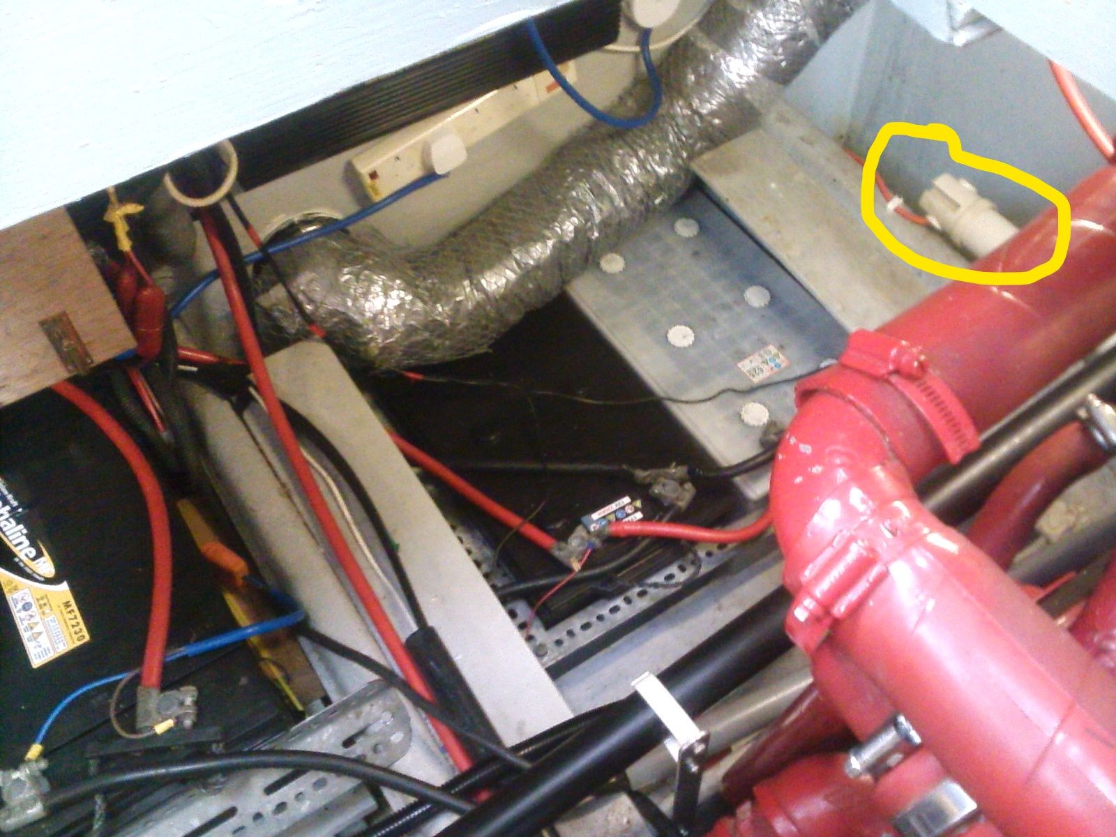

BWM Posted December 28, 2020 Report Posted December 28, 2020 2 hours ago, Alan de Enfield said: And Port side With a Jp3 on hand start i need all the help i can get once temperatures reach zero! 1
