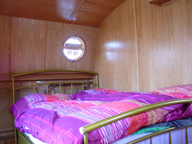

Get rid of the solid bed board and use wooden slats or even a steel grid. Anything that allows airflow to the underside of the mattress. Also get rid of any cupboard doors that block off airflow under the mattress.
I have a steel bed with a 2cm square section steel bars and steel mesh supporting the mattress and never get any damp issues. I don't have a picture of the mesh but this is the bed.
Edited by blackrose
In my experience, beds like that tend to rock....
