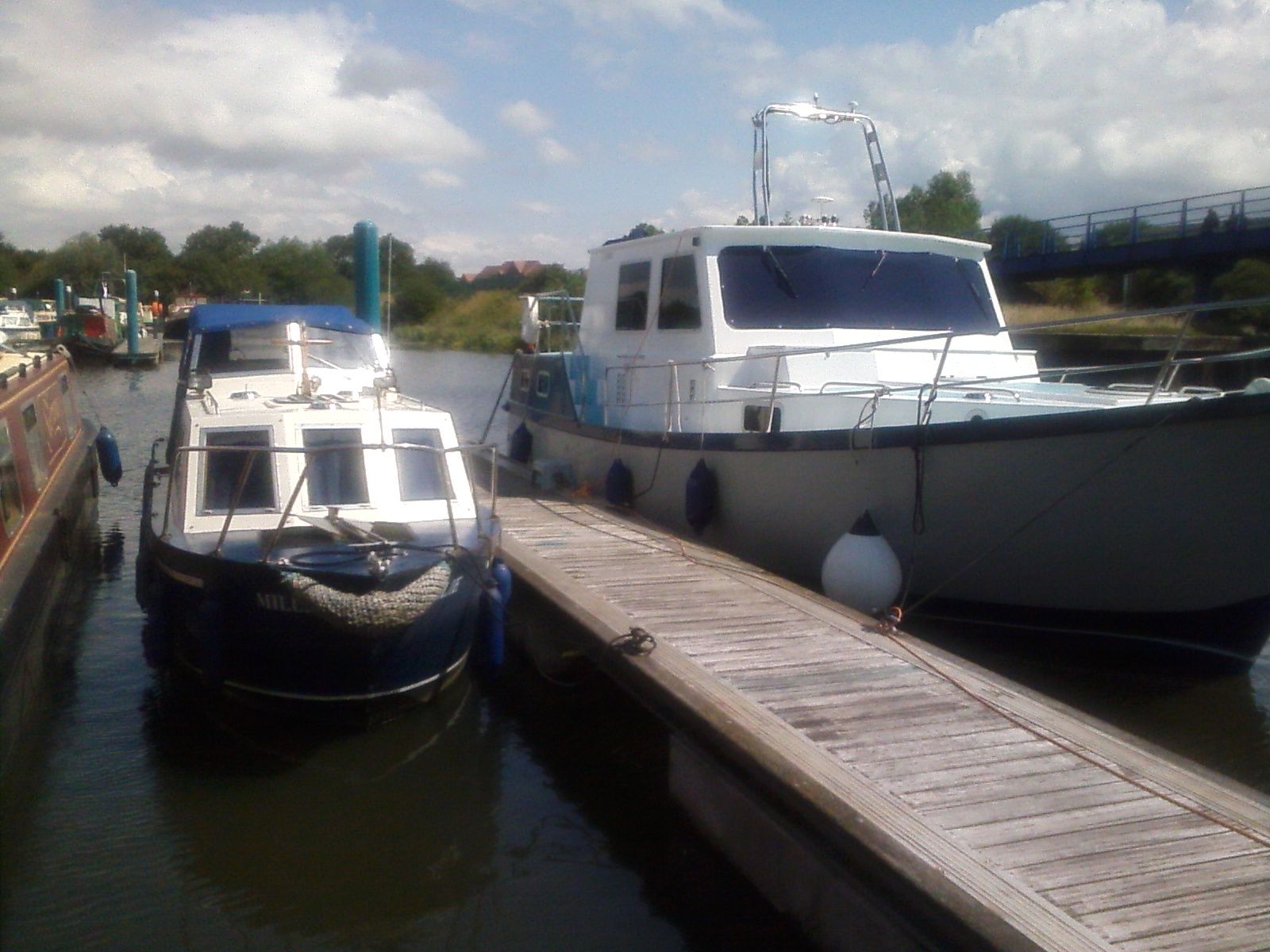

There are quite a few makes / models of GRP NB
Here is a 32 foot NB moored alongside my 35 foot WB
