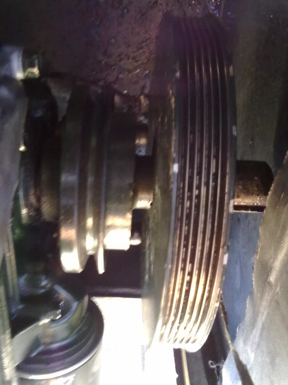

Only thing that was a serious problem...not just for myself but also a neighbour ...was the way the Beta engine was set up to power it.
My engine had a double pulley on the front...one before the other. My alternator and Travelpower alternator were on the same side and the subsequent force began to destroy the pulley and end of the crankshaft. At first it begins to work slightly loose on the taper, but once it gets underway it accelerates.
My neighbour had a 200 hour Beta engine and this happened. Once the pulley starts to wear a shoulder into the crankshaft you're doomed.
Beta eventually gave my neighbour a new engine and paid for fitting.
Its worth occasionally getting hold of the front end of the double pulley and waggling it. If you feel a slight movement, tighten the centre bolt.
An engineer told me that its fairly common and one of the root causes is that the crankshaft taper and pulley taper are slightly different. Whether that is true..I don't know ?
Unfortunately my engine wasn't under guarantee.  I did come up with a 'fix' but it involved new style of pulley and much machining.
When this happened, I was in constant communication with Adrian at Beta. He told me that this was a recurring problem, and that they had tried several fixes, even welding the pulley and nut to the crankshaft, but the forces always won. I 'think' that if you have this type of setup , with double pulley, It would be OK if you Beta.jpg.25e6434a81679fb894c953b49dc6d67d.jpg checked it for sideways movement. Get hold of it good and tight and wobble it. You can then catch it before it becomes serious.
By the way...you need to remove the pullies to tighten the centre bolt....
Edited by Bobbybass

Its a well known problem with the beta set up, however mine didnt suffer from it and was still faultless last time I talked to the owner. My present travel power is on my Isuzu and no such problems occur, a fantastic piece of kit.
It's not the Travel Power it's the original Beta engine. Mine finally sheared the front end of the cranshaft and fell into the engine sump.
Beta were very helpful - but I still had to pay something towards it.
Later engines use an Electolux double pulley that fits the splined PTO on the front of the shaft which is less prone to chatter.
The probem was caused by boats going to slowly.....
The problem is that the crankshaft was never designed by the engine maker to transmit the horsepower required on its front end and not modified properly by Beta to do so.
Beta knew this, which is why they replaced many engines . Not solving the problem at no cost to the owner is very bad, I doubt they could refuse to rework an engine if you made a forceful stand.
Edited by Tracy D'arth

Beta solved this on their later engine (from 2006 onwards IIRC) by no longer cutting off the splined crankshaft extension on the Kabota engine and using the splined crankshaft extension (rather than a Woodruff key) to drive the pulleys for the domestic alternstor and Travelpower.
Edited by cuthound
Phat phingers
I think this boat was launched in December 2008 and they have had numerous problems and still check it ever X number of hours .
This is where it all started with the boat less than 3 months old
https://derwent6.blogspot.com/2009/02/oh-no-friday-13thyou-bet.html
https://derwent6.blogspot.com/2010/10/misty-and-spooky-it-must-be-halloween.html
https://derwent6.blogspot.com/2017/12/beta-4350-bottom-pulley-loose.html
https://derwent6.blogspot.com/2017/12/running-at-last-to-30th-birthday.html
https://derwent6.blogspot.com/2018/02/an-anniversary-treat.html
https://derwent6.blogspot.com/2019/05/second-modification-to-our-beta.html
https://derwent6.blogspot.com/2019/06/onto-pangbourne-for-surprise-visit-and.html
https://derwent6.blogspot.com/2020/05/lockdown-and-crankshaft-check.html
