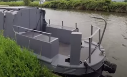

Also, I'm just curious as to what stern people think would be best, my boat will be a reverse layout. Here are the options:
  • Semi-Cruiser Stern - Image Bellow

Stern - now the semi cruiser stern is a variation introduced by Napton NBs years ago aqnd is great if you have lots of guests, but a waste of space of there are only 2 of you. It's better tah the 'original' semi trad. Best of all is full trad - but that's not on your list.

The hemi-demi-semi-cruiser has outside storage and seating which unlike a semi-trad can actually be sat on without kissing your own knees.  I quite like them if you want the external space, but mine has more cabin there (trad), as I like being warm when cruising in cold wet weather.
Second that (full traditional) - how often would you have loadsa' folk on board? even on a 60 footer (mine) you're still cramped for space - so why waste 6+ ft for the occasional crowd of guests AND it'll look like a hire boat (snob? me?).

Stern depends what you want it for. If you are going to live aboard and maybe have to cruise in wet weather, a trad stern is the best. Bigger cabin space after all that is what you pay for, not fresh air space.

Semi cruiser sterns make for a very sociable boat if that is what you want, but equally it's very cold and exposed stood out there in the winter.
My personal pref. is for a semi trad. which offers sociable space and a bit of shelter in winter.

As others have said, the stern depends on your use of the boat, the number of people normally on it  and aesthetics.
If there are only 2 or 3 of you, then a trad with an oversize hatch works well,  with a couple of high backed bar stools for those who wish to sit.
A trad stern means a dry engine hole, virtually imposdible with cruiser, semi-cruiser and semi-trad sterns.

Stern to your choice but I like cruiser sterns. Don't feel safe on trads and soemtimes access to the cabin can be interesting for taller people on a trad.

The hemi-demi-semi-cruiser...
... looks like a hire boat ;)
